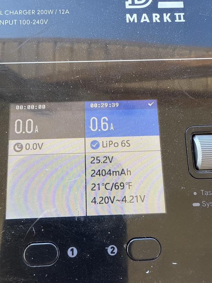

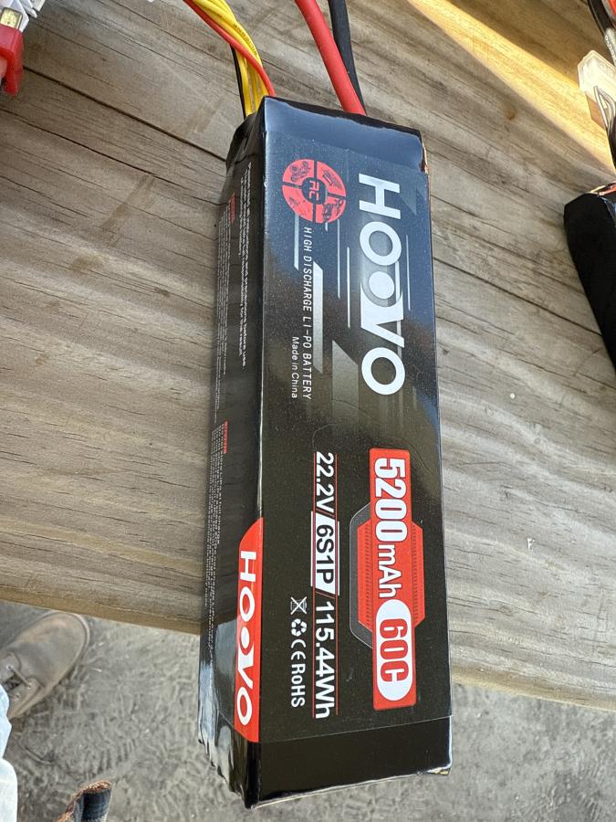

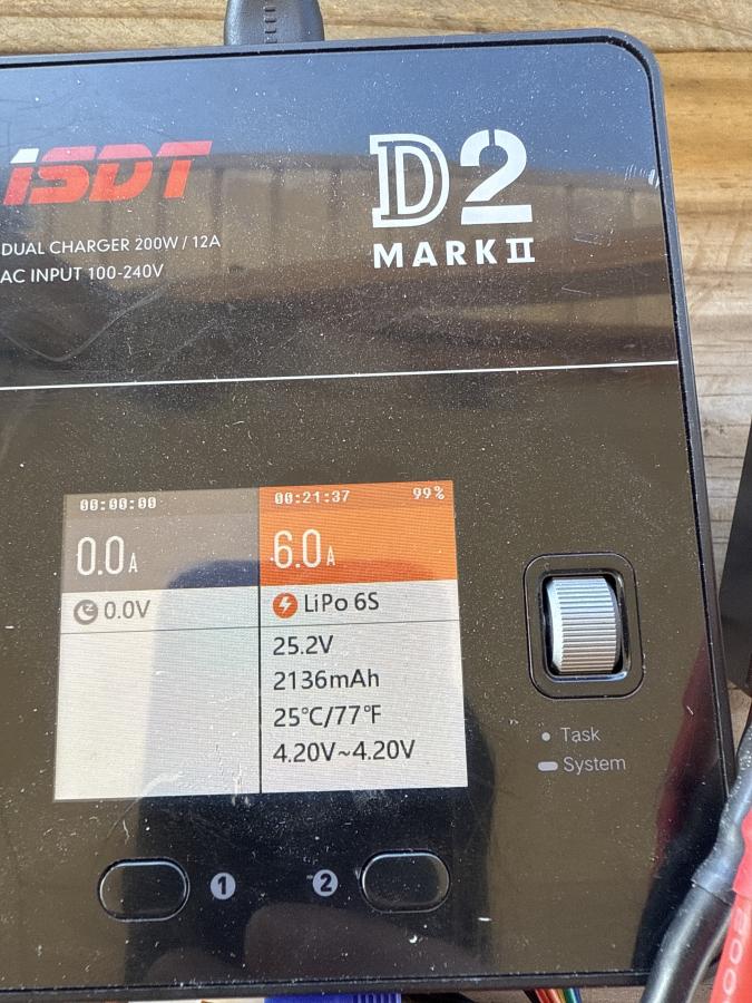

    Ok went flying yesterday my buddy has just gone 8s on his 90 Raptor. He ran 2 4s packs 100c 4400 Zee packs and then a 6s 5200 80c and a 2s 5200 60c Hoova packs. The twin 4s perfect no issues but the 6-2s setup he told me 2-3 min came down at 9% but when charged the packs only took about half of the mah. So he flew correct 9% I put his 6s pack on my charger we charged and correct it only took a little over 2400mah to be at full capacity. I’m including pics hoping someone can explain how a 5200 pack down even after sag only takes 2400mah to get 100%. Thanks for the help on this guys

      What 2S 5200?
