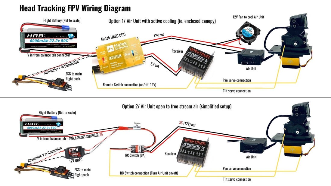

    The electronic gear Im using is in the pic below and I chose option 2/ Air Unit open to free air. I did also get the Matek Ubec and fan in option 1 just in case I want to put the canopy back on, but I thought I would try and keep this as simple as possible to start with. In the TX I set switch F to use AUX 4, but doesn’t work obviously because Im a retard and cant figure out why. Any help would be greatly appreciated.
    AUX4 is channel 9. Your AR8000 doesn't have 9 channels.
    Also the AR8000 is an old and discontinued receiver which has been counterfeited, so if you bought it recently it is probably a fake.
    You'd be better off with an AR10100T or AR10360T, both of which have 10 channels and telemetry, and are in production.

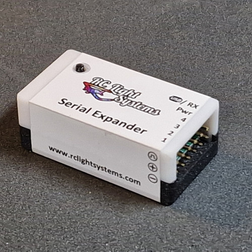

        You can also get a channel expander for the AR637T from https://www.rclightsystems.com/produ...erial-expander

                Why not just add a channel expander to the 637T you already have?
                Features 4 output channels 4.8 – 8.4V Multi-protocol Auto channel detection Additional power connector
