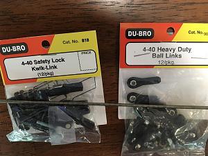

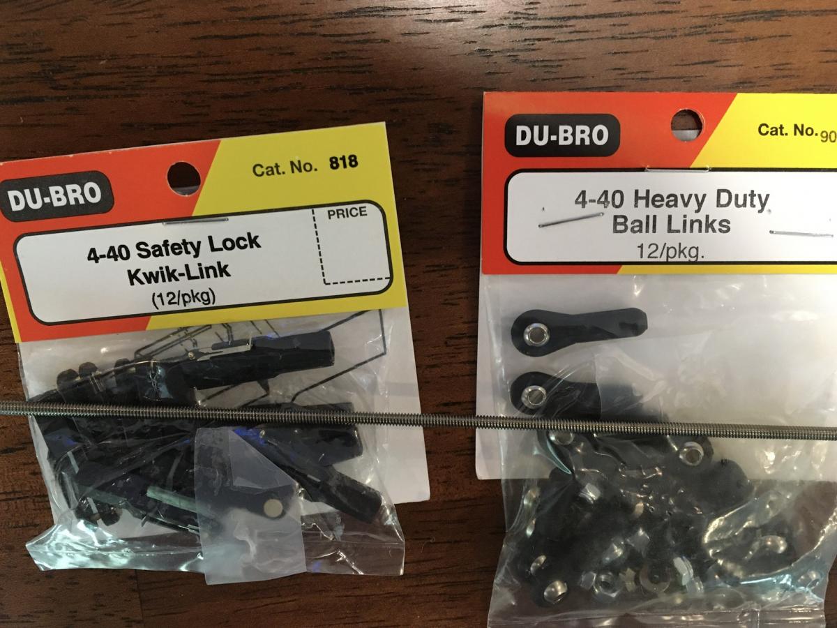

                Try reversing the throttle channel on the transmitter. That should solve the problem. This was what MRC help chat told me, and it worked!
                Then If that works...calibrate your ESC, for sure.
                Also, consider beefing up the elevator push rod and also search this forum on the word “ferrite” and read those posts. Make sure the elevator servo is secure!!!!
                I lost #1 bird twice (First Crash was repairable) due to these things. Bird # 2 is good!
