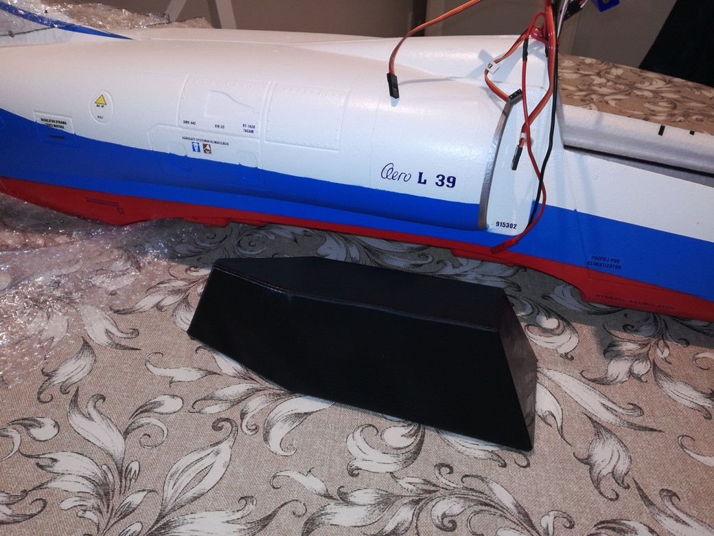

    The interesting bit around the tank I built is making the most of that space under the turtledeck where we usually just have a wire spaghetti, this way not only does it leave the whole front battery bay to mount the equipment you need but you have a neat tank taking no space and best of all it sits over the CG so there is also no shift in the CG as you burn the kerosene. It also provides more flying time than electric.

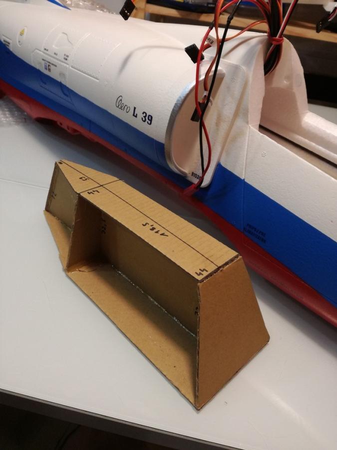

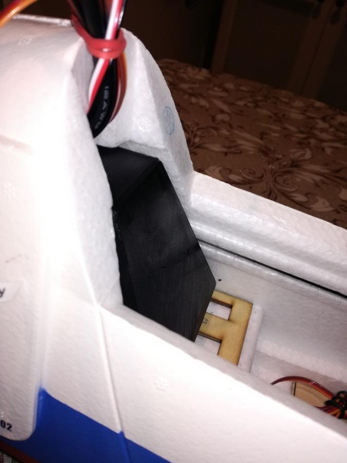

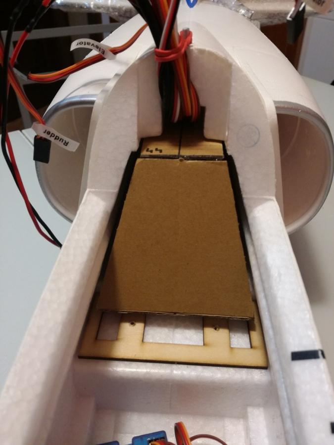

    To start I took some measurements and built an aproximate cardboard dummy tank, then designed the actual tank shape in a 3D software and had a friend of mine 3D print it to check it actually fits. When I saw it had a nice fit I designed the molds, then the worst bit, a time-consuming, long and boring fiberglassing part. Eventually both halves are fit together. Below are some pics of the L-39 tank. Dan got the prototype but have since perfected the built :).

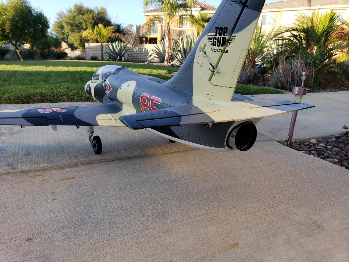

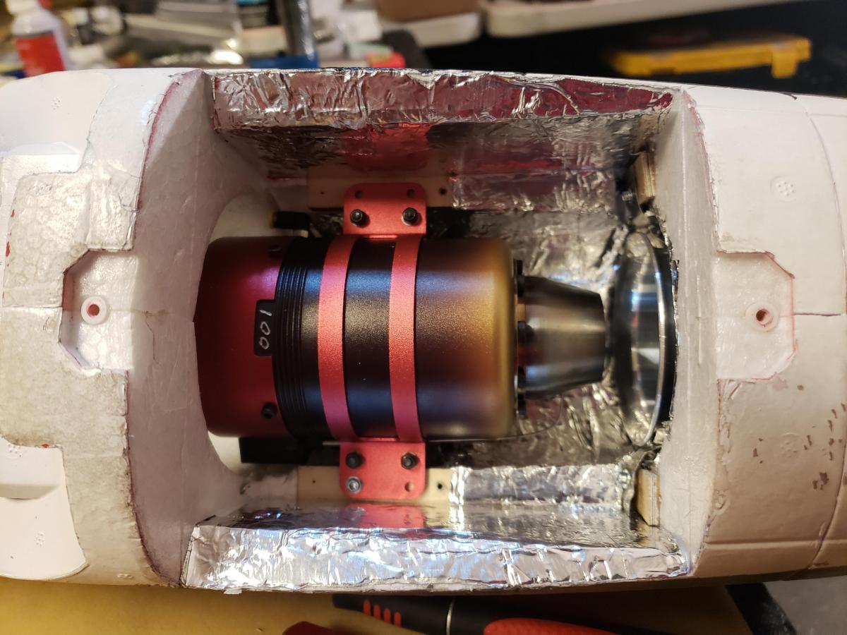

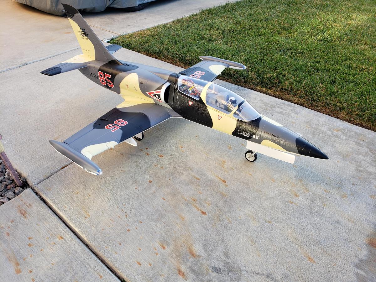

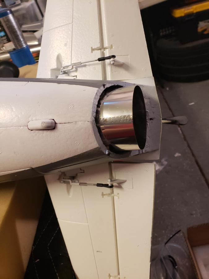

    Oh and I hope yf22raptor does not mind me showing the pics of his conversion, it just looks stunning and he was actually the inspiration that started me wanting to do the conversion too!
