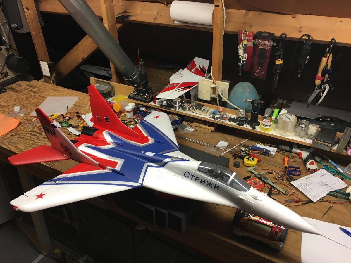

    Just thought I'd share some pics of my new Arrows Mig-29 in a DIY Ukrainian Scheme.. Was not a fan of the original..
    Got the 3D printed nozzles fitted so she performs well.. Just seems to land fast with some wing waggles. I'm only 4 flights in so I'll work it out..
