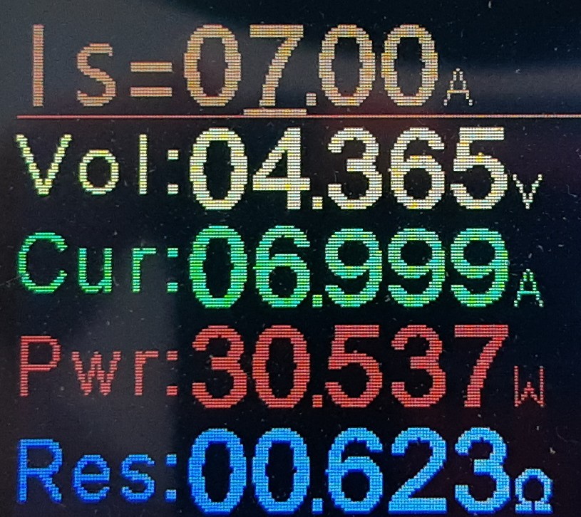

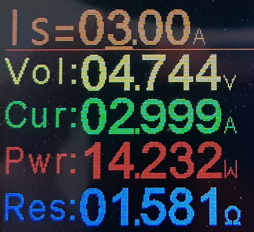

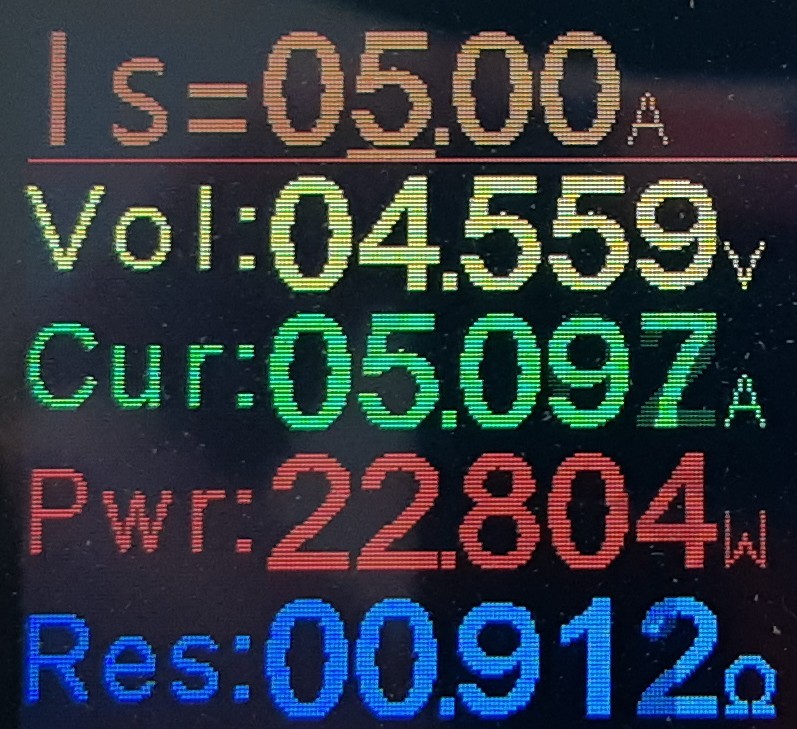

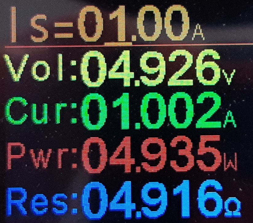

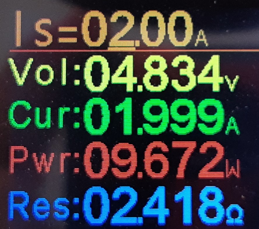

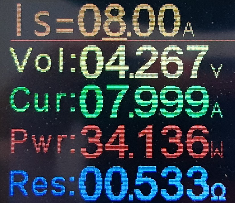

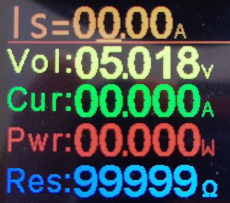

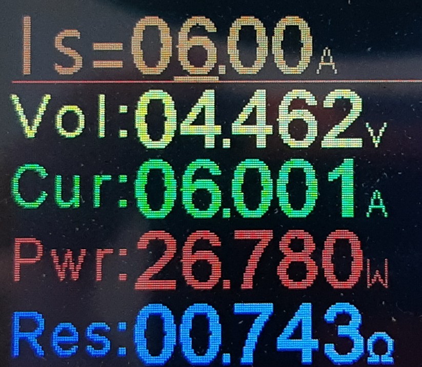

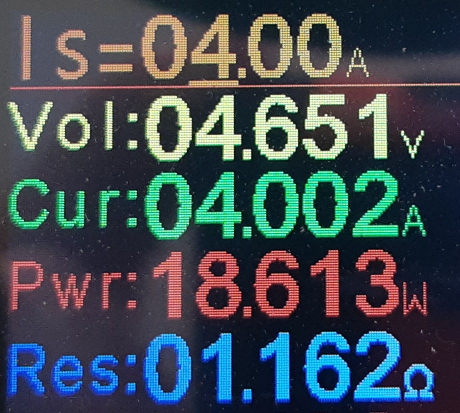

    I did some measurements today and I'm already a bit scared about the results: 4.2V at 8A load. Alpha could you please have a look at this:
    Click image for larger version  Name:	 Views:	0 Size:	211.4 KB ID:	272830
    Click image for larger version  Name:	 Views:	0 Size:	190.5 KB ID:	272831
    Click image for larger version  Name:	 Views:	0 Size:	195.9 KB ID:	272832
    Click image for larger version  Name:	 Views:	0 Size:	190.4 KB ID:	272833
    Click image for larger version  Name:	 Views:	0 Size:	246.0 KB ID:	272834
    Click image for larger version  Name:	 Views:	0 Size:	179.9 KB ID:	272835
    Click image for larger version  Name:	 Views:	0 Size:	190.2 KB ID:	272836
    Click image for larger version  Name:	 Views:	0 Size:	197.6 KB ID:	272837
    Click image for larger version  Name:	 Views:	0 Size:	189.4 KB ID:	272838
