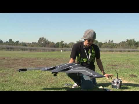

    Have you looked at Pete's video. Freeze it at various points and you'll see how those rudders should work, especially around 3:48. It doesn't look like they work the way your pictures indicate.
