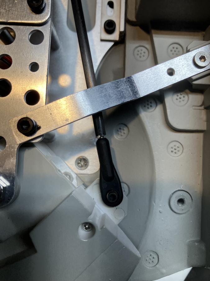

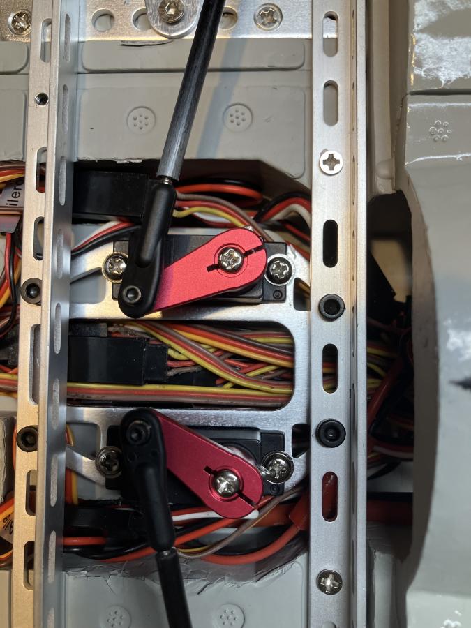

    Found a great video showing a modification you can do to the wing sweep ball links/control rod to improve it tremendously:
    According to his video there have been others that have experienced ball links popping off the wing sweep servos and resulting in a crash. This is something I will be doing to my next one for sure.

                                        Heard of the same issues with the wing sweep stock ball links. This was my solution. Du-Bro ball links with 2-56 treaded rods with carbon fiber tubes over the treaded rods to keep from flexing.
