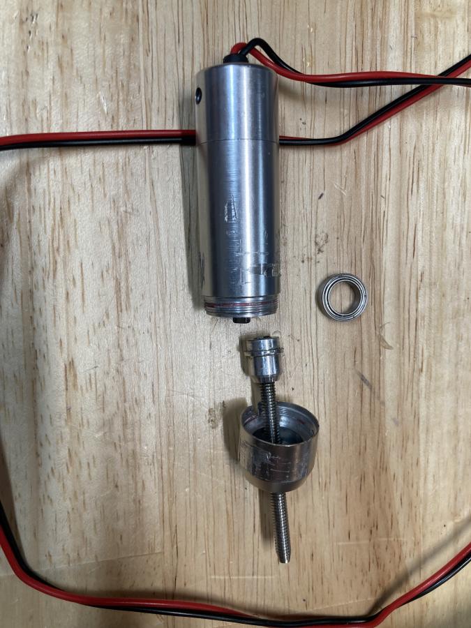

  • Jeff C
    I believe the manufacturer need to fix this problem and provide the replacement retract motor assemblies to the current buyers. Also, for future buyers. Caution for the few that are already flying. The retracts may work now, but could fail and landing gears would not come down in your last flight.
  • Jeff C
    Resume MiG-29 this week after long delay. Found retract motor assemblies have fundamental design problems. Two out of three had failed. The motor would keep spinning and not able to drive the threaded shaft. Click image for larger version  Name:	1391D847-DAD2-4AF4-9C84-DDF925BB556A.jpg Views:	0 Size:	105.3 KB ID:	409048 Click image for larger version  Name:	560EB5C1-17EA-43B1-B319-6201E58D25EF.jpg Views:	0 Size:	88.1 KB ID:	409049 Click image for larger version  Name:	E7FCDD25-6B94-4654-A4E9-50A25CCB56B9.jpg Views:	0 Size:	96.8 KB ID:	409050
