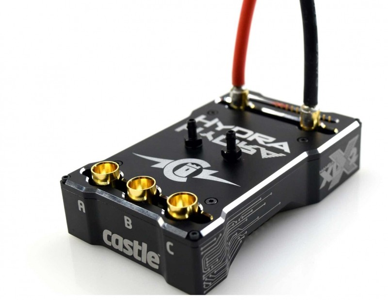

    Phil Thomas SS45
    Motor: castle 1717
    Battery 6s lipo
    Inverter: Hydra Ice HV 200 v2
    prop: Octura X452
    Hardware: Speedmaster

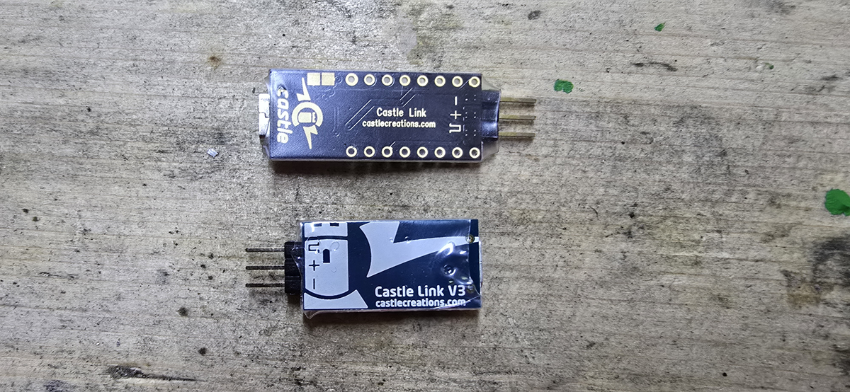

  • Clugh
    BTW you got a coupon or QR code to get you free castle link connector.. Check your packaging or your box it came in.
