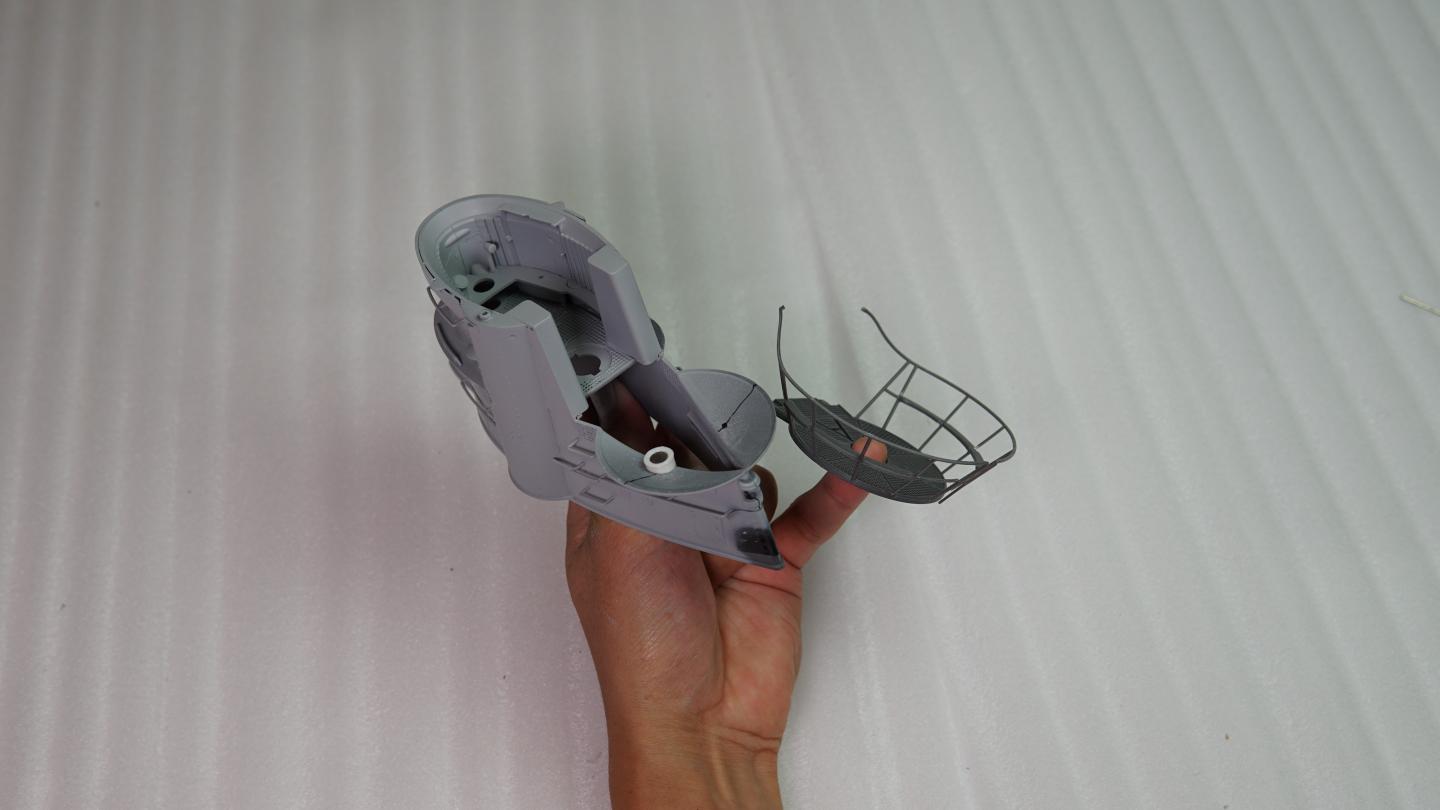

    In preparation for an functional RC Sub, I made the entire conning tower magnetically detachable, and did the same for the conning tower's gun deck. This aligns with the position of the WTC's solenoid which turns on the watertight system on the inside from the outside. A quick coat of primer and I'm happy how the surface treatment turned out. In real life, it's less contrasty than these photos imply (due to the studio lighting exaggerating the shadows). The deck also comes in three parts to coincide with the three sections.

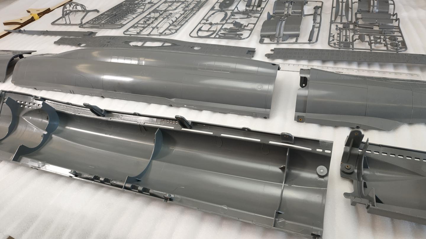

    The ABS parts are stronger than plastic, and ideally suited for what will become a functional RC submarine. Aside from the internal WTC and hardware, the model itself builds like any other plastic kit, it's just much bigger. Measuring about 55" long, it's the longest plastic KIT I've ever assembled.
    The forward, center, and aft section halves are not on sprues, but everything else is. There was lots of flash on some of the hull parts, which isn't surprising given how large they are. Also included are some brass photo-etched (PE) parts, waterslide decals, rigging string, various metal fixtures and fittings, and a plywood stand.

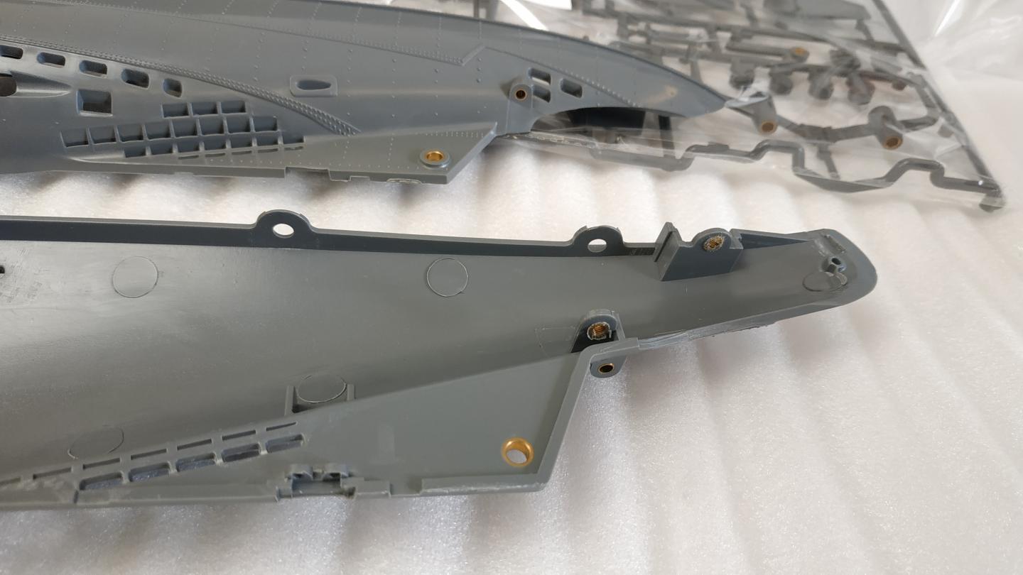

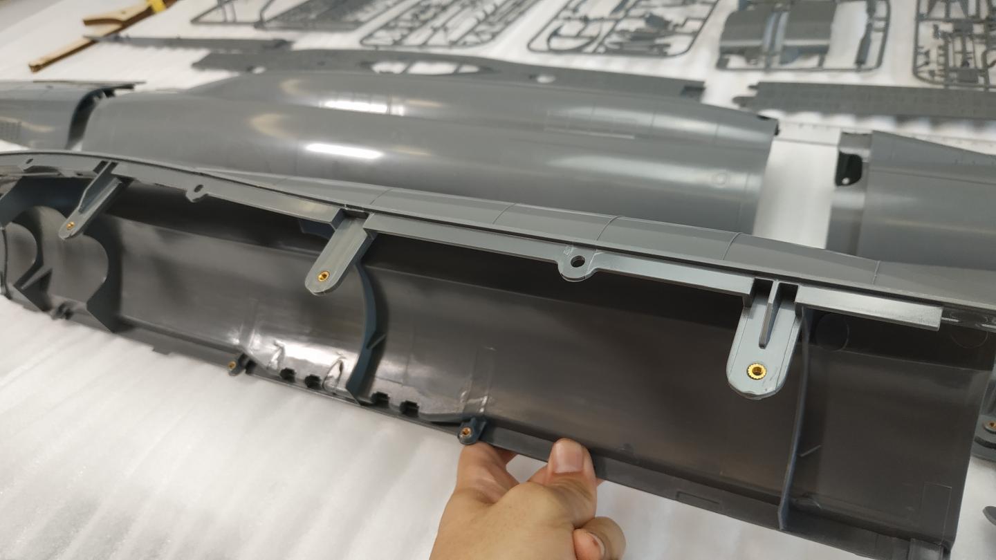

    As mentioned previously, this model is intended to be RC'd, so rather than simply gluing the large sections together, they are designed to screw together. Having converted static plastic models to RC before, I can't emphasize enough how much I appreciated seeing these brass threaded fittings molded into the ABS! I screwed everything together for a "test fit" in a couple of minutes. Brass bushings are also molded in for the steel rods that are molded into the rudders and dive planes. This saves me lots of work. If I had a WTC ready to install and wasn't worried about scale greeblies and paint, I can see this model being rushed into its first Sea Trial after one long evening or two of work.
