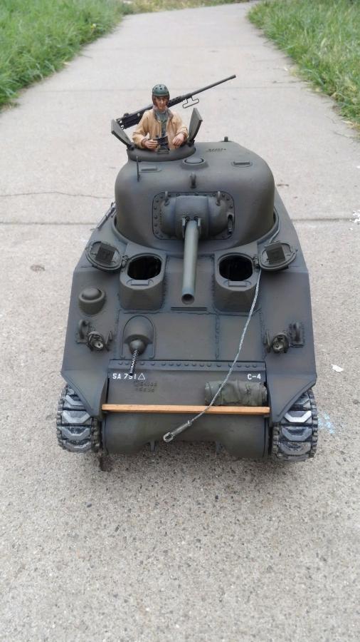

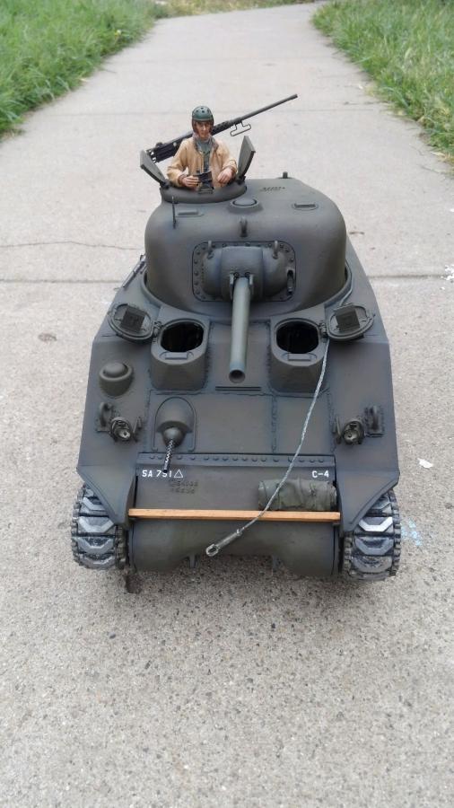

                          Use some bondo and reshape the driver compartment hoods, They are totally wrong. Good photos on Sherman minutia
                          also, you need to move your engine deck backwards and then cut the back of the hull off vertically and make a new rear to shorten it up, The A3 which HL modeled was much longer than M4 hulls with the radial engine.

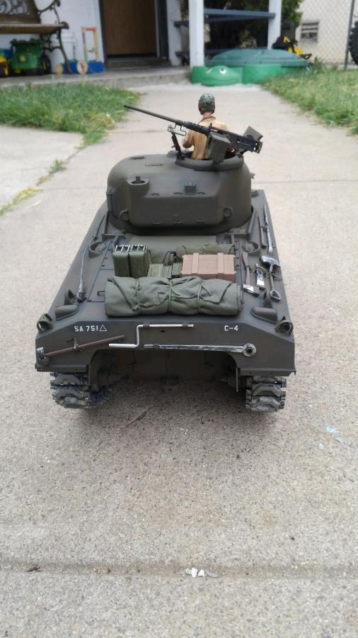

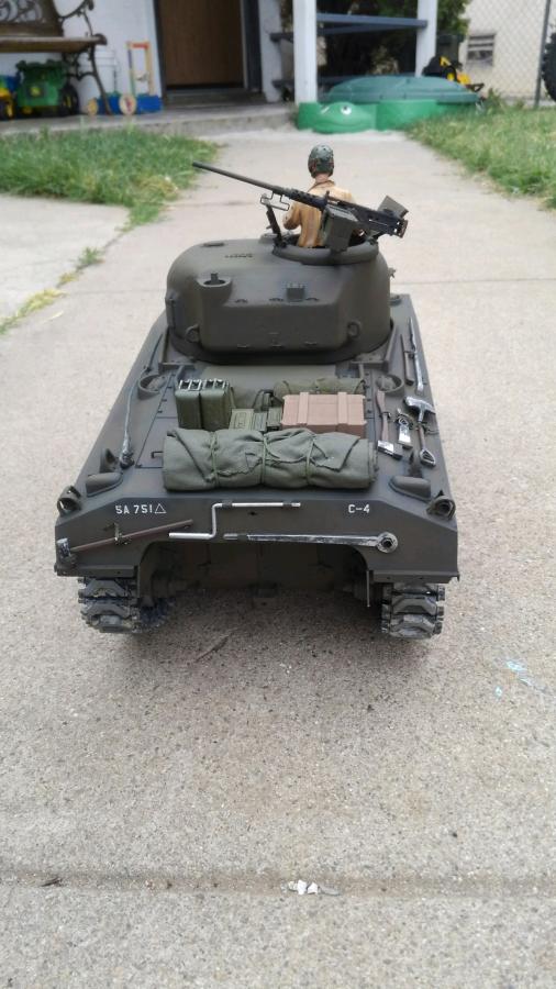

                            Here are some large shots of my Alco Locomotive Works M4 circa March 1943 production as is from the factory.
                            I have an enormous amount of hours in just doing the photo research to get this model built and detailed correctly. I’m notating you need to be as accurate as me, that’s what I like, but I’m showing you for reference to hull length regarding the back deck and the unique shape of the driver hoods, which are considered the narrow hoods on the m4s. Woz hoods are not accurate which is why the ones I got are still in the parts bin. But you can use bondo and shape them properly.
                            also, while the front of an ear,y m4 was pretty standard save some minor details between the various manufacturers, the rear would be either sloped (like my Alco) or vertical, like on a Baldwin m4.

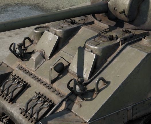

                              Click image for larger version  Name:	BGtPKSz.jpg Views:	0 Size:	124.2 KB ID:	319727
                              This is one of (the many) screenshots from WT I am using as a reference as well. You can see the small hatch hoods indeed need rounding. Not planning to please every Sherman specialist with my build, mainly myself.
                              Click image for larger version  Name:	IC_WT.jpg Views:	0 Size:	61.4 KB ID:	319726

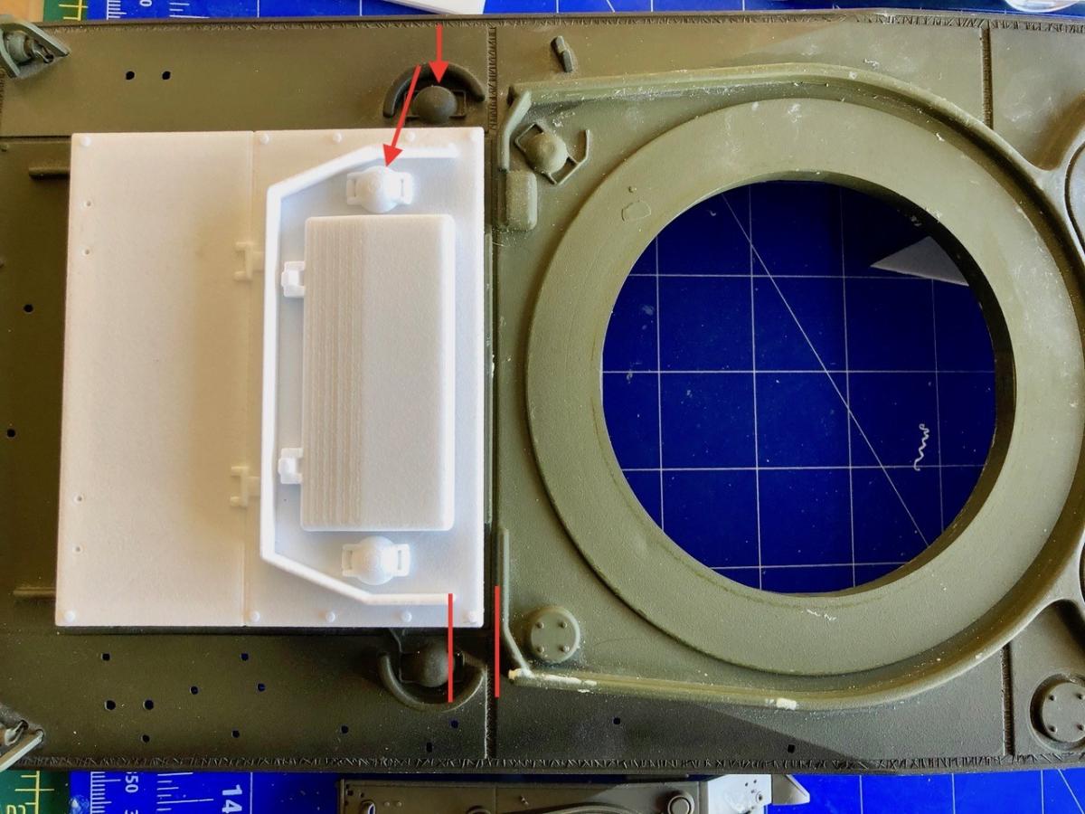

                                Regarding the red arrows pointing out the filler hatches, from one mfr to another you will find some dimensional variance when basing different parts together for a model.

                                          The HL Sherman is wildly accurate for what it is at 20 yards away; a "toy" Sherman M4A3 with a 105mm houwitser. Now if you get some people started about it they will point out ALL the flaws it has. And don't get them started on the difference between the HL and an actual Firefly.
                                          Personally I am building this
                                          • as a Sherman IC
                                          • based on the 1/48 Tamiya kit, several drawings I found and screenshots from a Sherman IC I play on War Thunder
                                          • for my own satisfaction and enjoyment.
                                          Pretty much how I have always built my models. Static and otherwise. I want to approach the end goal with as much fun, skills and information as possible. When anything of those last two gets in the way of the first, they get adjusted.
                                          So yeah, get it "right" for my own satisfaction. I've dealt with enough rivet counters in the static model competition scene to be totally cured of them. So if any rivet counter wants to creep up on the rear of my Firefly with a tape-measure to check my work, they are going to get a BB to the face (if I get my 360 conversion done...)
