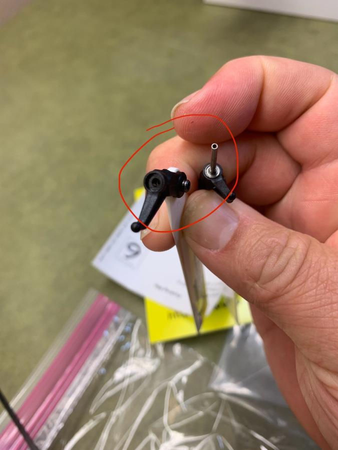

                                        So HPCR I got it going again only to blow the rotors off after being stuck in the grass. I believe I am missing a small washer?Click image for larger version
                                        • #40
                                          Possibly.. so... download a picture of the part list ( alibaba.com or similar sources) and see what you are missing. I am going to give you some free advise. Unless you have never flown these 6 channel helis, you are going to need SPARES! The best way to get some spares is to buy a COMPLETE XK-110S for about 65 dollars and keep the heli you have for spares, you can disassemble it and see how it all has to be put together. You will need that skill and experience. BWY There are lots of video's on this BUT nothing is as good as hands-on practice.
