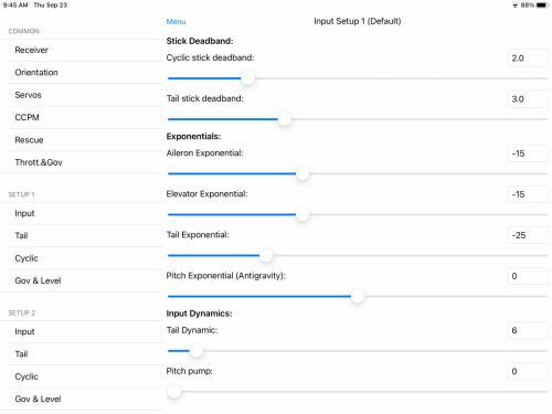

          Another thought…is your transmitter well used? Those stick potentiometers do shift over time and Ikons seem very sensitive to the Tx neutral stick positions. Might try going to the “advanced” menu, then under “setup” look for “tail stick deadband”. I think the default setting is 3. Try increasing that a little. Click image for larger version

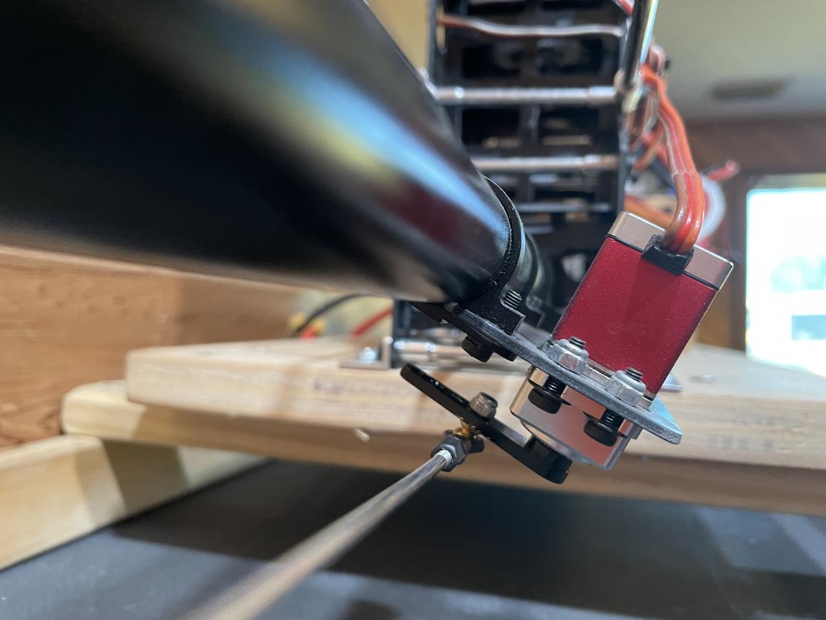

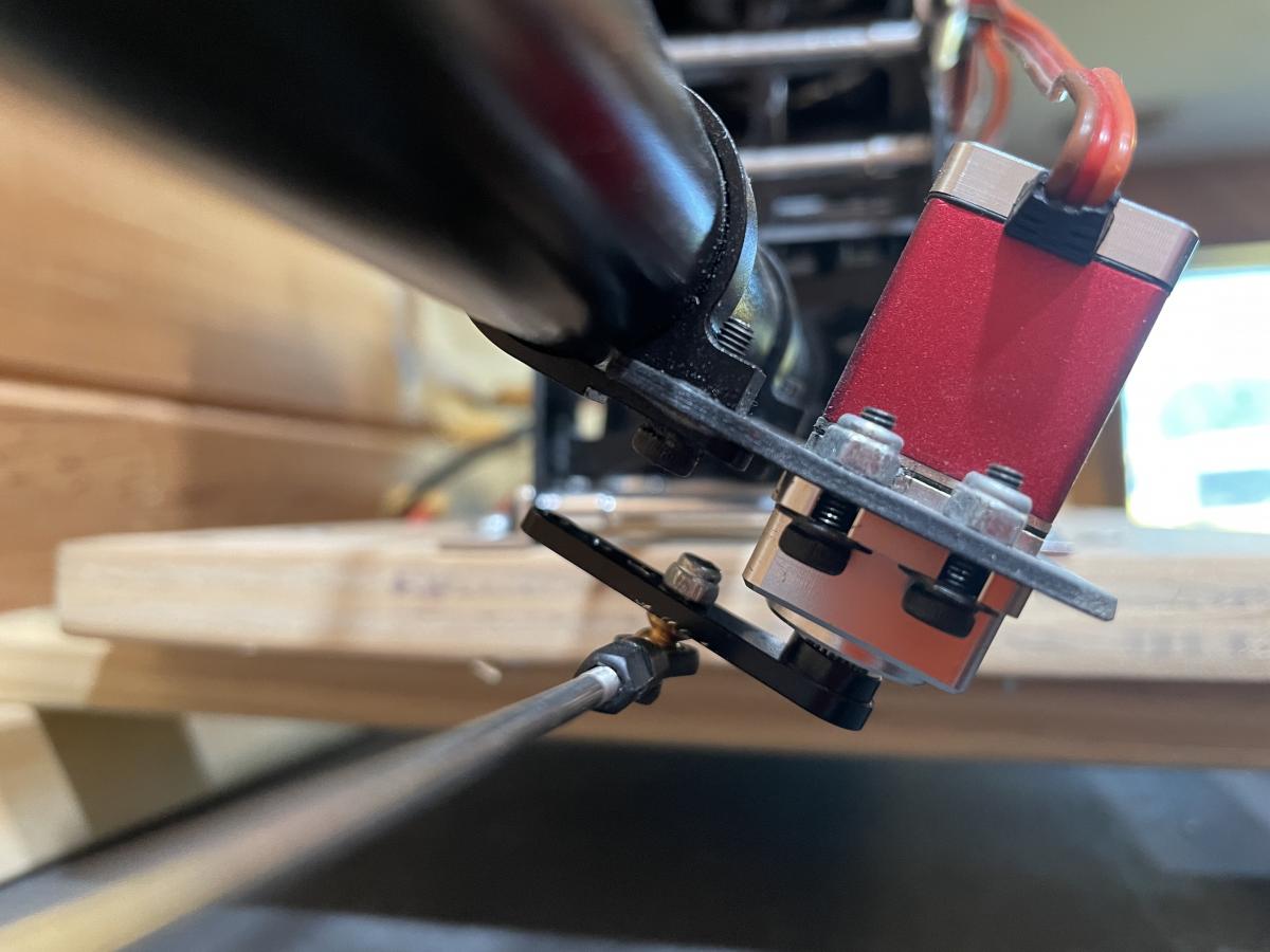

ID:	325372 Hi guys. Thank you for the responses. The gears do you still have grease on them although I could probably add some. I will add a little bit to them. But I don’t think that this is causing my issue. I am using the iKon 2 Bluetooth. I don’t think there is a transmitter issue, as far as the dead band goes, because I have the exact same ikon unit in a goblin 570 and it flies beautifully. Tail is rocksolid. So I took some time today and went through my tail set up again making sure everything was correct. And I moved the servo connector in one hole. Although to do this I had to flip the ball around to the other side of the servo horn which causes the guide wire to flex down a bit. But everything seems to still be very smooth from the servo to the tail rotor as far as the control goes. I have not flown it yet after moving the horn in but I should be able to do this tomorrow.

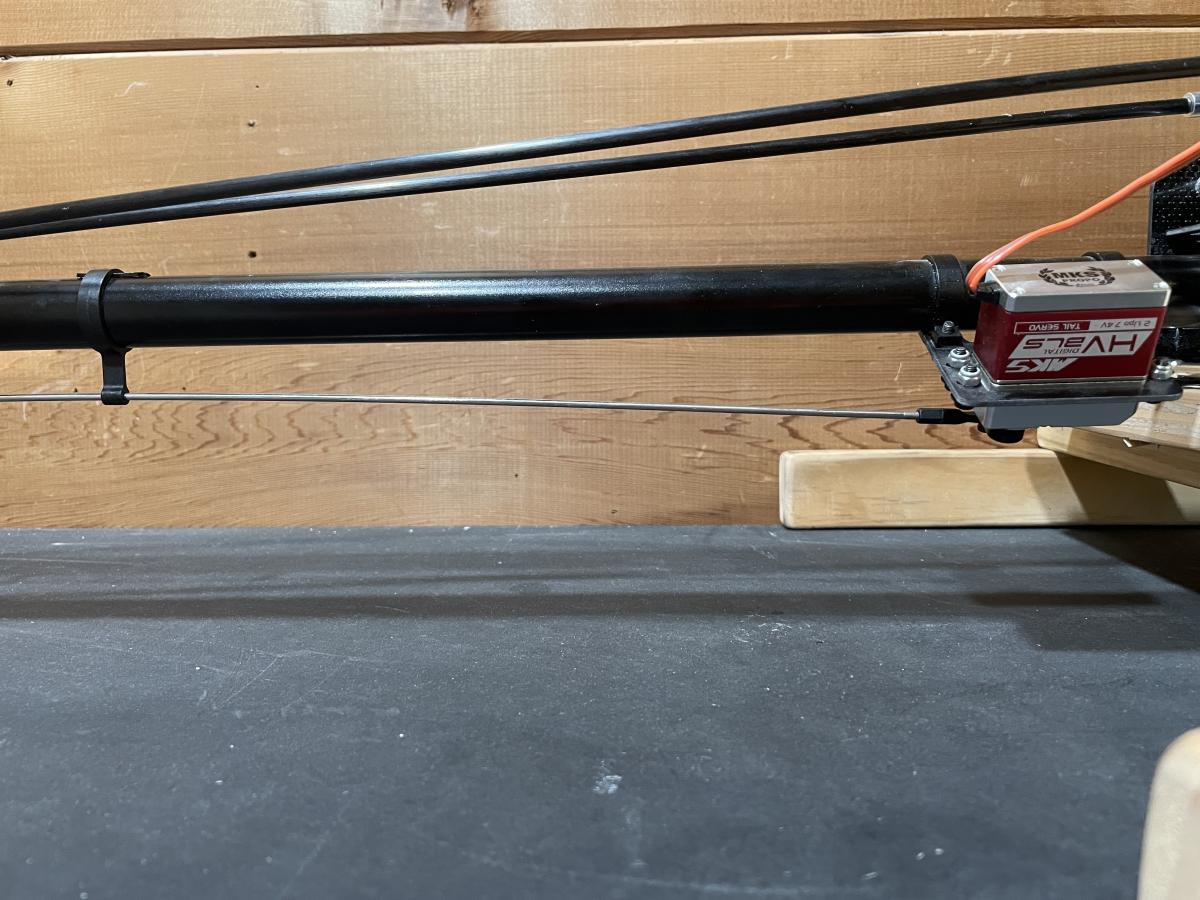

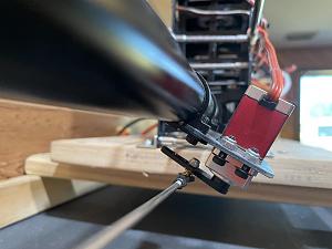

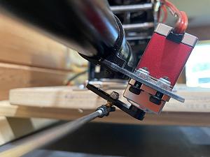

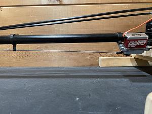

                I am also just wondering about the physical placement of the tell servo. And the angle that I have it mounted at. The instructions don’t give you any help concerning this. Wondering if any of you guys have photos of your set up.

                          Question for you guys. I bought the two ikon units that I am using used. They did not come with the mounting tape. So I used some mounting tape that I had which is very firm. I used this tape in my goblin 570 and as I said it seems to fly beautifully. Tail is rocksolid. I used the same tape on the Apache. But could it be that a little thicker tape might help keep out any vibrations that might be passing through to the tail?
                          I personally don’t think this has anything to do with it. But I guess I am just grasping at straws. I’m about to purchase another fabulous unit just to see if I have a bad one.

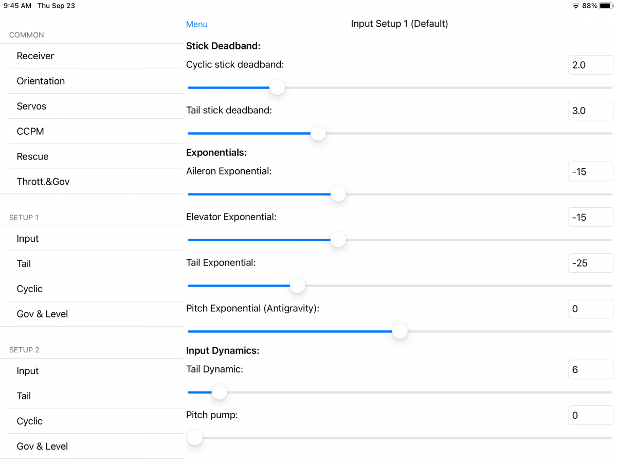

                            Will post yet again please look at these settings

                              Hi bird man. Thank you for your post. I don’t recall seeing that before. I may have missed it. I will take a look at this as soon as I can.
