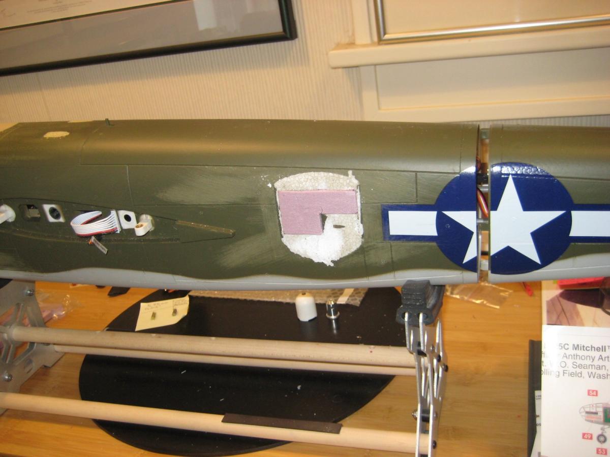

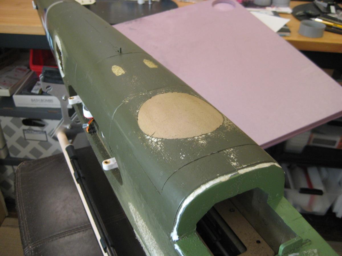

        Hey All,
        Nothing major just a pic showing my use of 'pink' insulation foam to fill the "J" model turret hole.
        I like this as a basic fill material and have used it on almost every foamie I've built.
        It is easy to shape, sands similarly to balsa, and is structurally sound.
        One caveat, it does not like solvents or standard CA glues, but is unaffected by IPA and urethane glues.
        I will use it to block out the window openings as well.
        More when there is more.
        Best, Steve

          Originally posted by Elbee
          Hey All,
          More when thee is more.
          Best, Steve
ID:	412966 Click image for larger version
          I like the pink foam, too. Good choice to fill those holes from the turret and windows.
          Cheers
          davegee

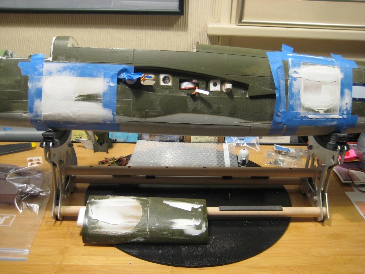

            • 4870
            Round 2 of filler. Best, LB

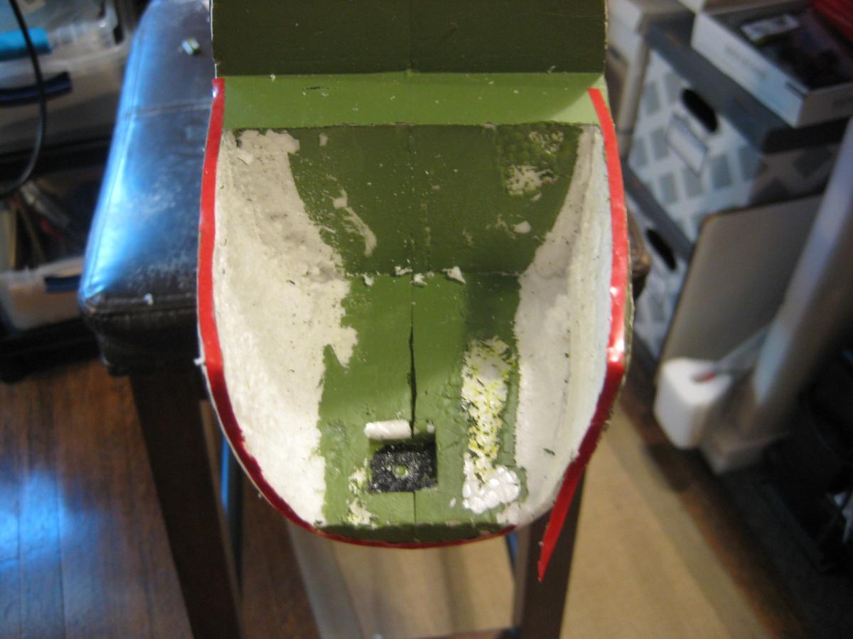

              • 4870

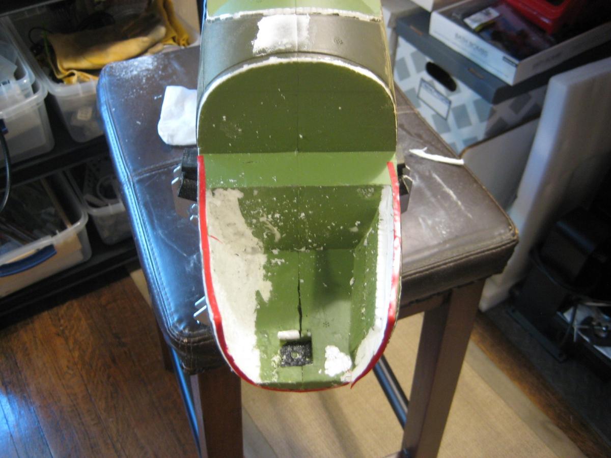

              Hey all,
              I am going to add some detail to the bombardier station just because it is so visible.
              The area is not structural, though I will beef up the nose gear retract mount to make up for removing foam structure to be safe.
              No cockpit makeover, though I thought to add some details.
              The cockpit is also part of the battery compartment, so can't go too crazy.
              More when there is more...:pop
              Best, Steve

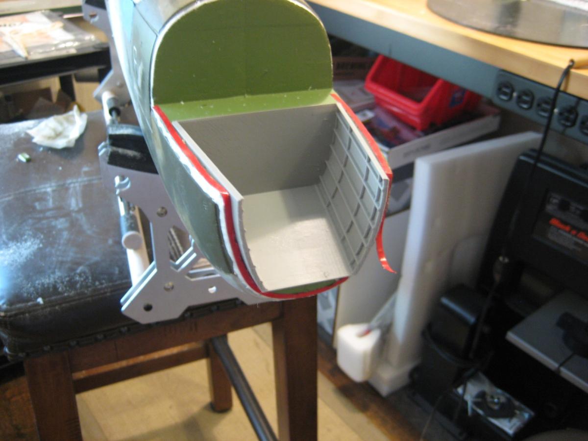

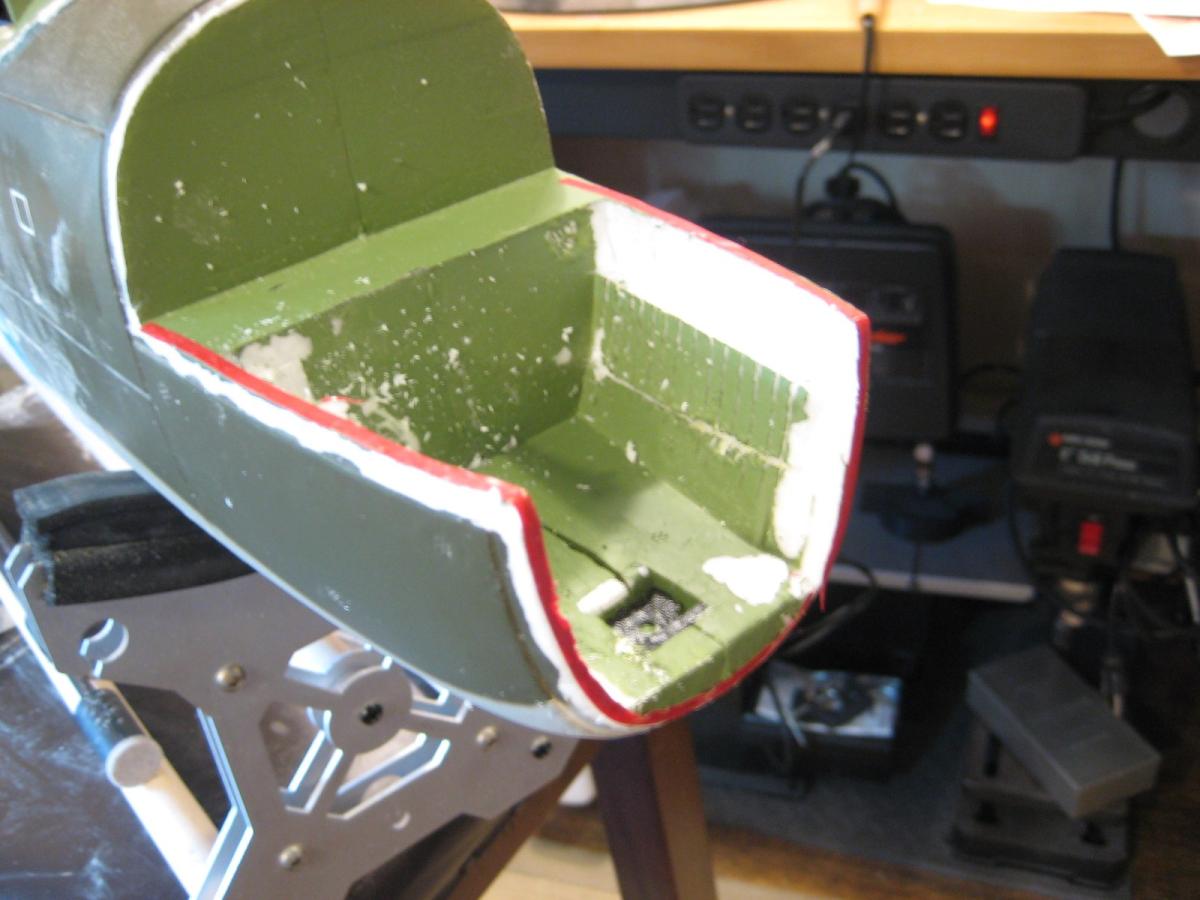

                • 4870
                Y'all.
                Version 1 of the sidewalls and floor.
                Next is cut back into the aft structure as far as the nose gear plastic mount.
                Then some fun detail stuff: design reinforcement and detail the structural former.
                Sidewall detail after that, gun placements, ammo boxes, radios, seats, and the like.
                Best, LB

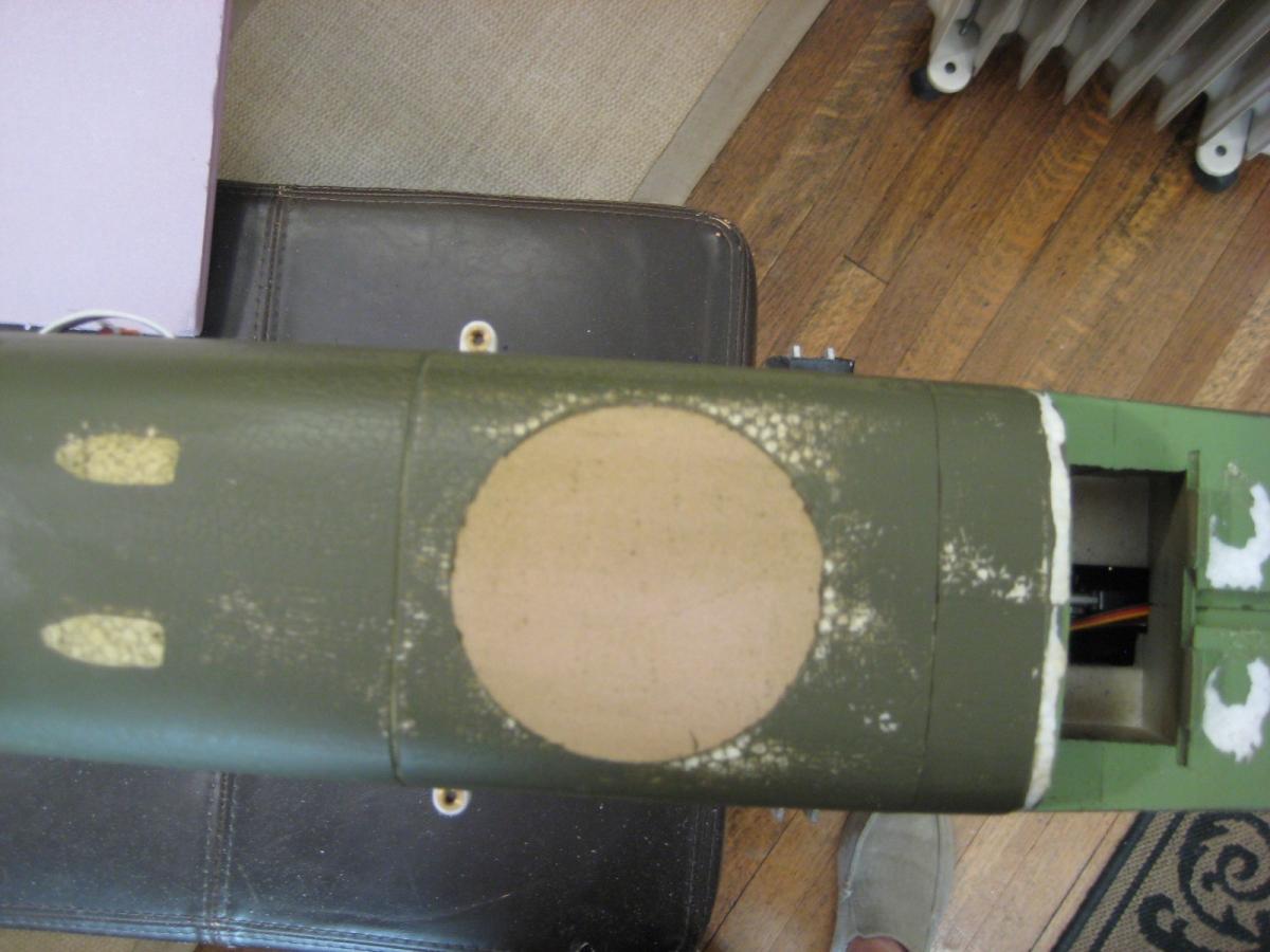

                    Hey Mitchell Maniacs,
                    Did some additional foam surgery.
                    I designed & printed a cutting tool to more cleanly cut the aft fuselage turret.
                    Worked great and more importantly the OEM turret fits quite nicely.
                    When I scaled OEM turret, I did notice it is slightly larger than the drawings I am using, but it looks just fine.
                    Onward, it is the only option....
                    Best, Steve

                      Nice work, Steve! Did you put some sort of cutting edge on the bottom edge of that ring, or did it just cut through the foam, like...Butt-uh??
                        • 4870
                        DG, well, let's say towards the end, it was more like cutting through cardboard with a fast-food "butt-ah" knife.
                        I did design in a cutting edge with 8 tiny notches, which worked well.
                        It was great until I hit the cutting edge's bevel point and then things slowed a bit.
                        Logical error, so any further designs, I'll just lengthen the bevel to match the estimated depth of material.
                        Nice thing offering to assist "Danger" Gross. Let's put our heads together and see what can be done for him.
                        Best, LB

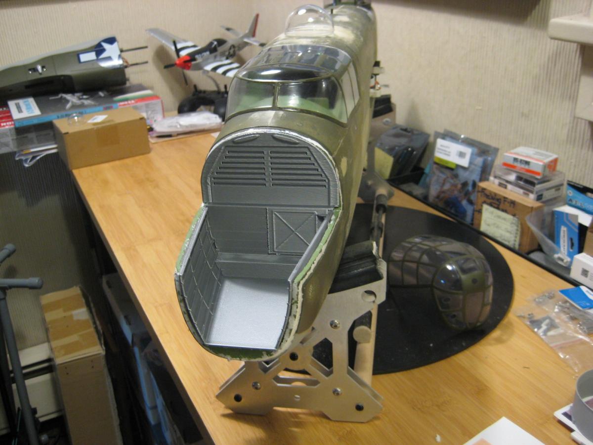

                                Bomber Brethren,
                                Not much new on the fuselage, as I have been sorting out the forward fuselage greenhouse detail.
                                Starting to look about right, though I am having some 'thin wall' issues in the prints which are mostly self-inflicted.
                                The 'scalies' with notice a door which does not exist in the Mitchell, but for reasons too silly to explain, I have a door.
                                This is the same door I stood behind when God was handing out the Business Calculus gene BTW.
                                Next is to add the bits and pieces of the greenhouse: bomb sight, seats, ammo boxes, .50 cals, map case, et cetera.
                                Best, Steve
                                  Bomber Brethren,
                                  Best, Steve

                                  Looking nice, Elbee! That forward cabin is off to a great start!
                                  Cheers
                                  Davegee
