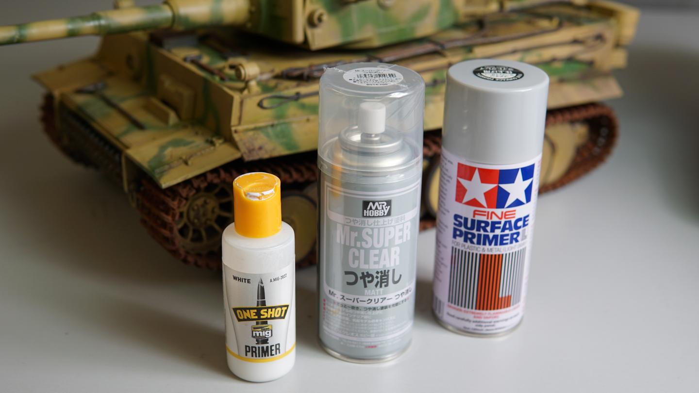

If you plan to repaint your tank, however, you'll benefit by using a proper primer to give your color coats a strong bond to resist wear and tear. Most RC tanks are made of ABS plastic, but sometimes there are components, parts, or whole tanks made of cast metal or machined metal. In any of these cases, you'll want to use a high quality primer. Different primers have different properties, disadvantages, and advantages. Given the larger scale and harder wear protection preferred by actively running into obstacles, "thinner" primers used for static models isn't recommended because these tend to be thinned to preserve the tiny surface details of scale models. For a 1/16 RC tank, where panel lines are deeper and wider and there's a lot less surface detail, incline yourself toward thicker, more sturdy industrial primers. Think "outdoor lawn chair".
Best Hardware Store Rattle Can Primer:
Rustoleum Plastic Primer
Pros: Durable and inexpensive
Cons: Easy to apply incorrectly, too thickly, or otherwise leading to an overly rough or uneven finish.
Best Hobby Grade Rattle Can Primer:
Mr. Surfacer 1000
Pros: Durable and ideal for both plastic and metal parts
Cons: Expensive and difficult to find.
Best Airbrush Applied Primer:
Ammo By MIG's "One Shot" Polyurethane Primer
Pros:
Cons: Expensive, not easy to find in certain parts of the world.
Here are the recommended steps to maximize adhesion:
1) Lightly sand any parts to be painted. Plastic parts can be sanded with 320 or 400 grit sandpaper. Metal parts can be scuffed similarly.
2) Thoroughly clean the parts with dish soap, followed by wiping the surface with an alcohol towelette to completely remove any oils from the surface.
3) Apply your primer according to
4) Wait at least 24 hours for the primer to cure. Most primers can be handled within an hour of painting, but it is best to let the primer fully cure.
5) Apply your color coats as desired
6) Seal the color coats with two or three top coats of clear sealer, being sure to use a sealer that is not the same composition as your color coats, otherwise they may run together and ruin your color coats.
Recommended sealers include:
Testor's Dullcote
WBPU
Super Clear 1000

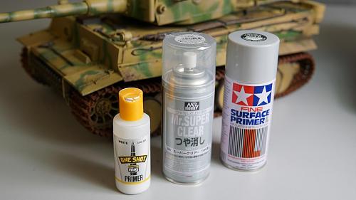

Mr. Surfacer 1000
Pros:
Testor's Dullcote
WBPU
Super Clear 1000
