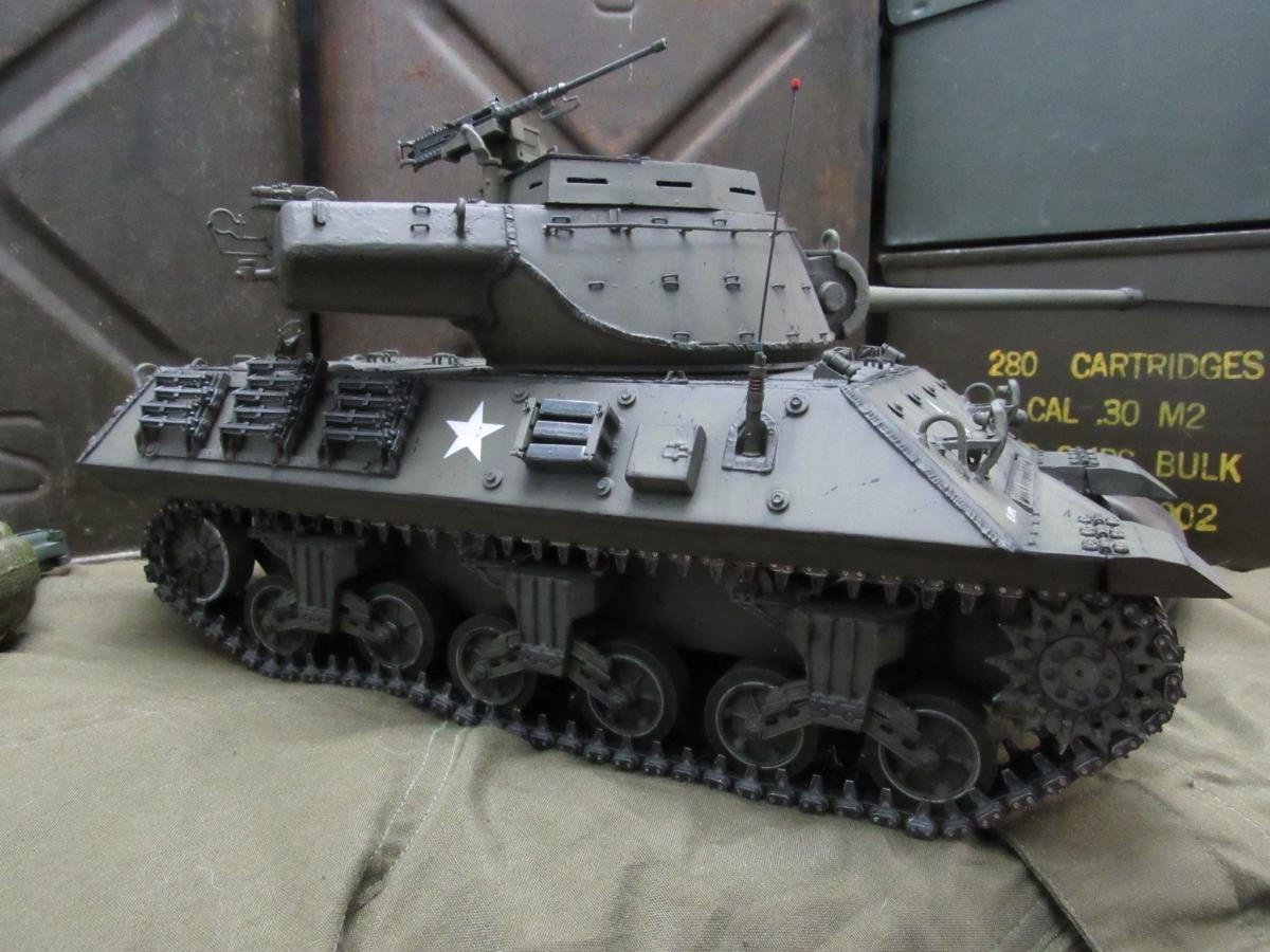

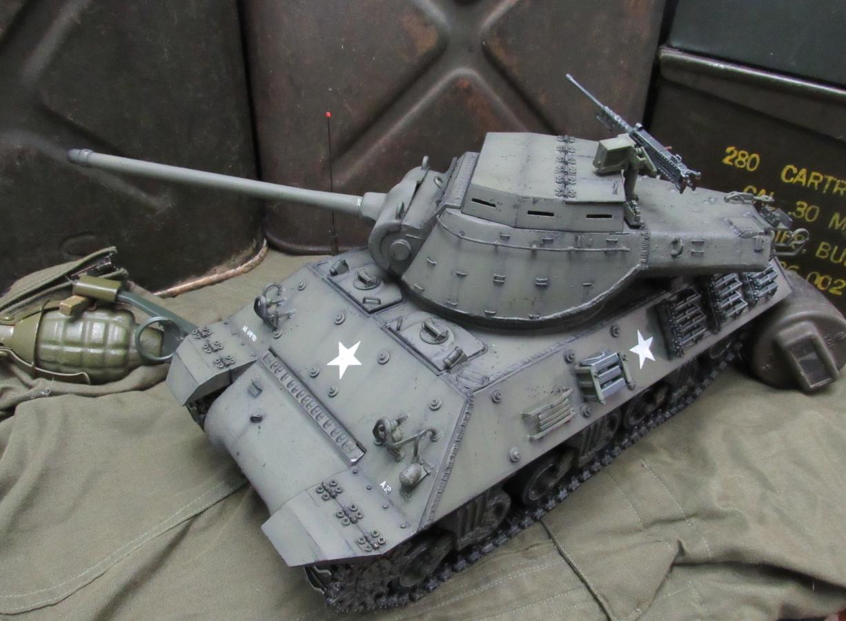

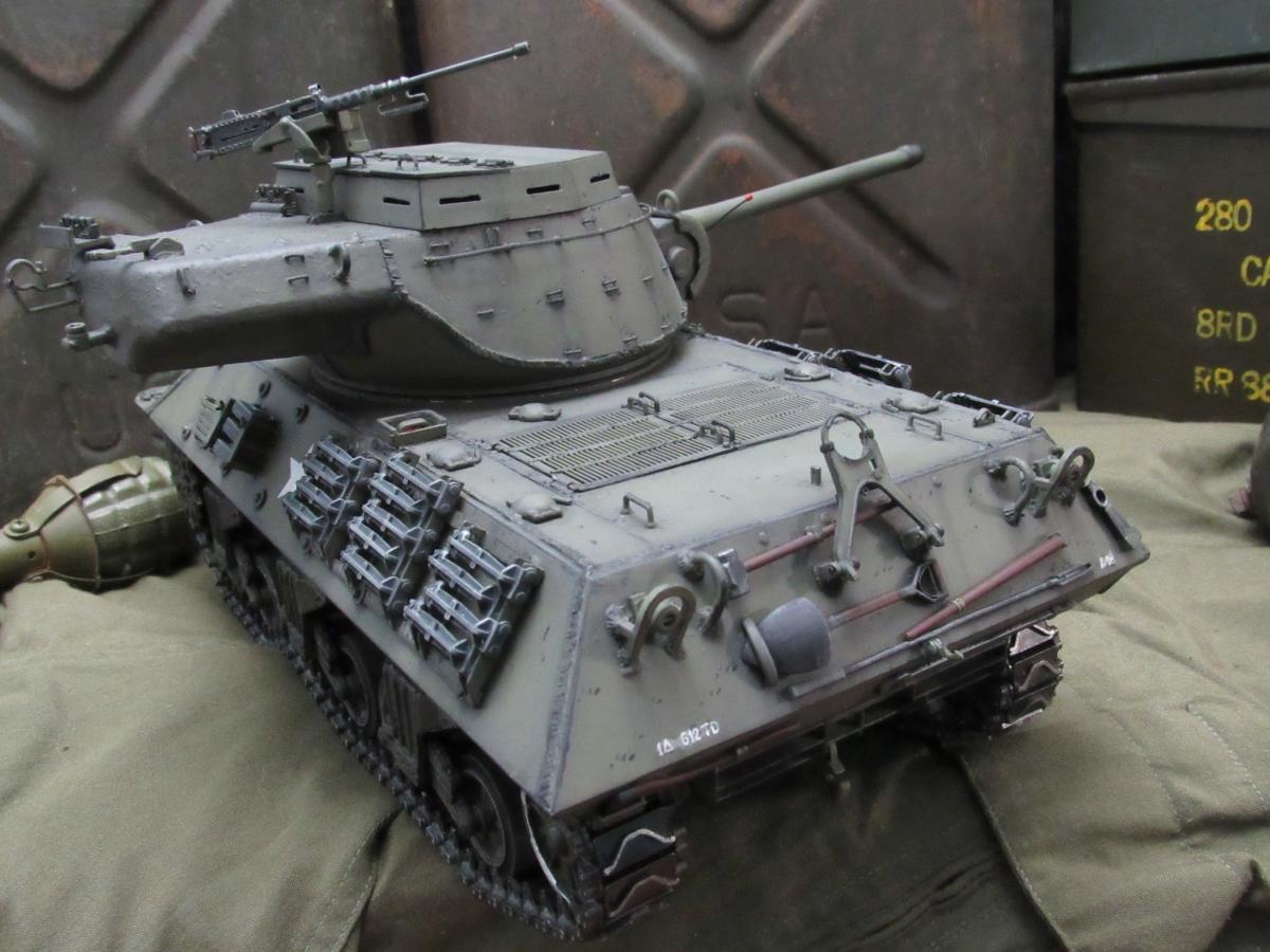

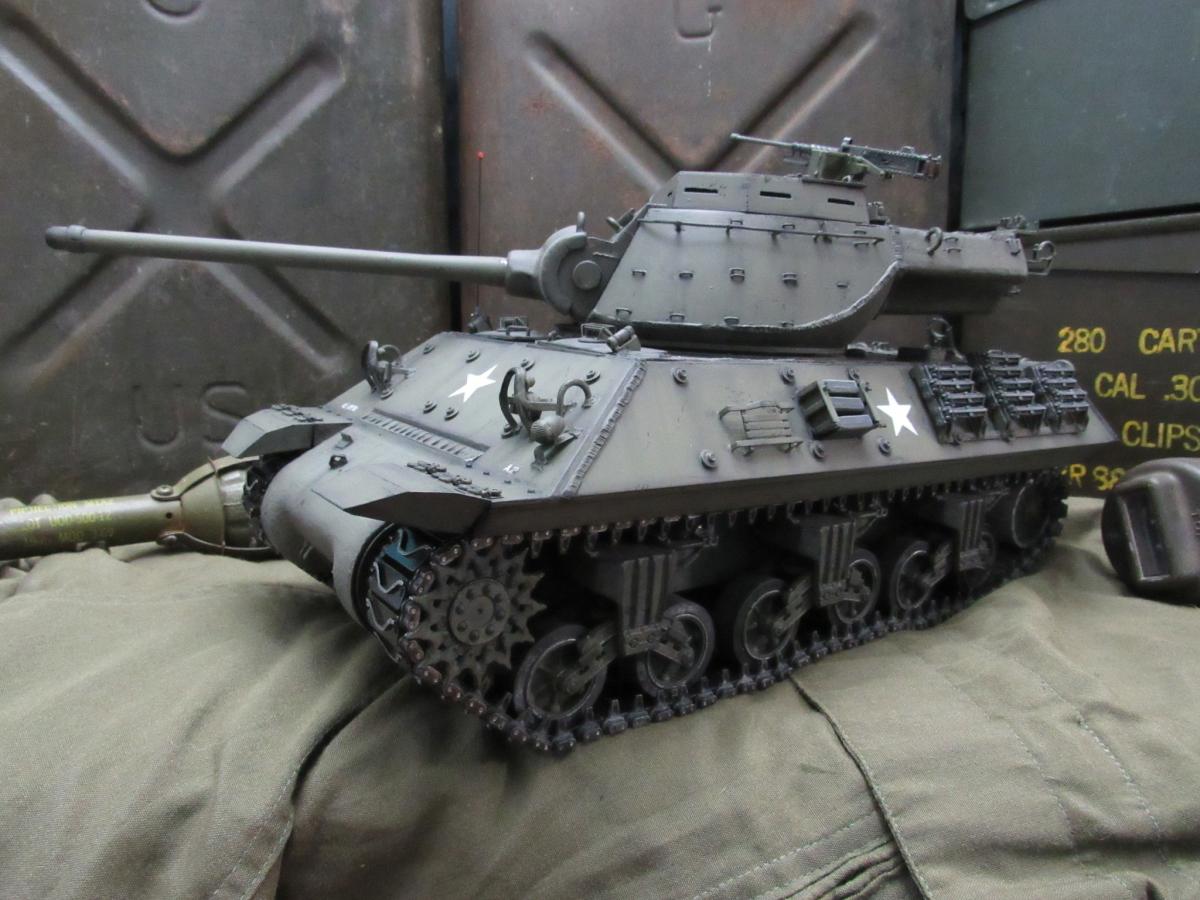

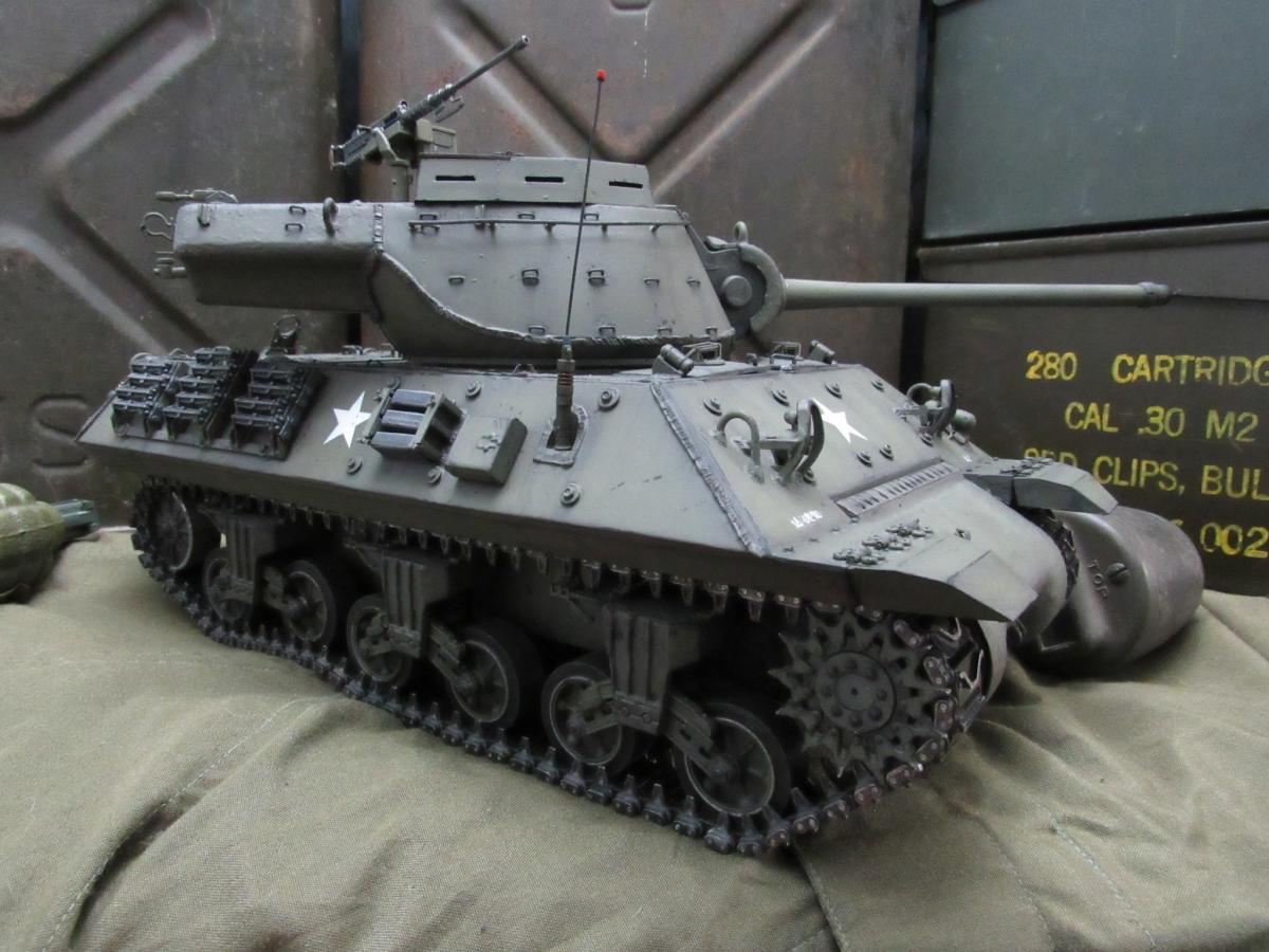

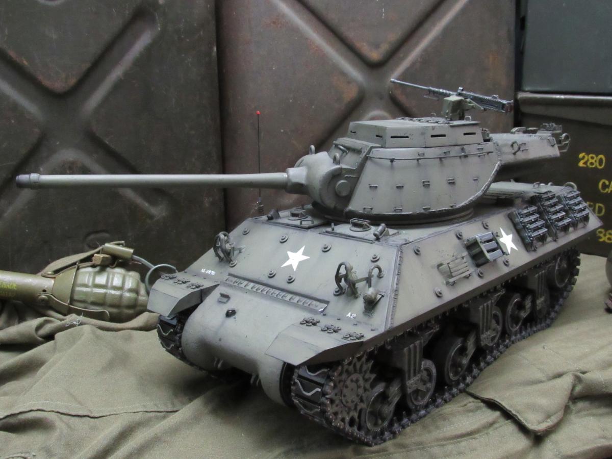

    This was probably the second RC tank I bought ( the first being a HL King Tiger ).

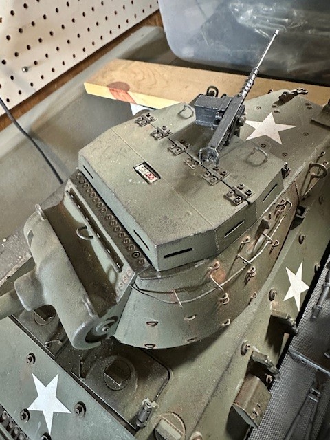

    Early on in ownership, before realizing just how much tinkering and upkeep can be required to keep these things going I became pretty annoyed at just how easy the paint that Mato used wore away, and someone suggested using a matte clear coat on it which I did. I forget which one I used but it ended up eating away at the paint and exposing the primer underneath. At that time I didn't paint, so decided to send it off to John at East Coast Armory who lives an hour or so from me. I picked it up a few weeks back and he did a fantastic job on it.
    Unfortunately this is another tank with a failed IR emitter and I am trying to think of the best way of tackling that without dismantling and possibly damaging the work that John did. I may end up mounting it externally somewhere, or just leaving it as is and having it be a " target tank ".

    The M36 gives you a unique opportunity. You might consider this: I installed a mount for the IR receiver on the separate cockpit cover. It wouldn't be hard to also install the emitter on it. That way you wouldn't be involving the overall paint job. You can buy that cover separately from Matomart, install your elecronics, and replace the original one when you just want to show off the tank..

    I plug in my LegoDEI IR receiver into the socket when I battle with it. In my case, the IR emitter is in the barrel.

      thats an awesome idea and will probably go ahead and do that. Based on my experience with the other Mato tank I have that I've been working on ( Emitter replacement, servo replacement ), I am fairly certain I can't get the tank that John modified apart without damaging it, at least not until I get more experience and learn to exercise more patience working on these.
      I think something like hot gluing a small tube on top of the cockpit cover to hold the emitter in place is all I'd need to do. Aiming in terms of elevation will probably be an issue, but heck...the likelihood of this ever leaving my living room to battle other tanks is probably 0.001 % ( no clubs or enthusiasts in east-central PA ).​
