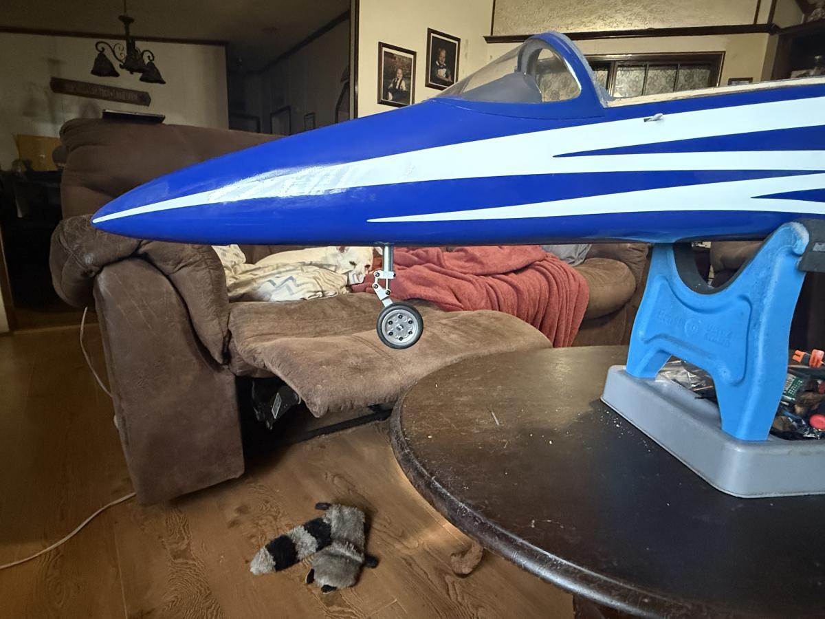

        I just bought the Blue on clearance version, I have the main retracts but what do you all suggest on the nose wheel. Going turbine with mine, a friend suggested 50mm front with 55mm main wheel sizes. Any recommendations would be appreciated

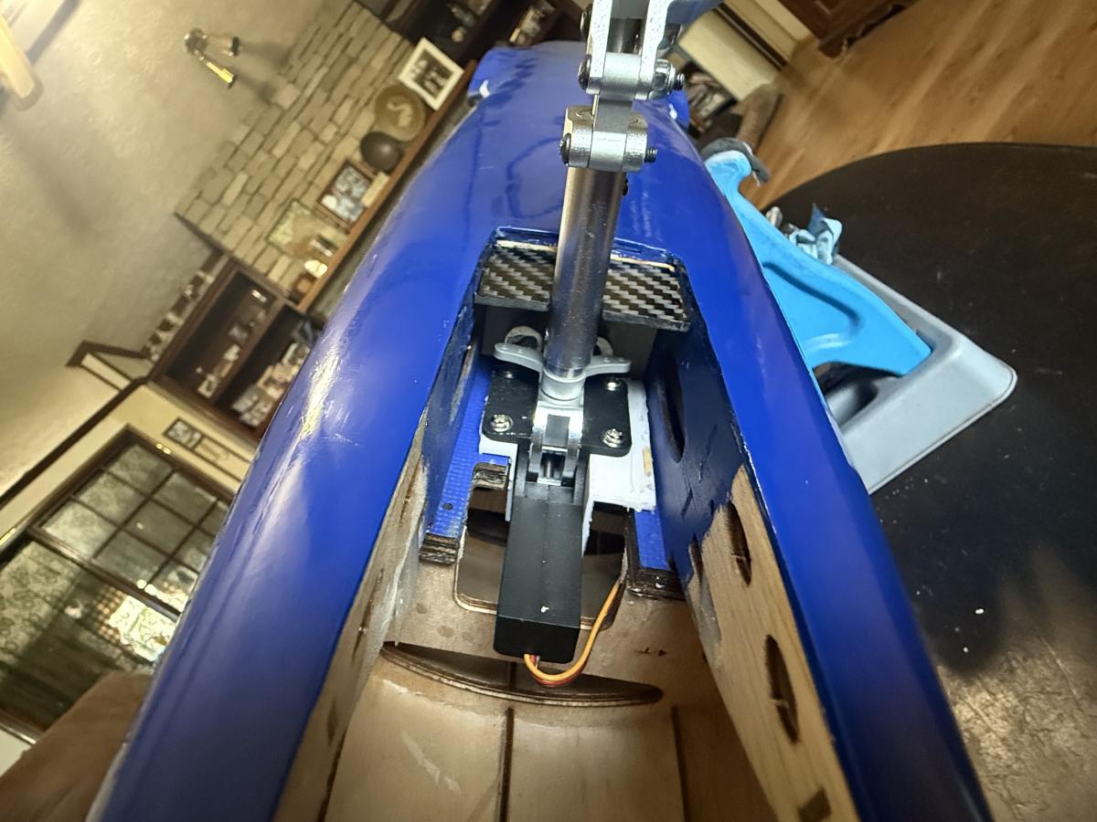

          Just designed my own steering setup for the 90 L39 did away with the cable set up just didn’t seem very dependable. I’ve made templates measurements using a stock FW 5mm pin retract from the 90 F15. Using a push push design with a carbon fiber reinforcement to help keep stress from the retract. Will be using the suggested metal main retracts for the wings, designed everything so there is travel adjustment at the ball link and bumper that moves the steering. I’ll be doing a TikTok vid on installation shortly. Any questions happy to help

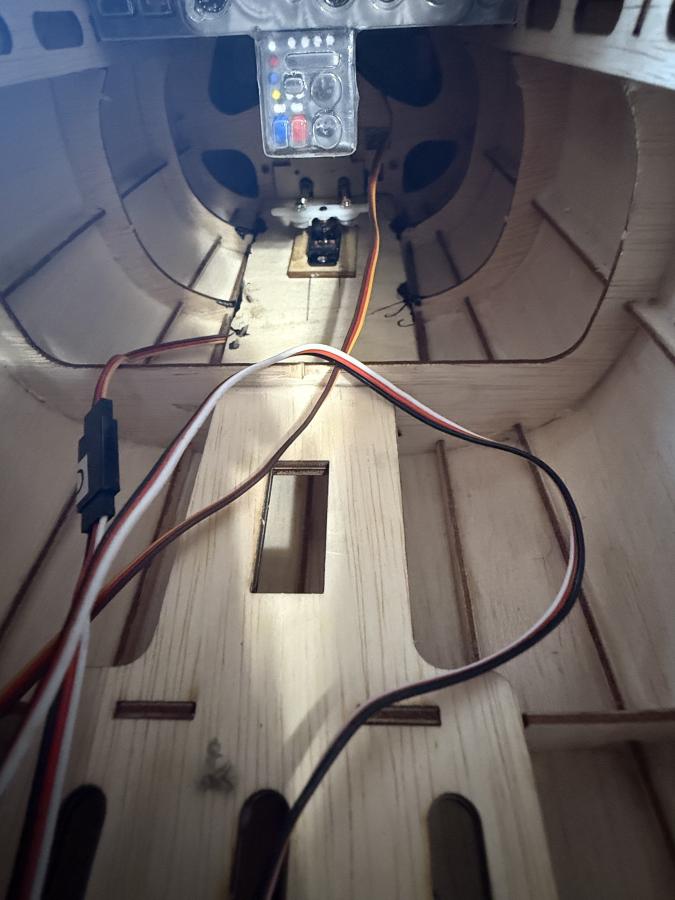

                I am almost finished with the assembly. One important comment is that Motion's recommended nose wheel servo, the Hitec 5245 does not fit the mounting. I ordered a Spektrum 5080 digital servo and it should fit perfectly. (I have a Spektrum A500 analog servo which is the same size and fits like a glove, and works. But I worry about mixing an analog nose steering servo with the digital Hitec rudder servo (Motion's recommended 7 Hitec digital control surface servos from all fit fine). As usual, the instruction manual is someone mixed up but an experienced builder should have no problem. The recommended JP Hobby fan seems to fit well but I haven't completed the installation yet. This model is much better than prior Black Horse L-39s - particularly because they include the three retracts which are easy to install and fit perfectly (as long as you choose the correct nose steering servo and don't use Motion's recommended one).
