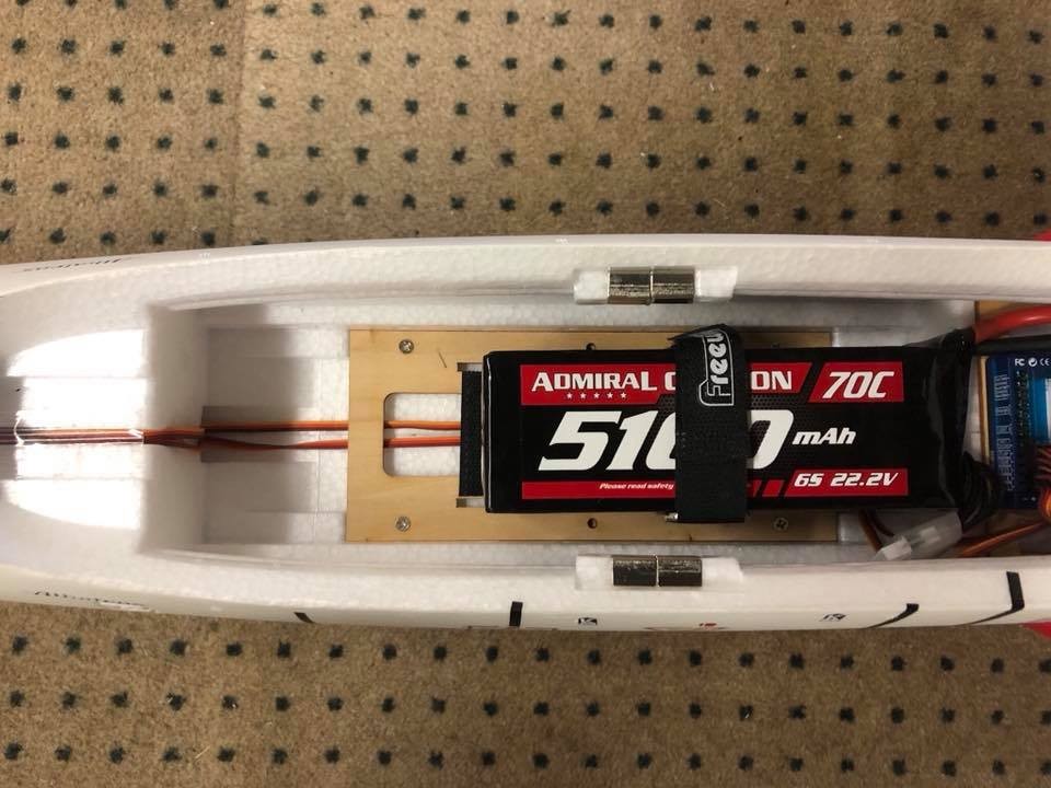

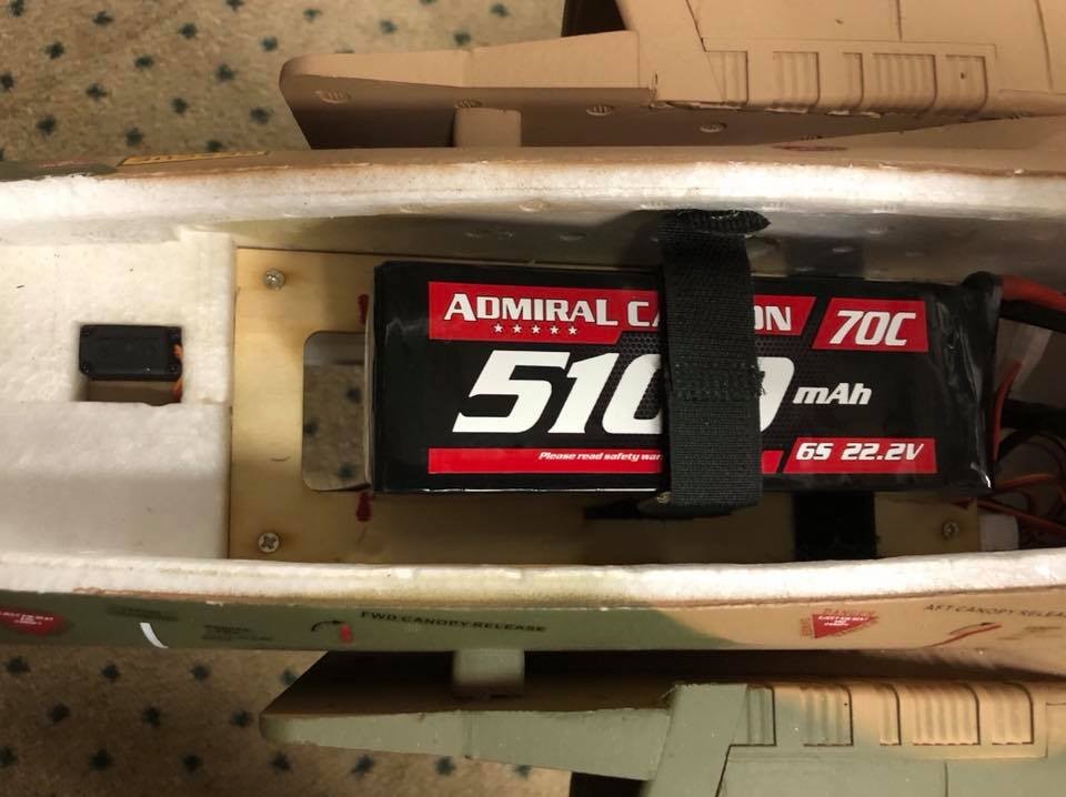

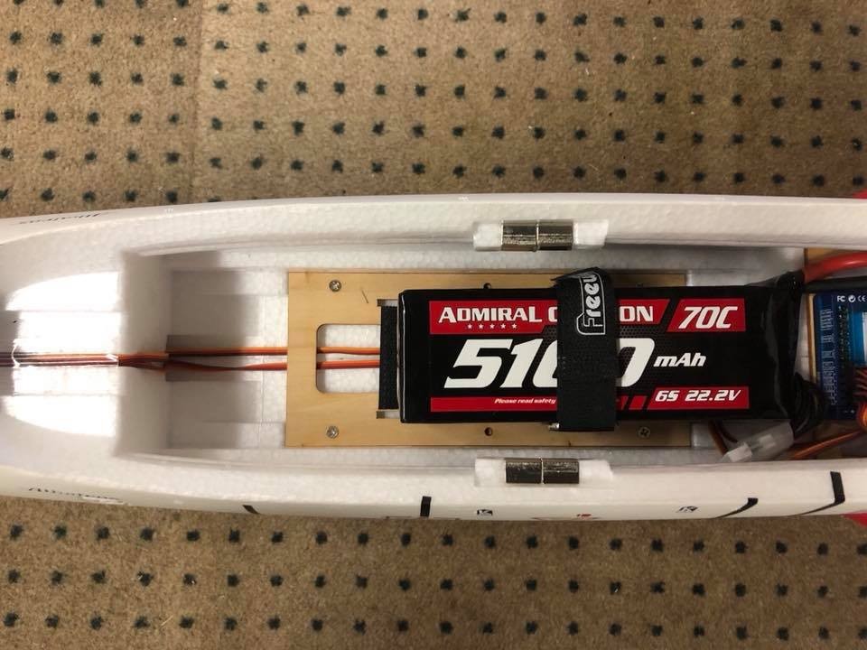

                On the Freewing F-4 a new Admiral Carbon 6S 5100mAh battery will CG at 190mm from the wing root if the battery is all the way forward to where the canopy stops it. If this battery performs as good as it looks we’ve got something:Cool:

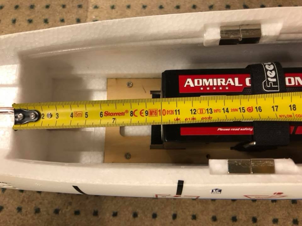

                On the Freewing L-39 a new Admiral Carbon 6S 5100mAh battery will CG at 103mm from the wing root if the battery is 100mm from the point where I measured from.

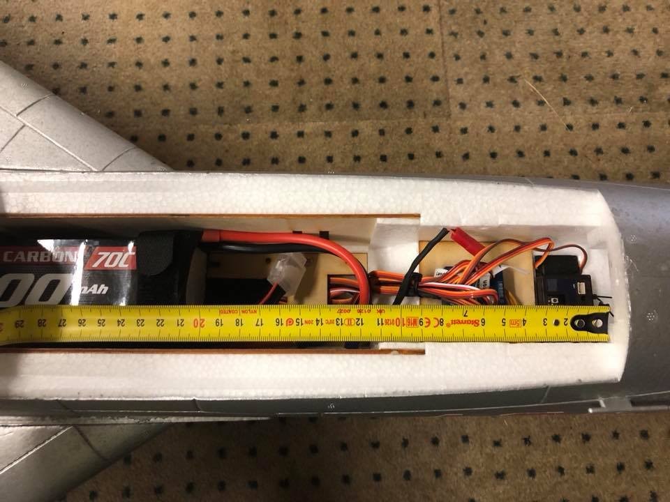

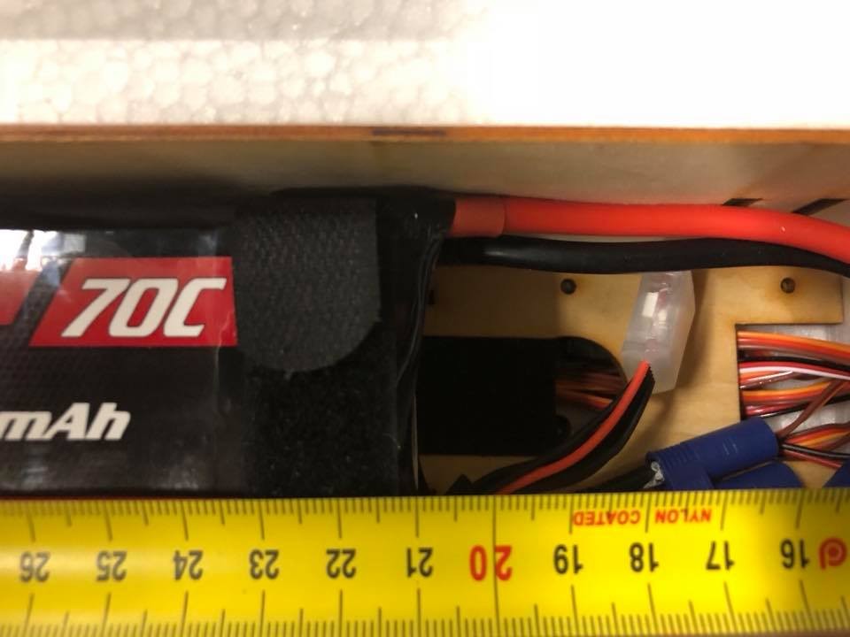

                On the Freewing Mig-21 a new Admiral Carbon 6S 5100mAh battery will CG at 265mm from the wing root if the battery is 210mm from the point where I measured from.
