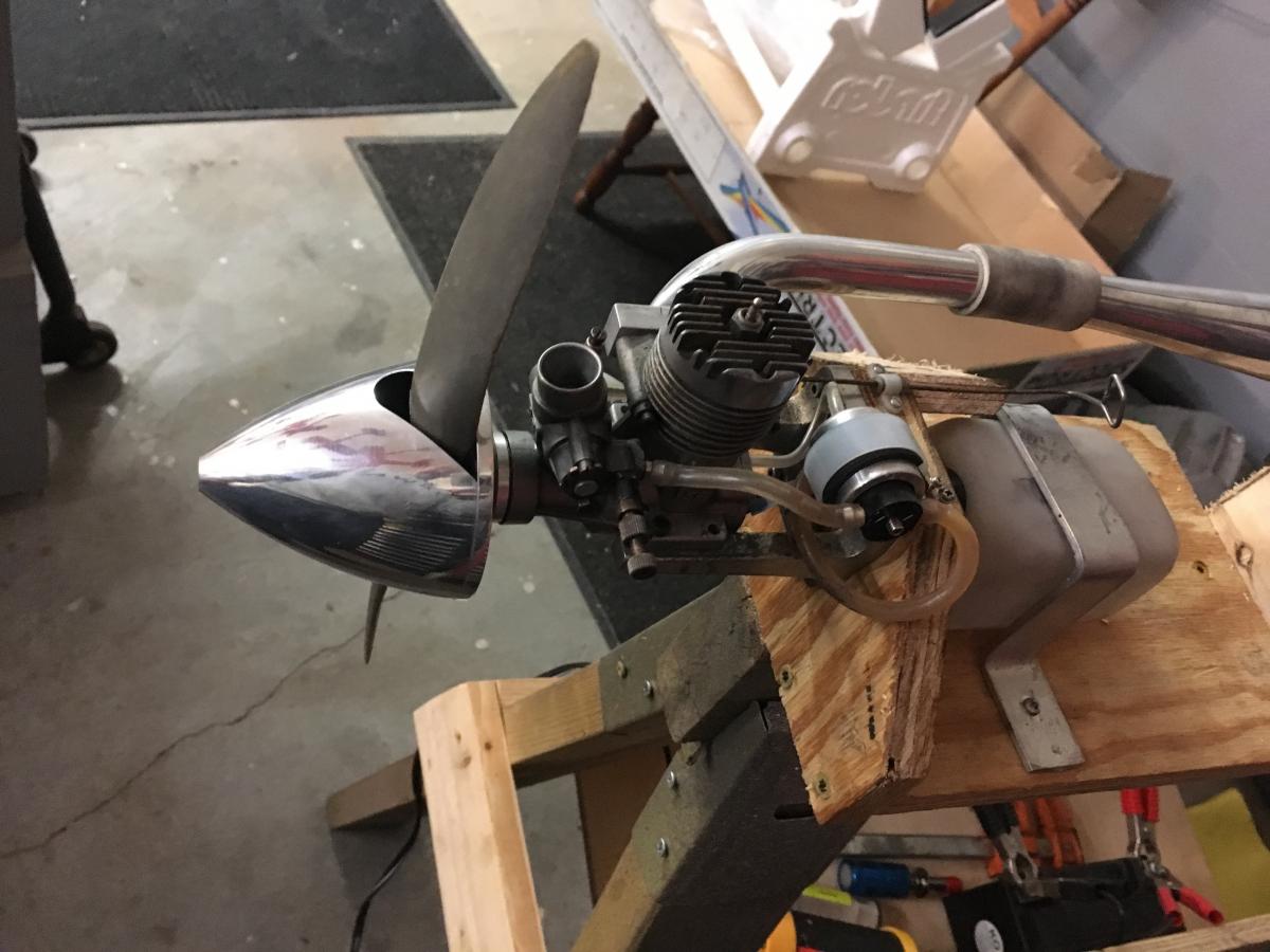

      Thanks. I’m not sure what changed. But they are going fine now. Each engine and carb was carefully dissembled and cleaned with ultrasonic cleaning spulutikn used for watchmaking. Then oiled and reassembled . Initially they just seemed to run poorly. My assumption is the oil used to assemble them burned off and now they are running great.
      The OS 46 turned out to be a powerful O.S. 46 p the p meaning it requires a pump. There is a fitting at the back of the crankcase that goes to the pump. It is fitted with a tuned pipe and I a waiting for the pump from Perry.
      Thanks for the reply.

        I installed the Perry pump. It made all the difference. Engine idles well and makes good power. Now I need to find a plane to put it in
