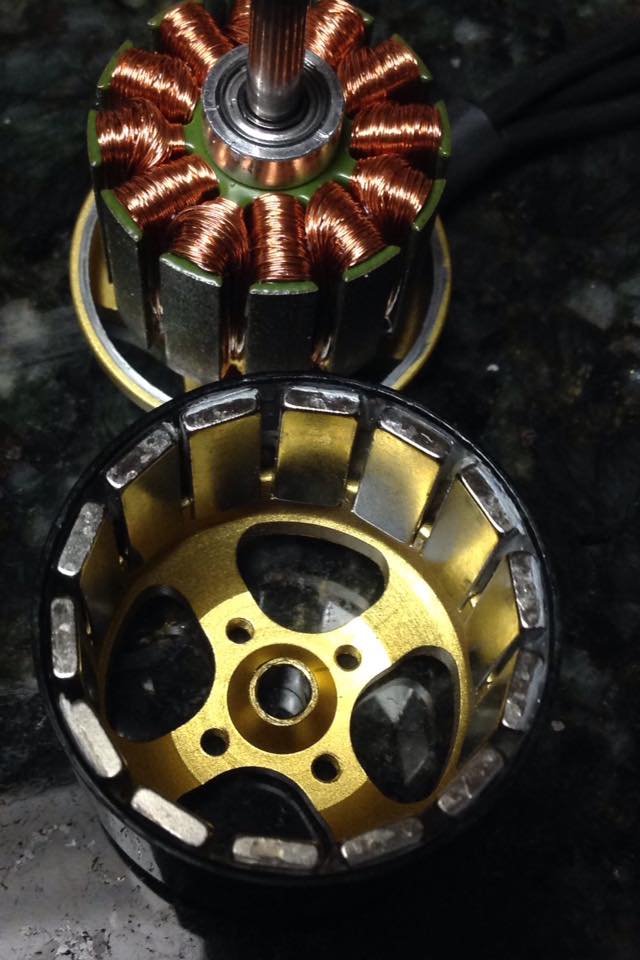

That evening, I turn the prop and I hear a grinding sound. Take off the spinner and prop down to bare shaft. Turn the shaft and the grinding is coming from the motor itself. Something is making contact. Keep in mind, this is the stock motor (FMS 4250-KV540). So I logged on and ordered a replacement motor.

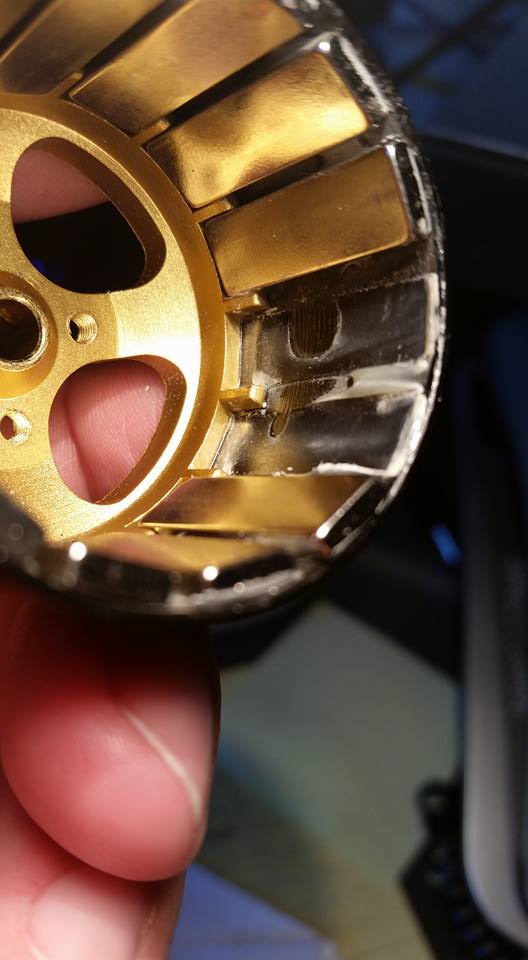

Decided to sit down and tear into the motor to better understand how they're built and what might be the problem. Turns out, several (6 to 8) of the magnets weren't glued down. They would simply slide up and down...none turned sideways or anything crazy. Some local folks said to try re-gluing the loose magnets and see if that was the problem. I still couldn't really tell what was actually grinding. So after watching some You Tube videos, I gave it a shot, made matters worse, smeared glue everywhere, and just tossed the motor in the trash.
