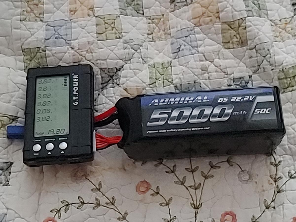

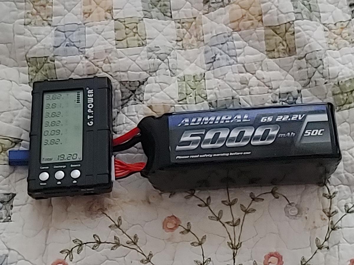

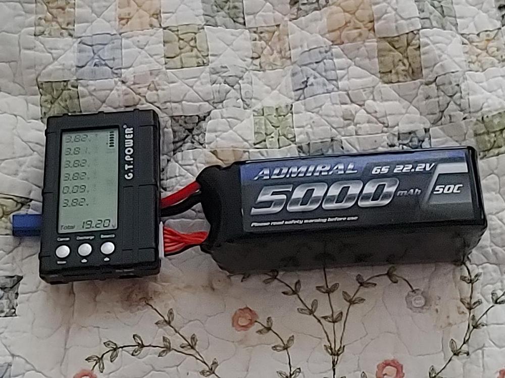

Name:	Lipo Battery.jpg
ID:	180617 This is exactly the string I was looking for. I have the same problem with a 6S Admiral battery. See attached image. One of the cells is completely gone. Are replacement cells available anywhere or do I just discharge the battery and discard it? I hate to throw a ~$100 battery away...but not worth losing a plane over a bad battery. Any thoughts? Thanks!
          • fhhuber
            • Aug 2015
            • 1476
            One dead cell = drive a nail through the pack and let it burn. (in a safe location...) Then once its guaranteed inert, toss it in the trash.
            The other cells are from the same lot and are the same age with the same use history. You can't trust them.
