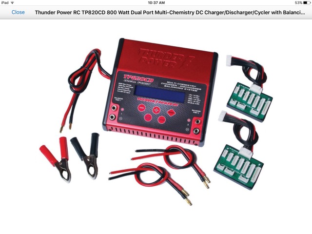

                  I have the Thunderpower TP-820 and all I can say is ... It's awesome ! It can handle 400 watts
                  per channel ( two independent charging ports ) up to 20 amps per channel. It's all the charger I
                  will ever need. No more waiting forever to charge a 6s 5000mah pack with a wimpy 80watt charger
                  for me !
                  It's very easy to navigate around the software. It monitors independent cell voltages, charges,
                  balances, can be used to discharge, and I especially like the fact that it provides the ability to
                  measure internal resistance so you can monitor the health of your battery packs.
                  For hardcore EDF jockies that push the limits of their batteries C rating, this is the charger for you  :D

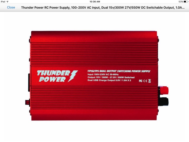

                  P.S. - I use the Thunderpower TP1527PS 27vdc power supply for my TP-820. A perfectly matched pair !
