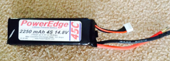

I too used a 2250 45C 4 cell battery for some of my 50 inch 3D ships pulling 46 to 48 amps with an APC 14x7. Other than the need for nose weight from the heavy 45C 258 grams battery they all would have flown better with the lighter battery. So if not needing the current draw I would recommend the lighter of the two batteries. These 45C batteries were great for 64mm 70mm EDF models. But in lower amp draw set ups the 25 or 30 C rated batteries are often best.
