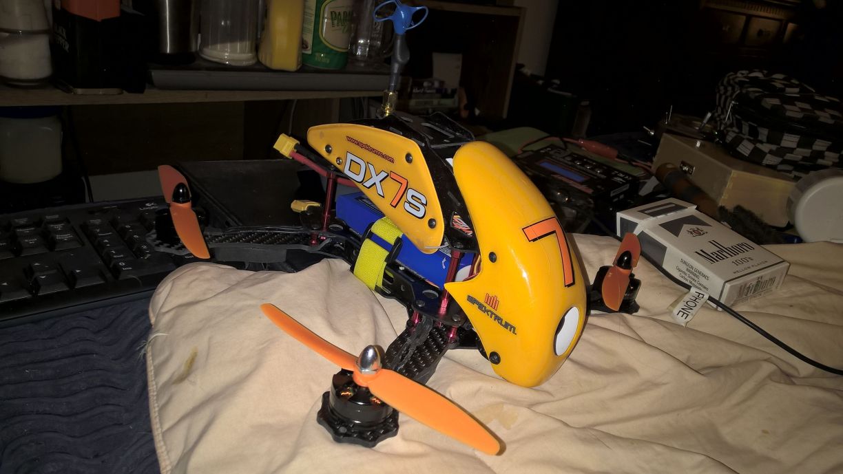

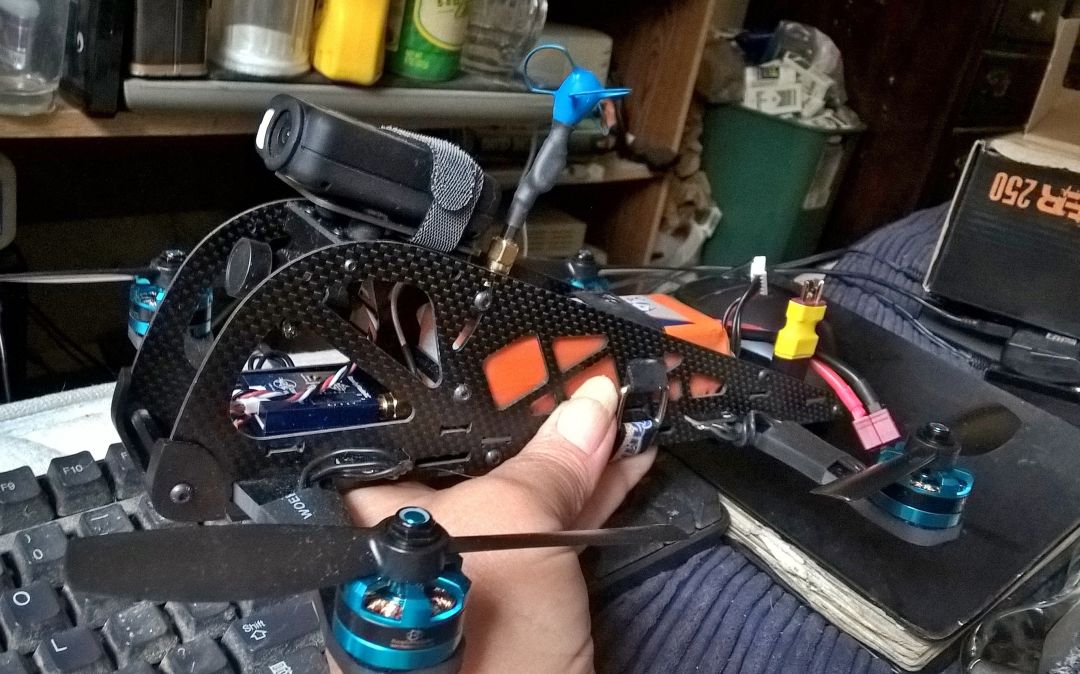

    I know they aren't airplanes but they are aircraft... These are two of my three winter projects. Everyone else at our field has one of these 250 sized quads so I had to keep up with the Jones... :)

    Who DOESN'T have a few 250mm class racers lying around these days!  :) They are a lot of fun for sure. I have a couple of cheapies built and flying but am always enticed to buy more frames it seems?! I really like that frame with the yellow body set. Is it a Tarot? Or? I have one similar but in neon green. Just need to find time to get 'er built!

      The one I have is a knock off of the Tarot called Robocat. Storm also makes one similar called the StormRacer. My son's got the kit for me for Christmas off of Amazon from a company named LHI. It seems like a decent frame, all carbon fiber and I kind of like the flip top. Makes it easy to get to the innards. I popped a CC3D board in it using LibrePilot (it is the continuation of the now defunct OpenPilot). I was going to use CleanFlight like I have on the Mudskipper but wanted to see how LibrePilot had evolved the OpenPilot platform. Haven't been able to get it outside yet to really tune it because Momma Nature sent a blizzard our way. So I've been flying it in my spacious (sarcasm) living room. ;) I've had the Mudskipper out for a quick flight and that one seems pretty solid. The little bit that I've flown the Robocat it seems pretty nice. Got to get some better props on it. The ones I have on it flex quite a bit but they don't break when I hit the sofa. Ha! The motors are eMax 2204's and the ESC's are eMax BLHeli One Shots 12a. Running a 3s 2200 battery on it which I have a ton of since many of my airplanes use that same battery. The board camera is a Runcam PZ0420M and the VTx is an RMRC Crickett 200 mW 5.8GHz and the VAS Race Spec Airscrew antenna. The frame came with a perfect sized hole to mount it on. Anyways, go get her done and it's nice to meet you!
