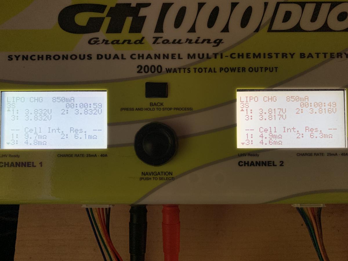

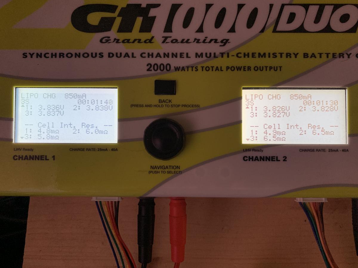

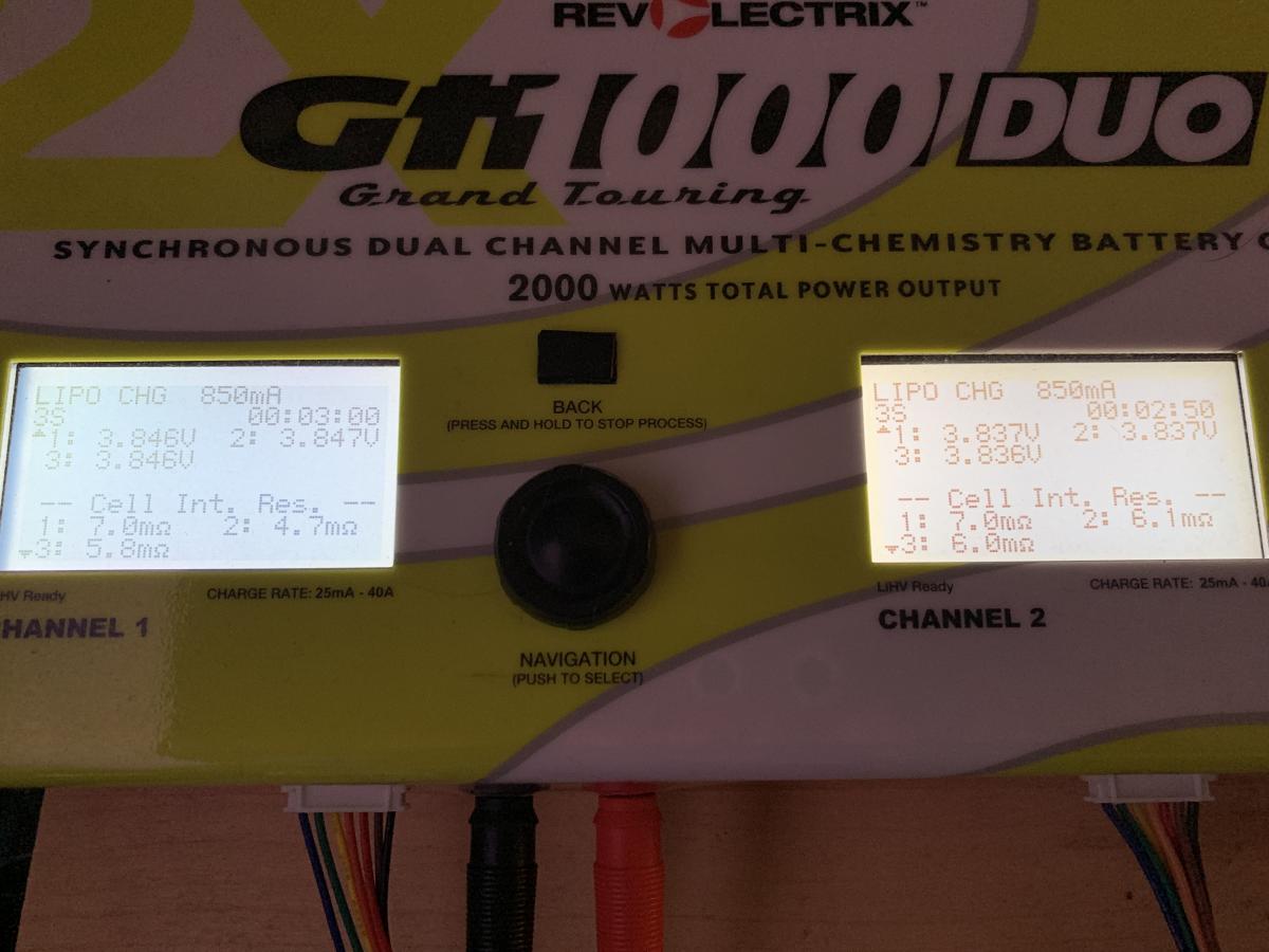

    The big question.........where are the IR's at
      • 8814
      Since you asked, I put both of them on the charger for a couple of minutes just to see. These are 3 photos I took over a 1 minute period while balance charging. The left shows the "good" battery. The right shows the "resurrected" battery. You can also see the cell voltages as well. Not sure what it all means but both seem similar to me.

        Intriguing...................:astonished:
