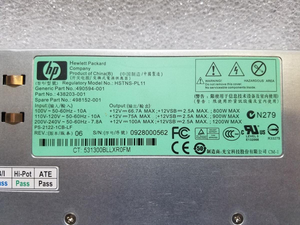

                I guess the time will vary based on the battery you have. they are going to be the only limiting factor. I have batteries that say they're safe to charge at 8C.(turnigy nano tech) most of my batteries say they can charge at 4C.(smc 4s 6000mah and spektrum smart 11s batteries actually) I usually only have to wait about 10 mins for a 6000 mah 4S.
                as for the power supply look up HP proliant HSTNS-PL11. 900w 75A 12v. output using 110-120v input.
                the wires are barely warm to the touch. it's very hard to tell they're warm. 12awg.
                Icharger actually recommends against using 2 server power supplies in a series so I've never done the 24v input. with that HP power supply able to keep up I don't see the need for 24v. you also have to modify the grounding in the chassis of the power supply which I don't want to do. so I just use one at a time. if I really wanted to do the charger's max 50amp and 1300w I would probably have to use the 24v. I do have 2 power supplies just because they are so cheap. but I've never tried to use them together.
                you also have to keep in mind in a car or your planes, the wiring is usually only 12awg and it's handling often times 150A bursts from the output of the battery. my batteries are 50 to 60C constant output. do the math. cables never hot.

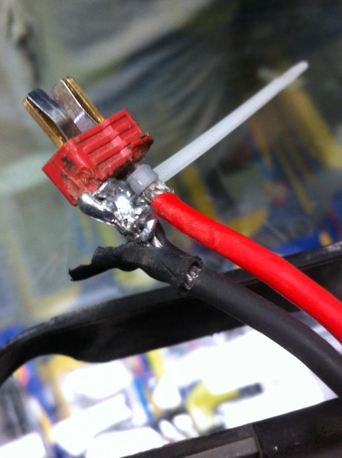

                                We're talking R/C aircraft here but since you brought up the cars.............................................. ...
                                I've seen more fried car electronics ( batteries , ESC;s , wires , motors ) at the hobby shop than you can shake a stick at. 90% by guys who " know what their doing". here's a typical solder job I run across.
                                Mike:

                                  That picture is priceless. I've done one or two "butcher" jobs on Deans connectors myself. On the other hand, they weren't on high amp, high draw applications. Why would anyone use Deans on such applications anyway, especially on a DIY job?

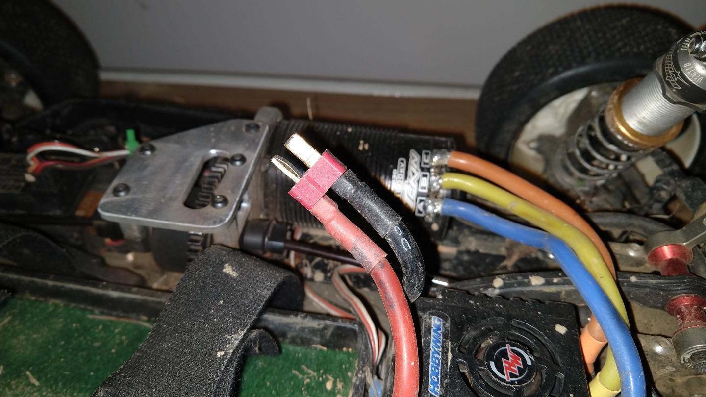

                                    that's not a real deans connector first of all. and they are probably the hardest connectors to solder properly. But, I used deans on my 1/8 scale race buggies. yeah, it's dirty from running it in the yard. I don't race this one anymore.looks like I was wrong about the wire gauge. it looks like 10awg. I normally use deans ultra wire which is 12awg. and I own a Hakko FX888D soldering station. thing is a dream to solder with.

                                      That's not the point. I used it as a example of the typical car guy I have to deal with at the LHS. They are the same when it comes to batteries and chargers clueless would be the word. I have much better luck explaining stuff to guys on the air end.
                                      Mike

                                        I was pointing out to xviper that the deans knock off may be made of poor materials. that was clearly done by someone with no soldering experience. that was a hilarious picture. I thank you for sharing it. gave me a good laugh. I find that the people with planes tend to be a more serious crowd with the hobby. a lot of them clearly have jobs that they make or design things. it takes a lot more skill and discipline to fly than it does to just bash around a car in the yard. racing an RC vehicle is also way harder than it appears. and these guys spend money like they print it themselves.
