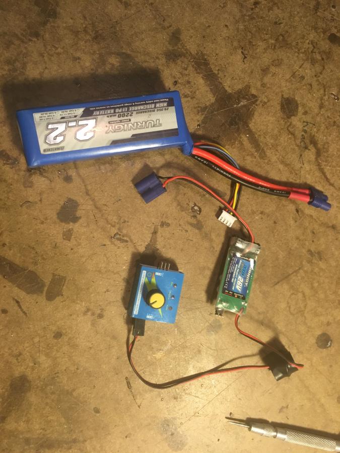

                      Since it seems the initial problem is binding, I would suggest taking everything else out of the equation. IE, power the RX with an external BEC wired to a 2 or 3 cell LiPo. Insert bind plug, power up the RX, stand at least 10 feet away and power up the TX in bind mode. If this binds the RX, then it's something to do with the plane's ESC. If this doesn't help, then it's something to do with the RX itself or the settings in the TX. Once bound, the RX can simply go into the plane (without the bind plug) and you can move on from there. This is the set up I use to bind a RX to a model in the TX:
                      Instead of the servo tester you see in my picture, plug the BEC into any port on your RX (pay attention to polarity of the plug).
