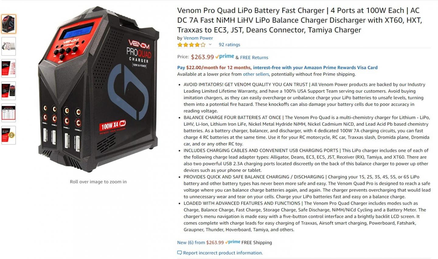

    I have the spektrum 6s 5000mAh 30c 22v batteries for my t-28. I also bought the s2100 AC charger for my home which works great. The field I am flying at has DC power hookups for chargers. I don't feel like I need a crazy expensive field charger so I was wondering what would be a good 2-4 battery charger that would charge my batteries relatively fast while at the field. Would this work, be overkill, or not enough?
    https://www.amazon.com/gp/slredirect...7-2d8018ef00fa
    What extra cables would I need to make it all work?
    Thanks!

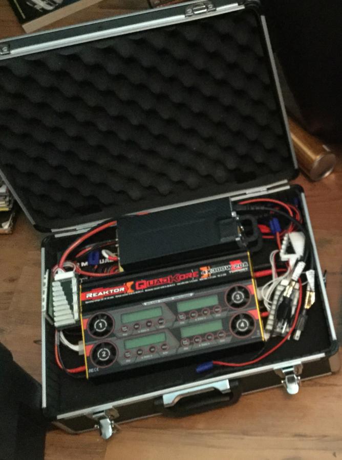

    If you have DC input I can vouch for the Reaktor Quadkore. I've been using mine for at least 4-5 years with no problems. I use a dual power supply that I can plug into AC.
    https://hobbyking.com/en_us/turbo-ch...version-2.html
    Depending on what type of connectors you use or expect to use will determine what different leads you will need and with a quad that's four of each. My main connectors are EC3 and EC5 for my Quad. You'll also need four balance boards. I can't remember what all came with the charger.. I have a separate single charger with a massive multi plug setup that I use for the odd connector once in awhile.
    This is my cheap Harbor Freight field case with the Reaktor Quad.
    Click image for larger version  Name:	ReaktorQuad_FieldCase.jpg Views:	0 Size:	70.8 KB ID:	263341

          The charger that you linked is pretty much under powered @ 100W per channel when you are talking about juicing up 5000mAh 6S bricks.
          You ideally should be looking a 200W or larger per port charger.
