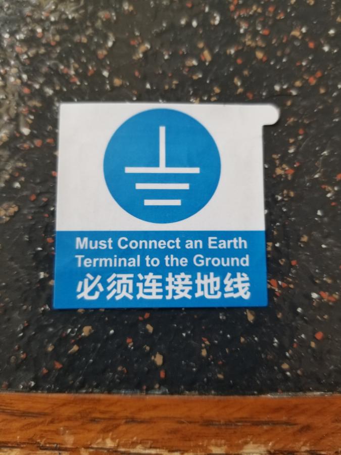

    The caution sticker on the unit reads; Must Connect an Earth Terminal to the Ground. I just want to confirm that this unit can still be used with a small (2000 w) inverter generator ?

    There is no caution sticker on this power supply regarding grounding protocols, pretty sure you are referring to the generator.
    All three generators that I had/have all wanted a earth ground. I ground mine with a 12 inch galvanized spike and 10ga copper battery cable.
    I get the spikes from Lowes/Home Depot. I also use them to secure my popup canopies frame legs to the ground.

      OV10, Thank you very much for the great information ! I will be using an icharger 406 Duo. I have one plane that uses 6S 6000mah packs, and will probably get another. It seems like planes that use 6S 4000-6000 size packs are getting more popular !
      Attached is a pic of the sticker that was covering the 3-prong AC power input on the power supply when I opened the box.
      Bob
        Pic you just referred to is not showing.

          Here it is.
            That is a manufactures warning for those that cut the ground prong off the plug or use a ungrounded adapter plug(2 blade).
            ALWAYS plug a power supply grounded plug into a grounded duplex outlet
            Just real quick electric lesson for those that care.
            In the duplex shown to the right, the smaller blade slot is the hot juice line. 120vAC (screw inside is usually bronze color)
            The larger blade slot is the "return" ground (screw is usually silver color) and the D shaped slot is the "earth" ground with a green screw color
            You should be good to go

              Thanks ! I've learned a lot from these responses ! So if I use this PS with a small inverter generator at the field do I have to do anything special as far as grounding ?
                Back to my response on generators in post#2...……….I would ground any generator
