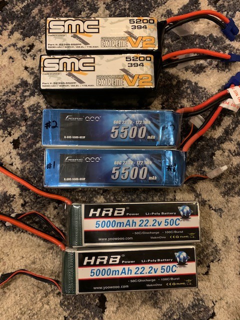

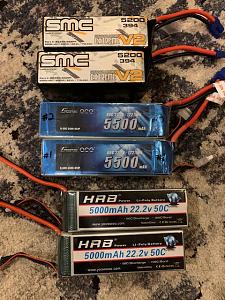

    Next, let's compare the batteries on my scale and what I paid:
    • SMC 60C 5200mAh - 750/756g - $125 each
    • GensAce 60C 5500mAh - 808/810g - $130 each
    • HRB 50/100C 5000 mAh - 746/746g - $70 each
    Comparison in the planes:
    • Havoc Xe: Both SMC and HRB were noticeably lighter than the GensAce in the air and made the plane have slightly more vertical power. If I had to say one was best, I'd say the HRB, I just feel like it really woke the plane up, so much that I ran the battery down below 20.0V (whoops!) but it landed fine. When I have done that on the GensAce, it was almost game over, very little power and it dropped fast! None of the batteries were warm aside from the HRB that I took too low, but that was my fault, and it was barely warmer than the other two. Comparing the 3, I'd say the GensAce made the plane feel heavy and didn't give any favors for extra power, the SMC and HRB felt similar and felt as good as I think the Havoc Xe can be. Maybe 4500's or lower would help more, but I don't have those...
    • Avanti S: This plane needs the discharge rate and power in my opinion (just note the delta in flight time vs the Havoc Xe above). The HRB and SMC both made the plane feel light and nimble, both worked well and gave great power to weight for the airplane itself. If I had to guess, I felt like the SMC had a little more punch toward the end of the flight vs both others, but only slight. This was going around after some touch-n-go's and low passes with flaps down.
