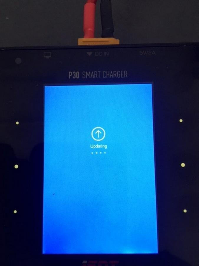

    ISDT P30 UPDATE !!!
    I updated my P30 today , but it hangs on the bluescreen for 5 hours now , i did the update via my i phone , bluetooth , ...
    Is there a FIX possible ? or do i have to send it back to the RC SHOP ?

    Its OK , when you connect your charger , from USB port to charger USB C port , you can go to the setting menu on your P30 menu from your phone , there is below an Firmware repair button , and this works , 4 minutes later it was Fixed ...
    I want to connect and update the firmware via my PC , .... i connected the charger via USB tot USB C port charger , opend the program , waiting for connection ... and thats it ... ? how i can do this , update firmware with my PC ... ?
