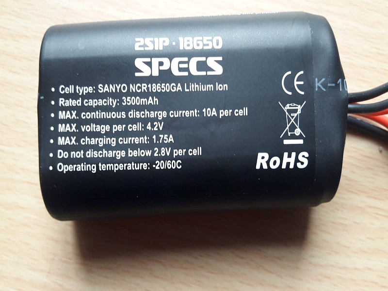

      It's an Admiral 2s LiIon actually. And this is what the label says;
      Click image for larger version  Name:	AdmLiIon3500mAh.png Views:	0 Size:	609.9 KB ID:	316991
      So... that's also "per cell"? Because then it makes sense. I know it's a lot of questions, but since just about every page in the charger's manual keeps saying the battery is gonna blow up my house if I get it wrong, I kinda wanna make sure... ;-)

        You should have specified that it's a LiIon. The same principles should apply regarding charge rate and alarm.
        • mshagg
          • 541
          • South Australia
          Lithium ion will typically have lower charge and discharge capabilities than lithium polymer. That's the trade off in this world without free lunches :)
          So set the charge rate at 1.75A for the whole pack (0.5C).
          The 2.8v specification is the minimum, so I would suggest setting your voltage alarm slightly higher than that (3.0V per cell or 6.0V total). The heng long pack can be set up the same. I assume the tank electronics have a low voltage cutoff anyway that will prevent you from discharging the pack completely.

              Sooo... indeed set it at 1.75A. Charger only does 1.7 or 1.8, so go with... 1.8? And do I kill the pack when I charge it at 3.5? Because I already kinda did... 🤔
              On the question of LiPo Vs. LiIon.... which is better? Are there even LiPo packs that fit inside the Sherman? Measuring time I guess.
              And yes, the tank just stops at a certain point. Not sure if that's an actual cut-off tho. Still gonna pop in an alarm as soon as I installed the metal grills on the engine deck so I can put the alarm in easy reach.
