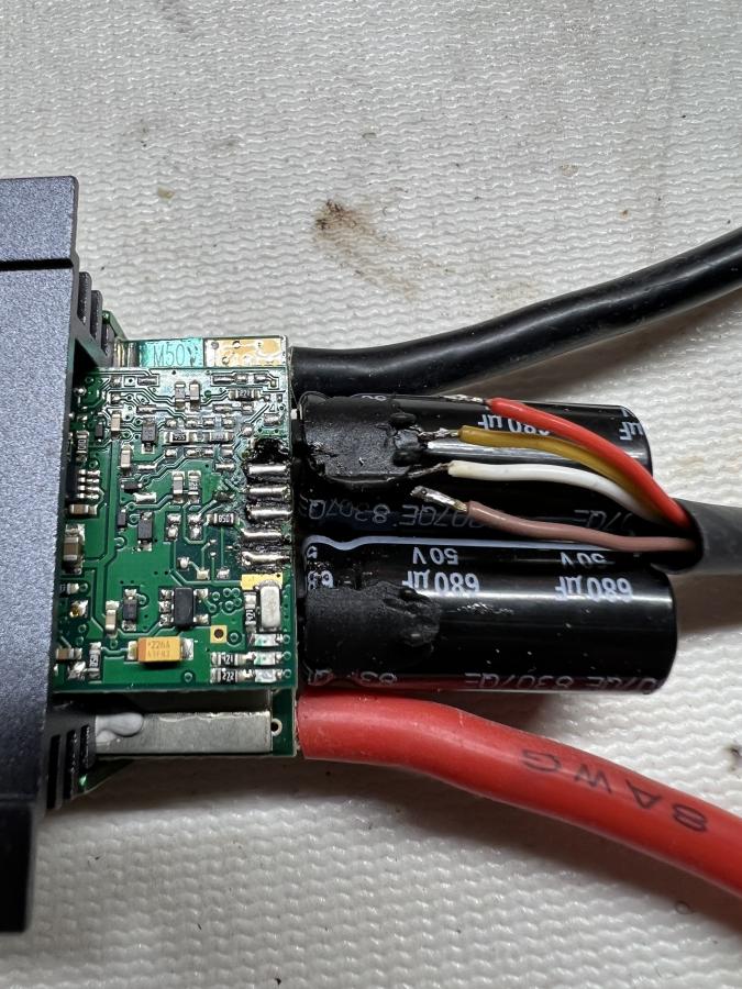

    Hello. I have a castle creations Hv 160 esc and in a crash the wiring was completely ripped off the solder joints on the esc. I don’t know if there is any other internal damage but for now I just need to solder the wires back on.
    i have scoured the internet looking for schematics or pics but can’t find one. There are 5 pads and only 4 wires. If anyone has one of these and can help I would appreciate it.
    i will reach out to castle next week.

    I would not fix that esc, the wires did not pullout by breaking but unsoldered themselves, I would not take the chance. Had to get to about 400* for that to happen.
