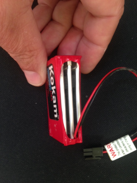

                    Yep temperature is a great concern. Remember when Kokam would build their batteries with separators to aid cooling.
