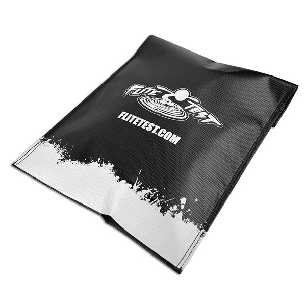

                    Flite Test has a nice and large lipo safe bag for 10 dollars.
                    Keep your batteries together & organized in this sleek Flite Test Lipo Storage Bag. Head to FliteTest.com today to purchase more FT merchandise.
                    Hope this helps.
