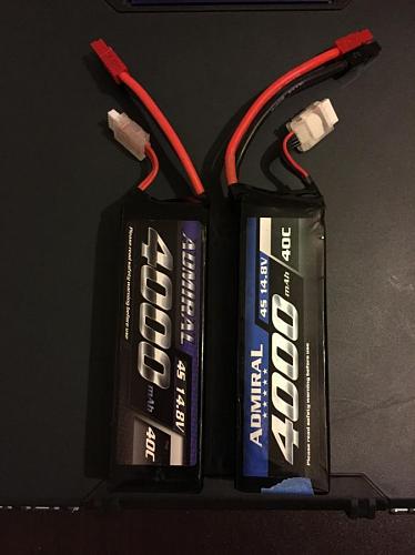

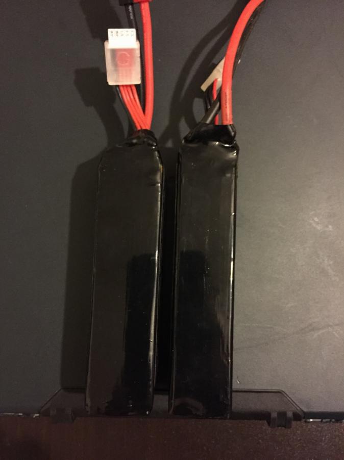

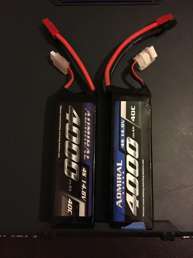

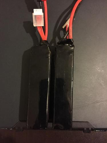

              They sure are making the NEW 4S 4000
              The new label has 5 stars below the Admiral
              Old on left and NEW on right is longer and thinner
              Click image for larger version  Name:	IMG_0604.JPG Views:	1 Size:	55.1 KB ID:	74297Click image for larger version  Name:	IMG_0605.JPG Views:	1 Size:	41.8 KB ID:	74298
              I also got the new 6S 4500 40C and it is thinner than and longer than the old 4000 40C, yes that ain't a typo.
              This is the 4S 4000 I ordered which is the only one they show now. They removed the old style probably after they depleted it's inventory.

                  That isn't the 'Pro' version, so I assumed it is just the new manufacturer creating the same battery in a slightly different package. The new one is actually 0.5 ounce lighter, but the same C rating. The somewhat greater cell area may result in somewhat lower IR. I'm tempted by the 5Ah Pro - about the same weight as my Graphene, and I can deal with the somewhat increased length. The Graphene series has plates between the cells, which adds weight and thickness; not sure what they're for.
