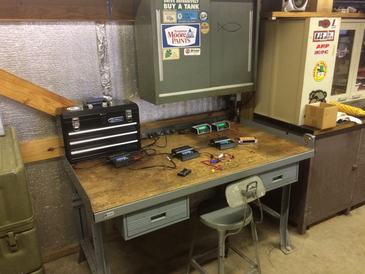

      Lipo batteries have improved drastically and can be safety charged at 2-3C, I charge at 2C on a fire proof table.
