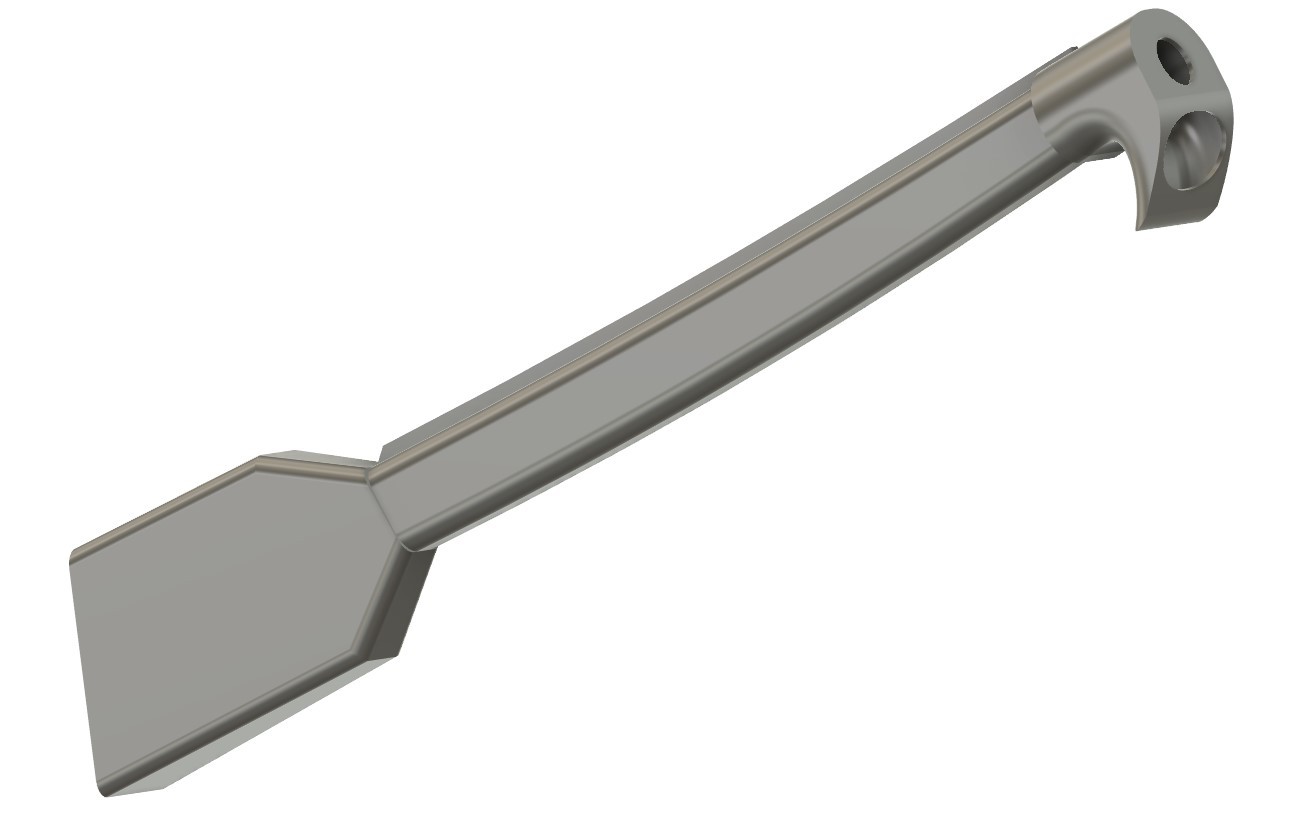

                        A replacement for the arrestor hook (static use only).

                          RG, I like it better than the one I struggled with weeks. Might add it instead !! Best, LB

                            RG, Just printed your Freewing F-4 Tail Hook Replacement Parts and these are beautiful. Thank you again for your work, just fantastic. Best, Steve
