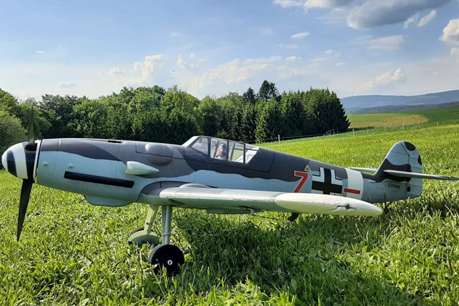

                From what I gather Dynam have recently largely fixed their previous retract gear with a more reliable design.
                I was kindly linked to this 3D print file the other day on a FB page to increase the forward rake.
                Helps mitigate the forward tipping and gives the bird a more historically accurate look.
