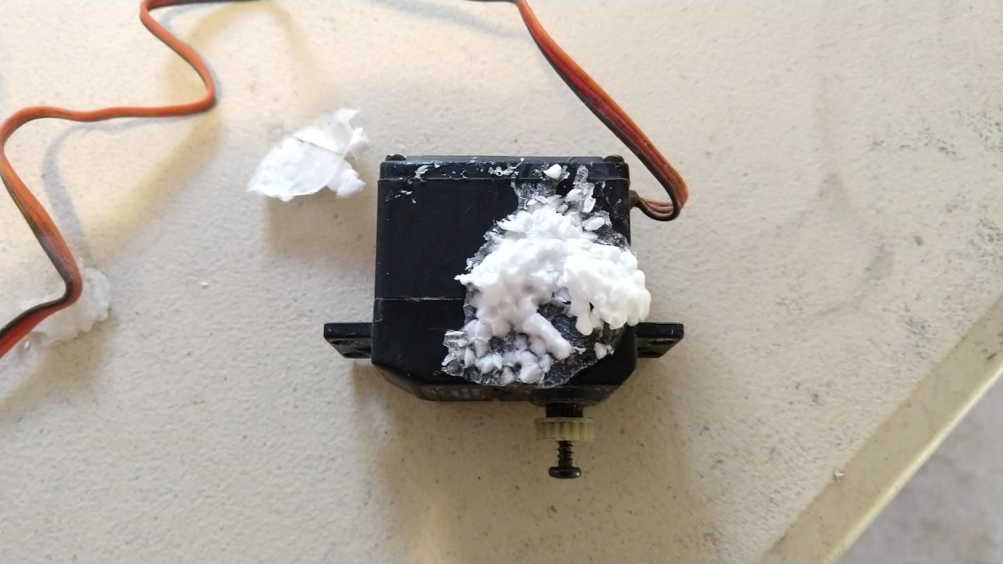

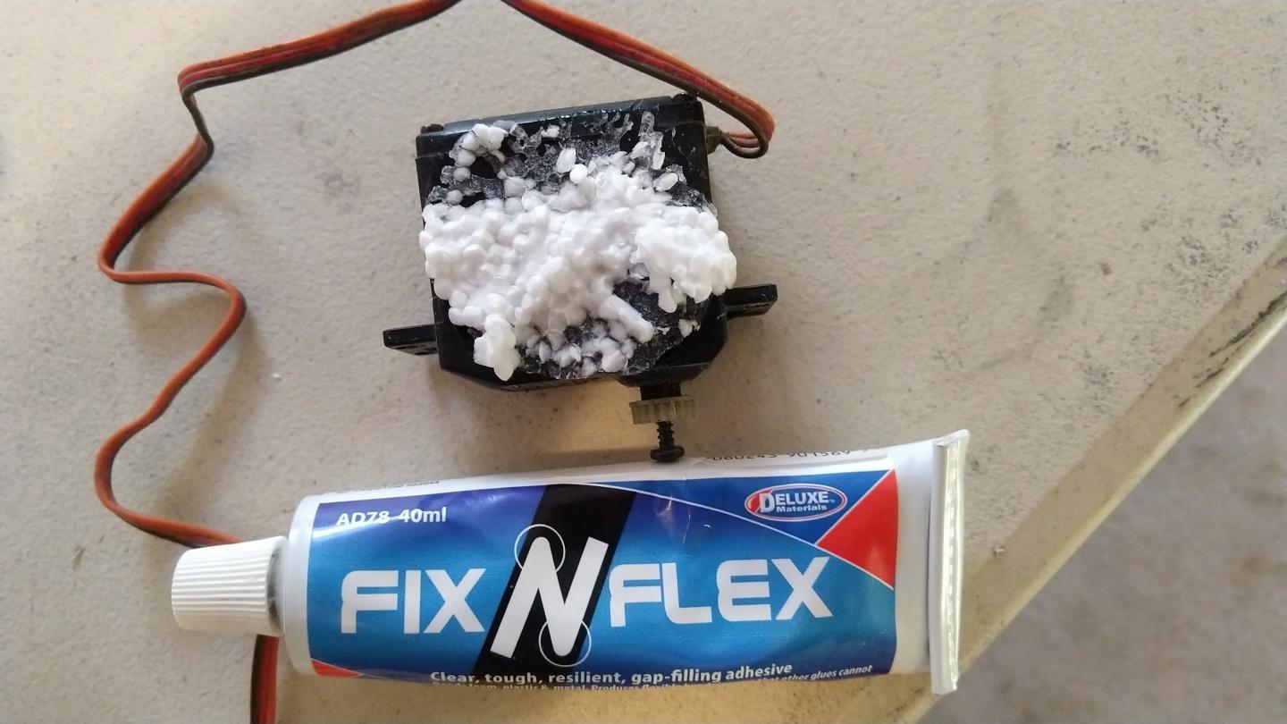

here is how well it sticks to plastic and foam. btw, I didn't even clean the servo. it has nitro fuel oil film and dirt on it still I just rubbed it off with a rag and no solvent. I had to twist the servo off. as you can see, it brought foam with it. it is able to be scrapped off the housing. it's a soft silicone like material. the only way foam tac is better, would be if it dries faster. because fix n flex does everything you need it to do. it also doesn't harm electronics. it's a perfect alternative.
the second attachment I scraped it off with my fingernail. to show that it is removable without harm to your servos. it's on there good but not too good. it's perfect. it's not some cheap junk, it's made for this stuff. and made in the UK. where they probably can't get foam tac.

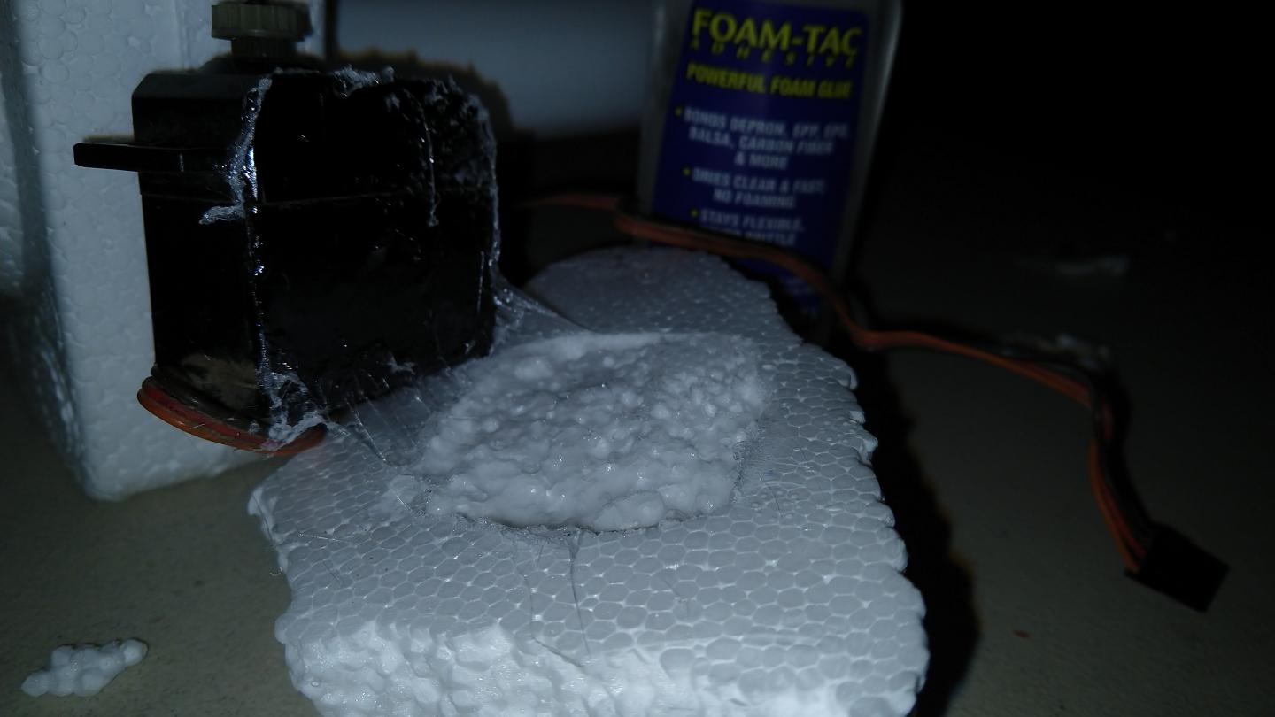

alright so i'm testing the foam tac. now i see why it can't be shipped via air. stuff is potent like paint or model glue. maybe this is why it will set up faster.
it's also a lot more runny. so you may have to tape parts in place. or use tape to keep if from dripping out all over other stuff.. the fix n flex is thick so it wont run or drip out. and holds the parts without tape. maybe not a servo but 2 foam pcs and maybe something lighter than a servo. this helps in mounting things to vertical surfaces.
edit, after about 10 mins the foam tac is melting the packing foam my plane came in. so it's not exactly a safe for all foam glue.Comment

It clearly states on the package...……...Depron, EPP, EPO
Packing foam is made from EPS (Expanded Polystyrene) which is the easiest to melt of any of the foams with solvents.
Most of the modern foam planes are made with EPO.
I'll lay a wager that packing foam will melt with your favorite new glue too

that's the same foam I used to test fix n flex with and it did not melt it. the only glue that did melt it between foam tac, bob smith industries foam cure, zap foam safe ca and fix n flex was foam tac.
