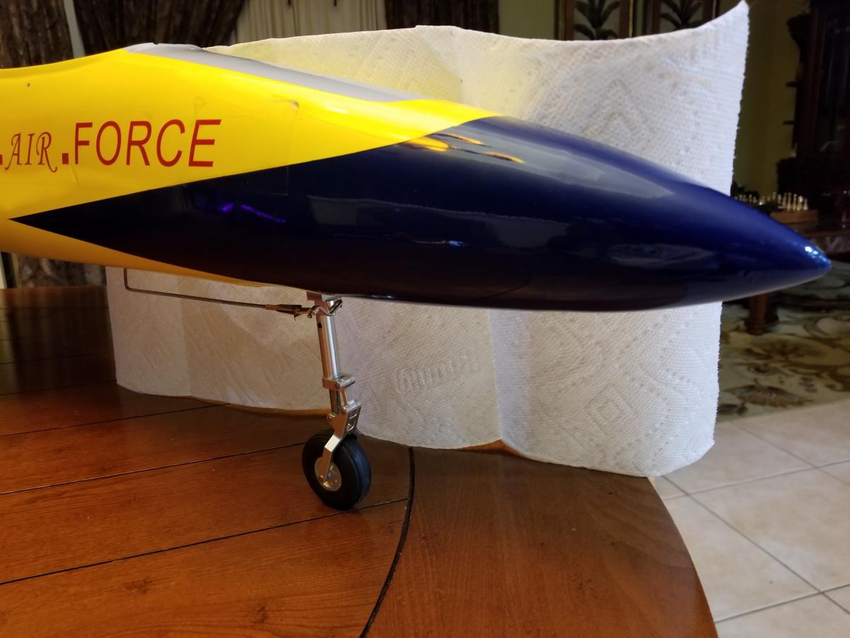

            • #7

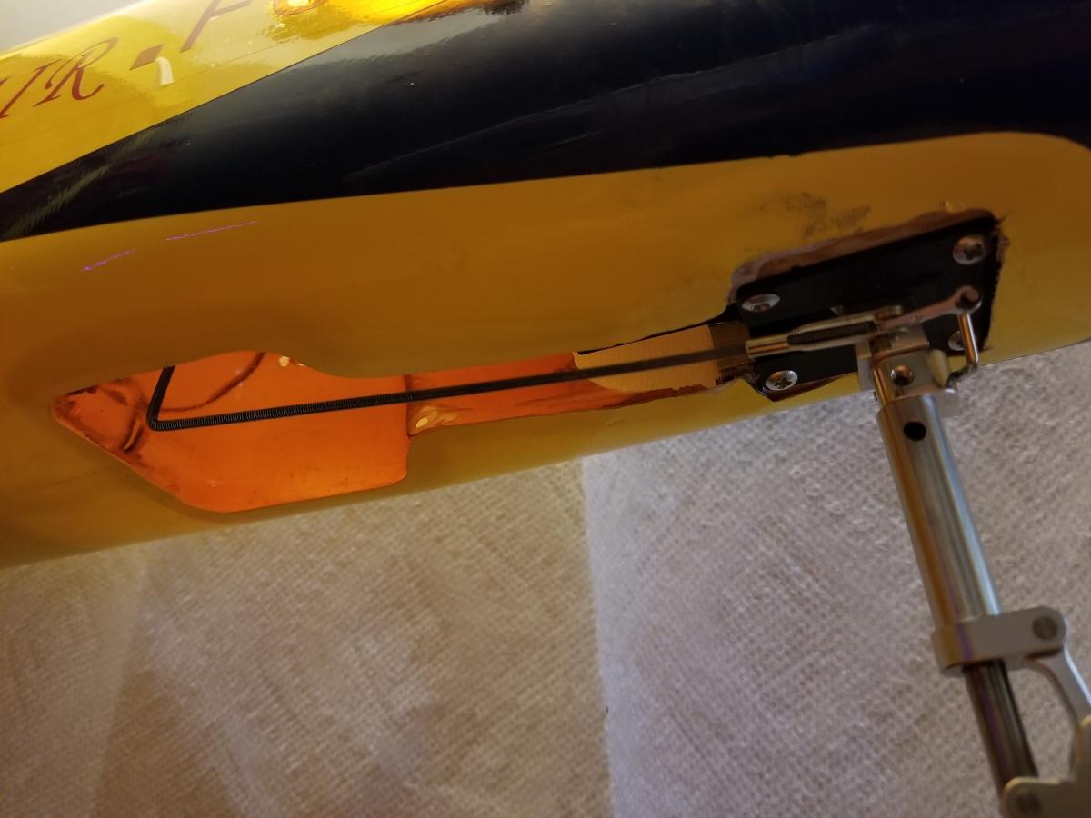

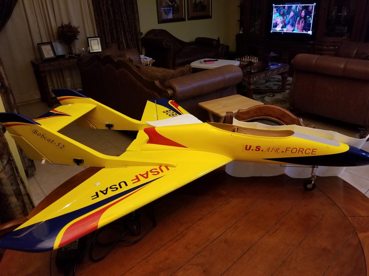

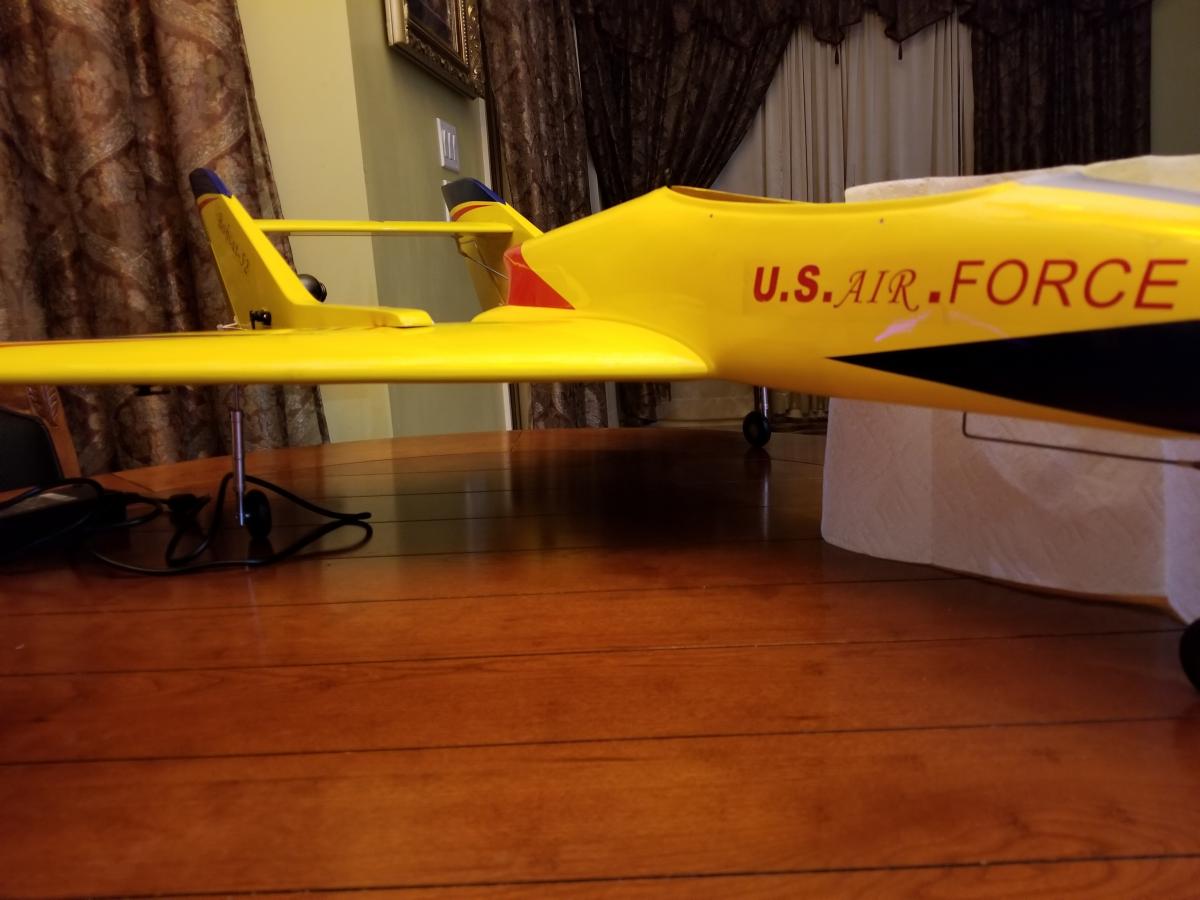

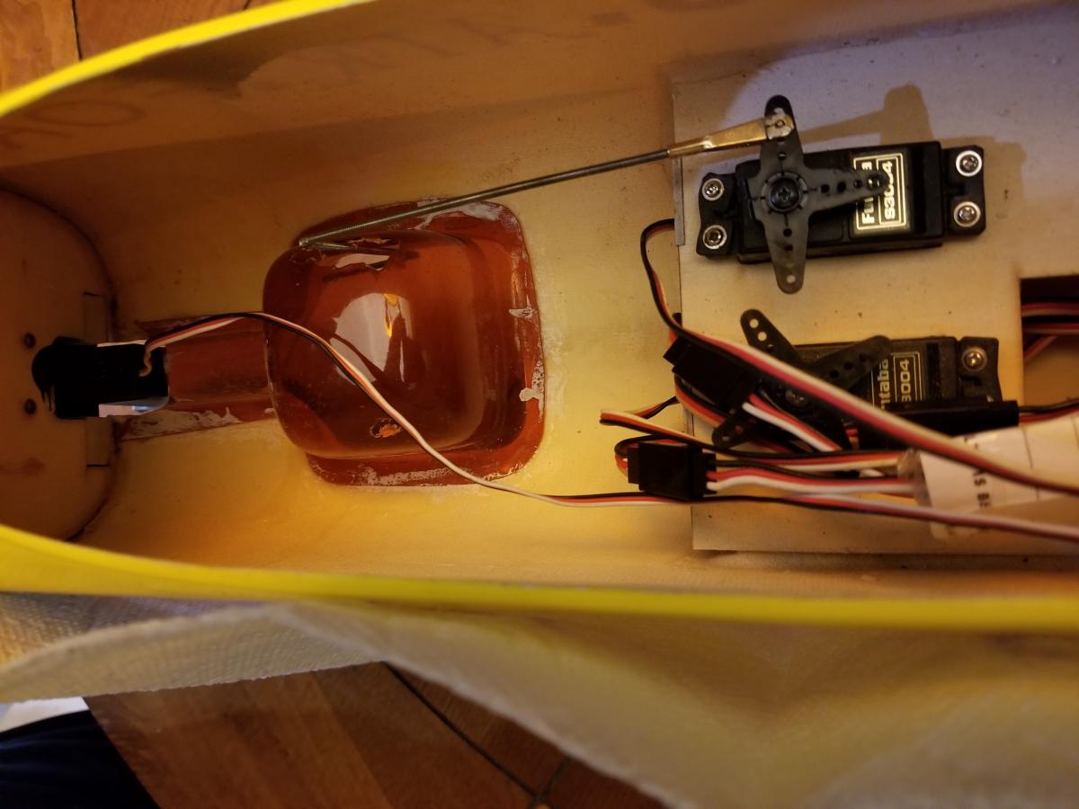

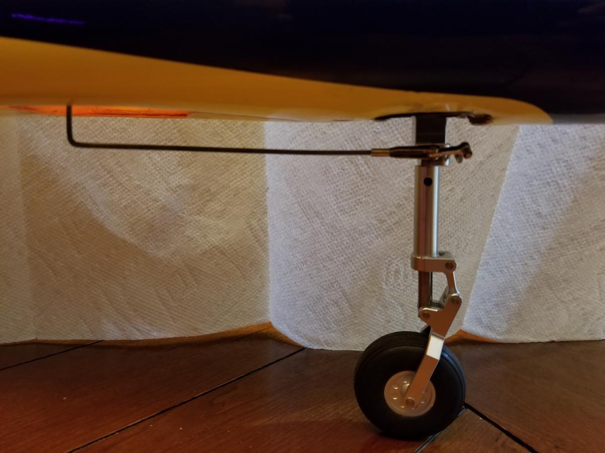

              Let me know if you received the photo. Click image for larger version
ID:	236438Click image for larger version
ID:	236445Click image for larger version
ID:	236446Click image for larger version
ID:	236447Click image for larger version
ID:	236440Click image for larger version
ID:	236441Click image for larger version
ID:	236442Click image for larger version
ID:	236443Click image for larger version
ID:	236444Click image for larger version
              • #8
                I did the best I could with the photo! Sorry!
                • #9
                  Photos worked. That steering arm appears to be the type that comes stock with Taft planes.
