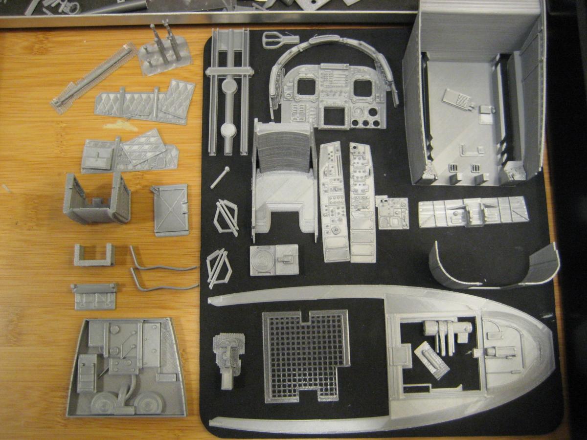

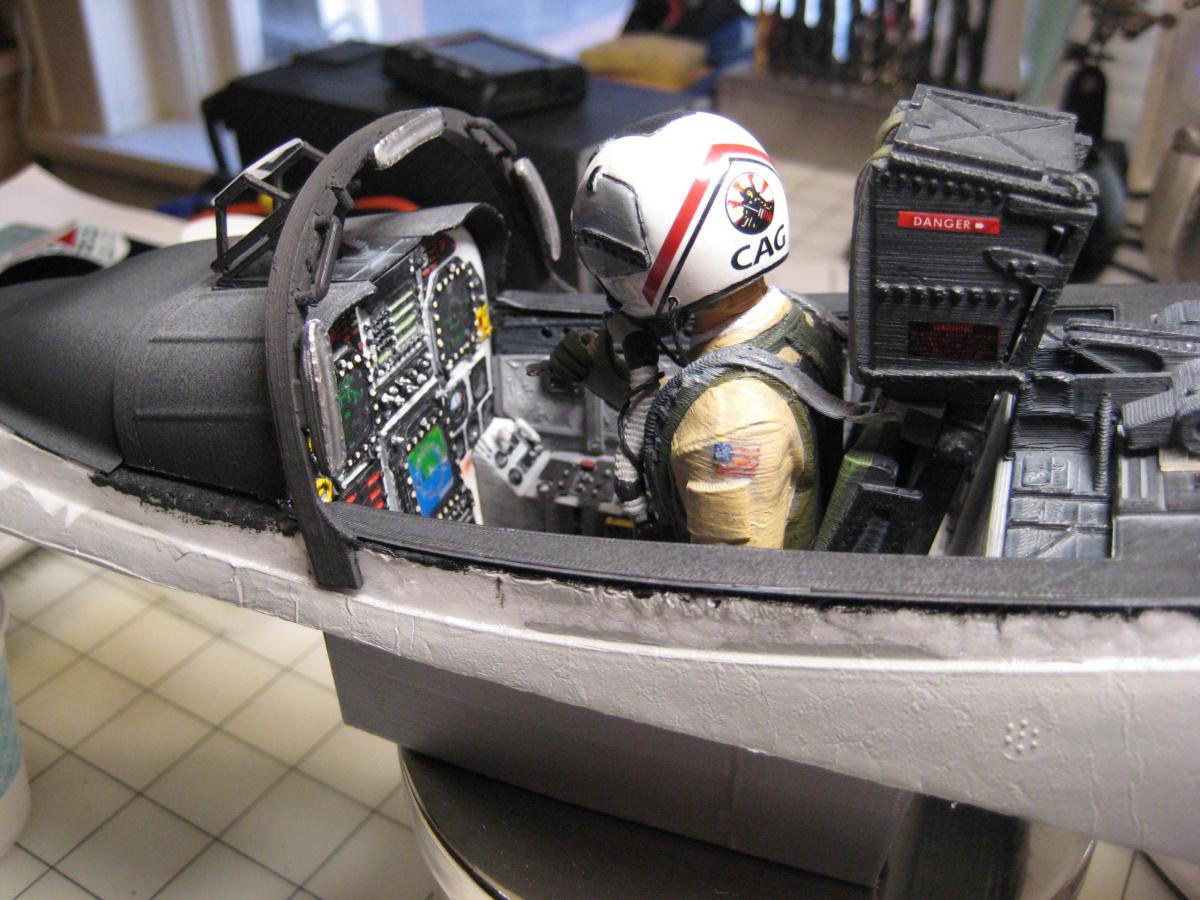

      Warthog, I trust I am not adding content unnecessarily. You're asking all the right questions. I have been 3DP printing for about 2 years and I started from zero knowledge. The great news for you is many guys and gals are getting involved and actual printer setups are becoming much simpler. To respond to your question about SLA (resin/laser/dipping) vs FDM (plastic filament layering) I am in the the filament camp. SLA is great for small highly detailed parts with complex designs though the clean up and curing of parts can slow down your production and even limit some designs in size which will increase part count. Filament layering printing is the most common and is economical, quick in comparison, and versatile in that you can alter designs quickly while prototyping a part. I have designed many detailed parts for my RC aircraft projects with very limited CAD skills using TinkerCAD, Fusion 360, Meshmixer and Prusa PE slicer. I own a Prusa i3 Mk3. The picture below is for my Freewing F-18C Hornet and are parts for the single seat cockpit. I did not design the Pilot's body, but I did resize it, mod it, and print it. The downside was the delivery time for my Prusa even 2 years ago which was 3 months. Research is your best tool when beginning, but it sounds as if you have a great skill set already. I look forward to reading about your choices. Best, LB

        Best wishes! Nice looking bike, that is impressive!

          That is ONE GOOD LOOKING cockpit!!! I went to Thingiverse to sign up, but the are down right now. Still checking out machines.

              Gringotuerto and Warthog, WH, kind words indeed, it was a love/hate project once I jumped in on it, but the results were worth the time & effort in the end. GT you nailed it with your thoughts on "Support". That is the Key to 'happy printing' IMHO. I can only speak from my experience and thus far, Prusa has simply been outstanding. In terms of 'community' I get most of advice from the blogs on Prusa.com and watchng their uutoob vids which are pretty good as well. Firmware updates are frequent and can make such a difference in your printing. Prusa also supports their own Slicer (Prusa PE) and when combined with the firmware updates work wonders in improving my lack of design skills. I have not heard any 'bad things' about either Creality or Prusa in the 2 1/2 years I've been researching products and techniques.
