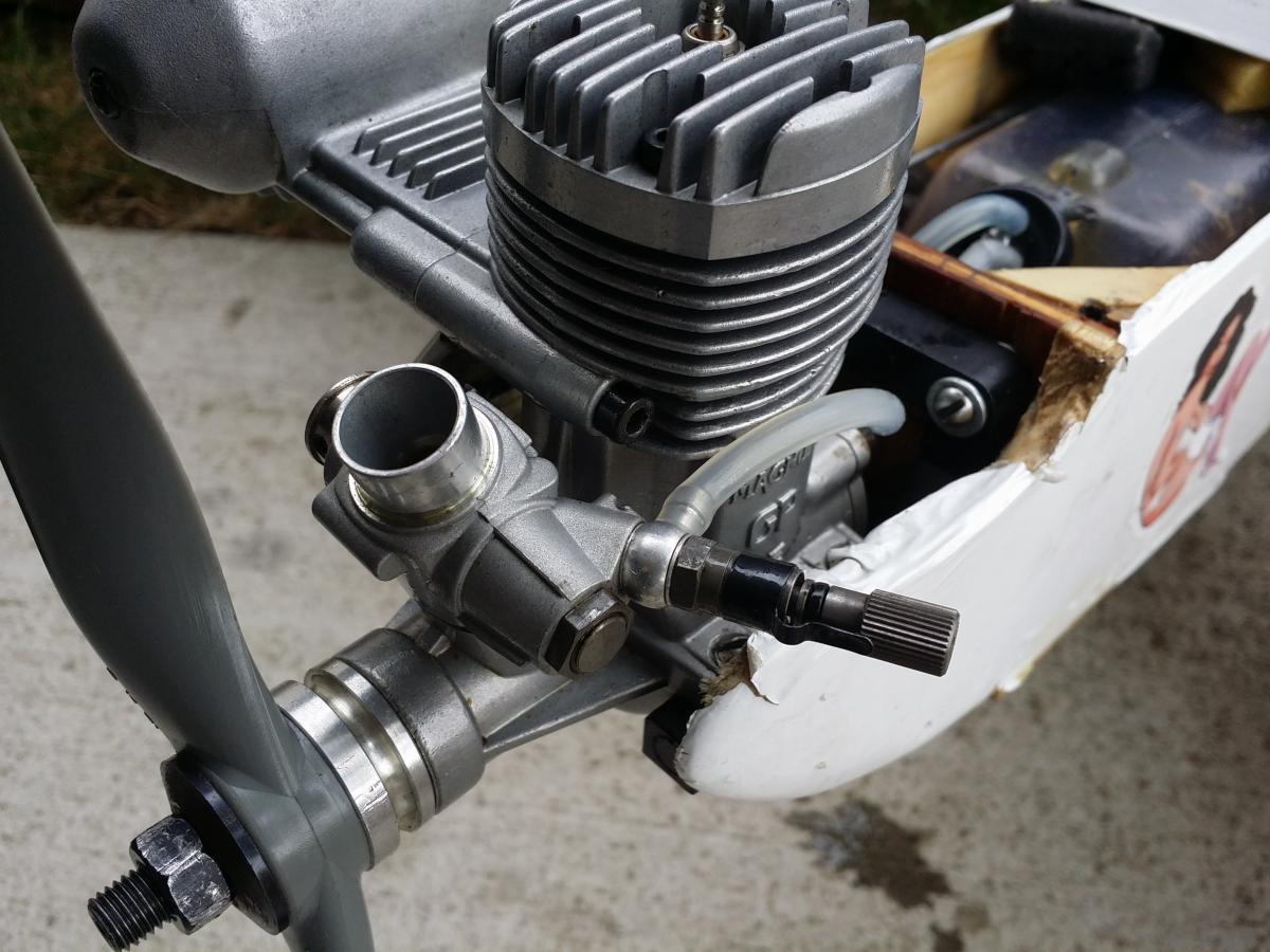

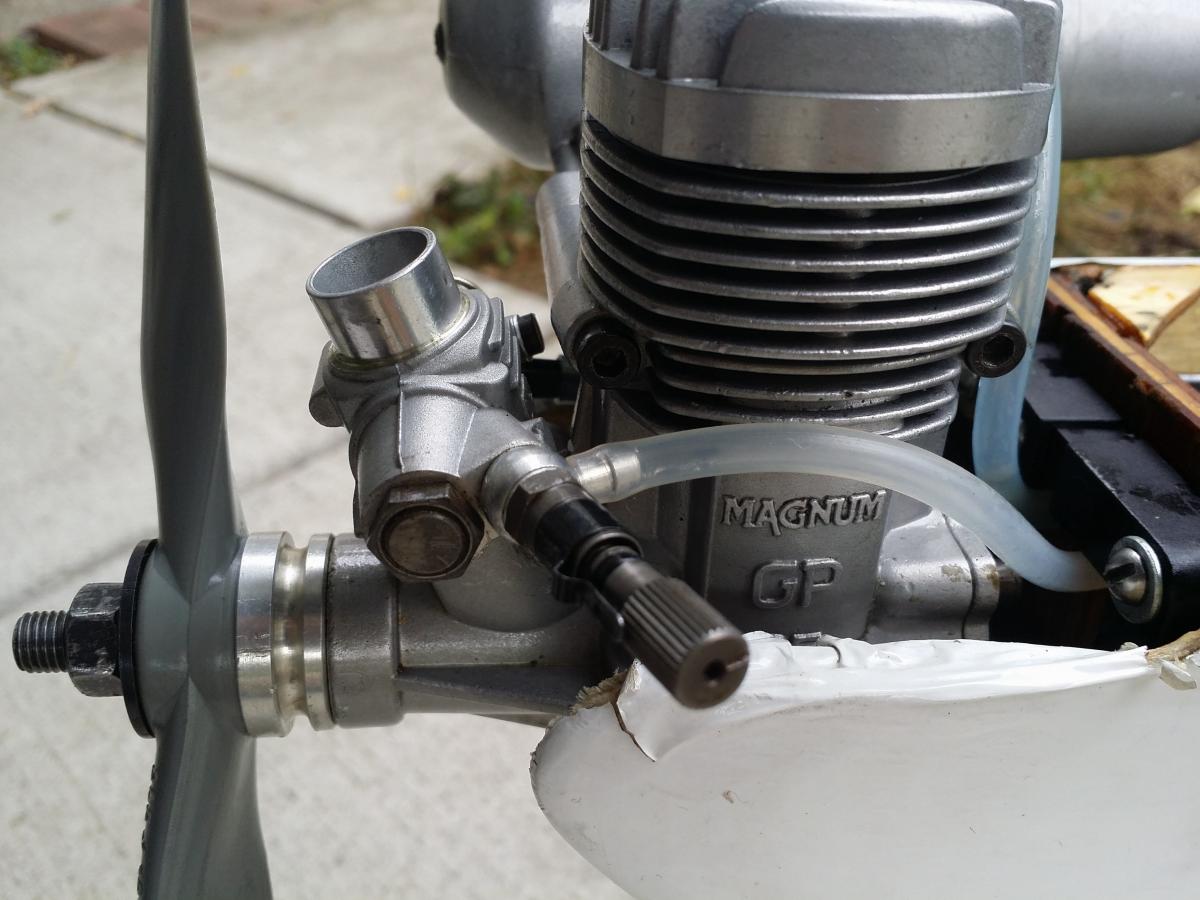

Got this Magnum GP .65, idles perfect, until all fuel runs out, best idle of all engines.
The problem I am having is during transition and at WOT the engine runs extremely rich/ gurgling and takes a few seconds to finally clear out and then somehow get a good top end. :Confused:
The strangest thing is the needle is completely closed (CC), even swap needles from a O.S. / K&B / and a Magnum XL, and still does the same problem.
Is there something I need to re-adjust on the carb so the needle leans the mid-range and top end?
