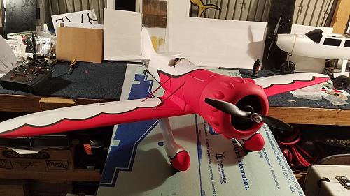

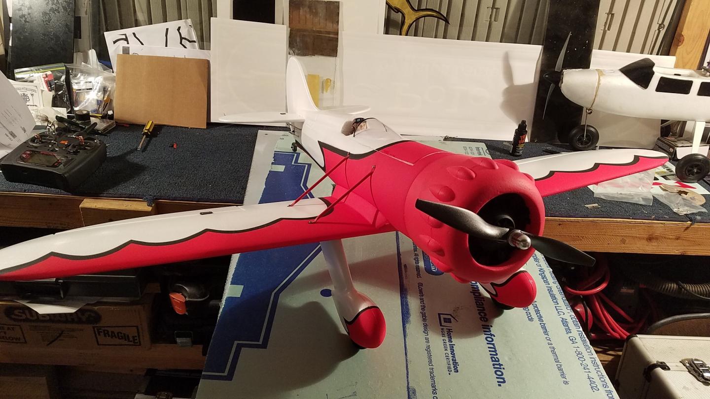

            Santa was very kind! Click image for larger version
ID:	110470 Assembled and ready for range test and maiden.
