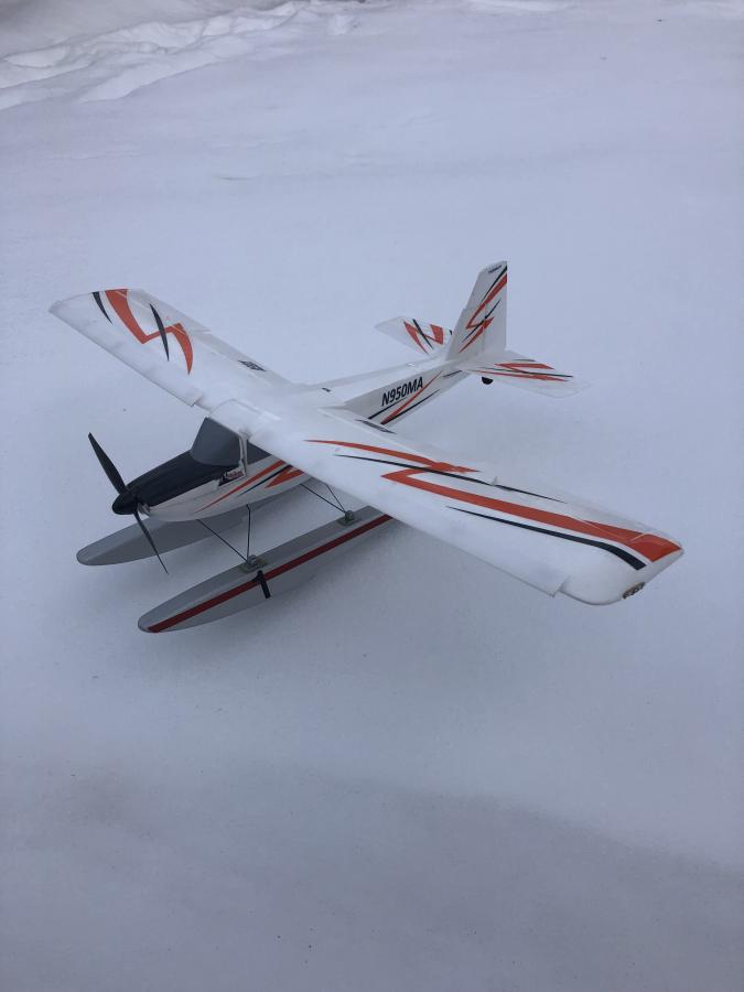

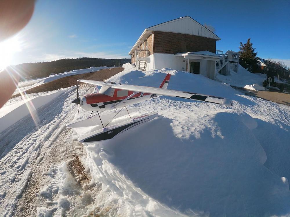

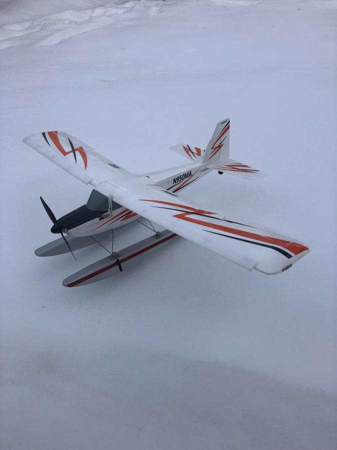

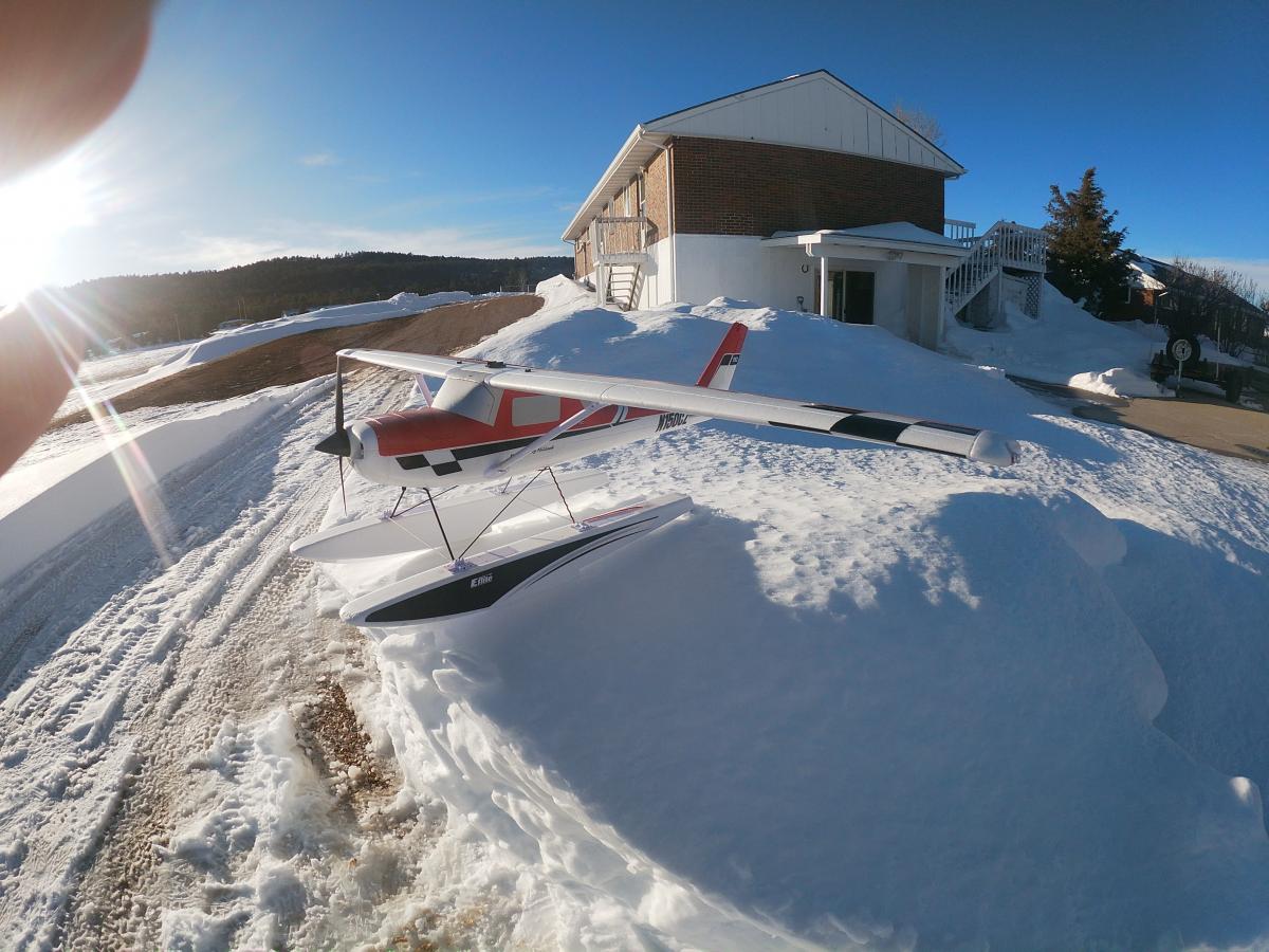

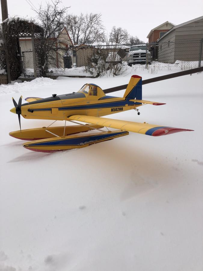

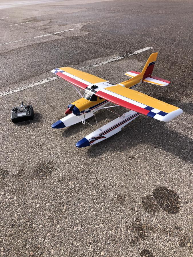

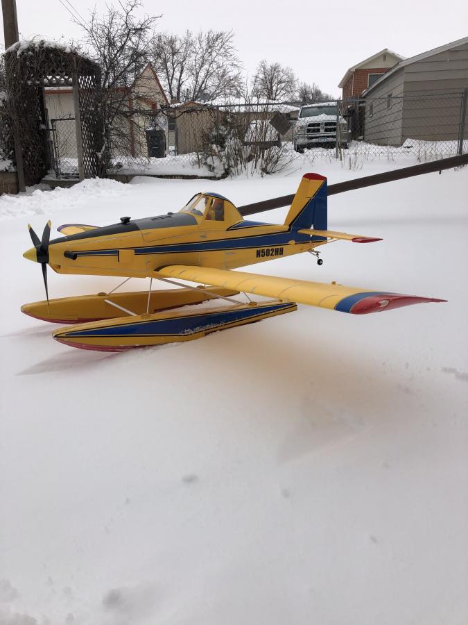

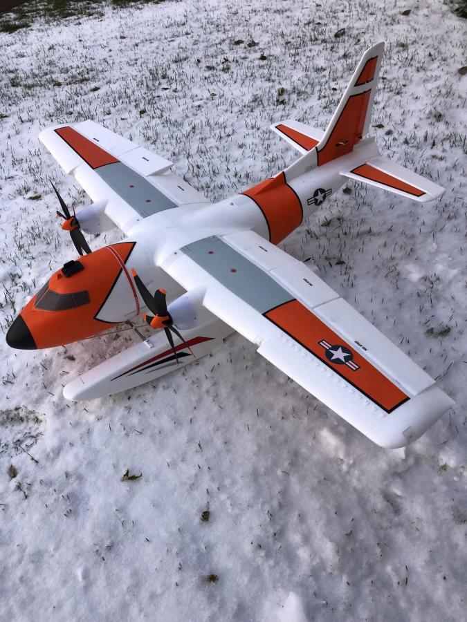

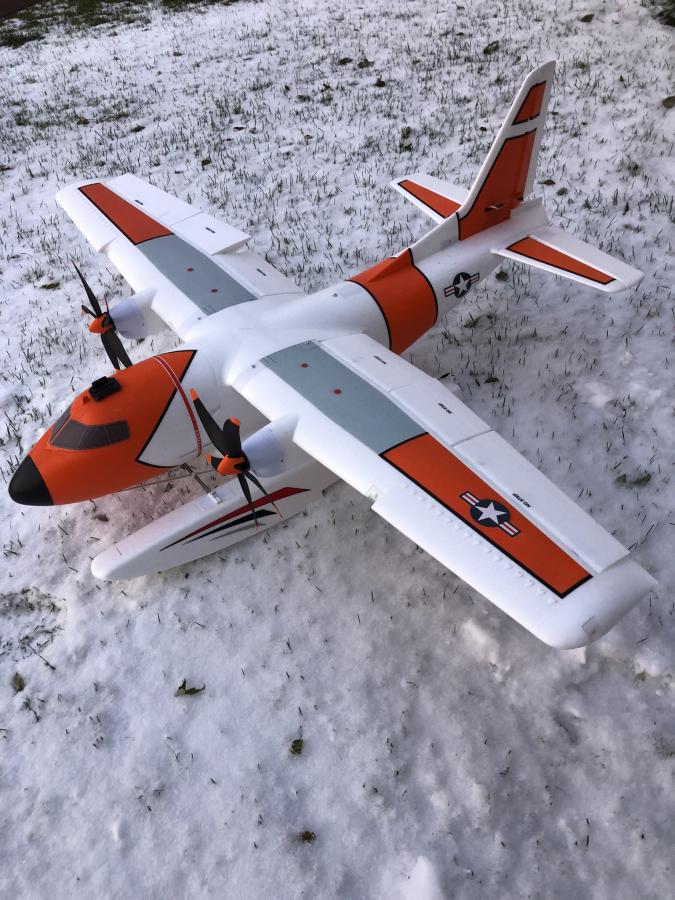

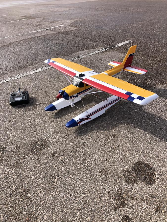

                                        The snow must be fairly crusty. If it's soft, I've found skis don't work well. Due to the slight down thrust of most RC motors, when you try to get the plane moving, the nose gets pulled into the soft snow and you bury the prop. I've even tried skis with my twin SkyMule, which is a high wing. The nose ski just gets sucked into the snow and it becomes a snow thrower. I don't do skis anymore in winter, electing instead, to go with belly skidders or planes with large tires like the BushMule and even with the BM, the snow needs to be harder or packed.
                                        I'm sure you can do it with skis in soft snow, but they'd have to be somewhat over-sized so they don't sink.
                                        FLOAT's.This is the Only Way to fly off Deep soft Snow, even if it is deep powder. I have 5 Planes I fly with floats that never come off no matter whether it is lakes in warm months, or snow in the Cold Winter months. E-1500, 2.1m Carbon Z Cessna 150, Air Tractor, Mini Turbo Timber, and a FMS Ranger one other mini Timber and the 1.5 Timber Try this you may like it LOL!!!! video 150 Cessna https://www.youtube.com/watch?v=A-Pmji_QrME .
                                        Here is a Video of the E-Flite Air Tractor on snow https://www.youtube.com/watch?v=A-Pmji_QrME
