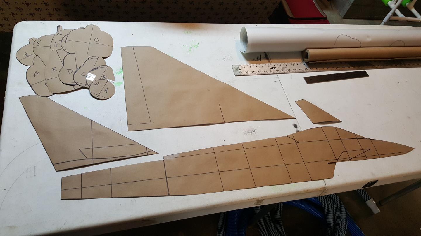

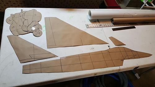

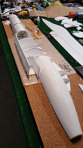

    The indoor circuit is where it is at for us right now due to the weather and because of my love of EDF's I wanted a jet to fly indoors. I looked around on YouTube and found some video of scratch built Eurofighters made from Depron.

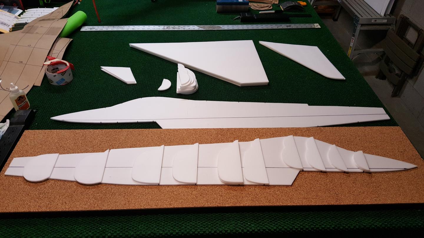

    I had a bear of a time finding any significant information about them. What motor(s), ESC's, batteries, props, etc. Could not find any plans either. So, I decided to just make it up as I went. Started with a drawing of a Eurofighter I found on line that included cross sections of the fuselage. I enlarged it with a projector to roughly the size I wanted. Ended up being 46" long with a 34" WS.
    Click image for larger version  Name:	20180125_185747.jpg Views:	1 Size:	109.1 KB ID:	115999

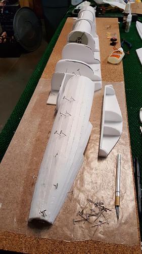

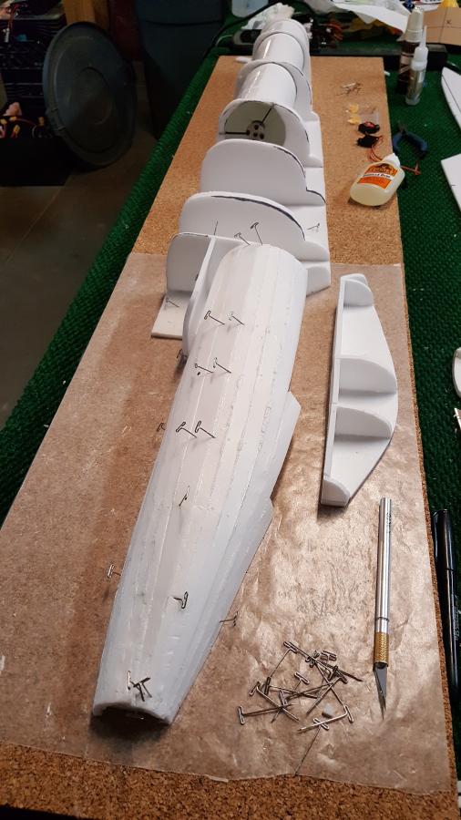

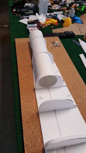

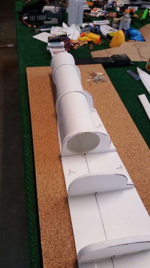

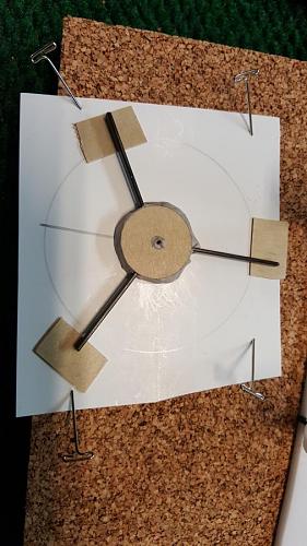

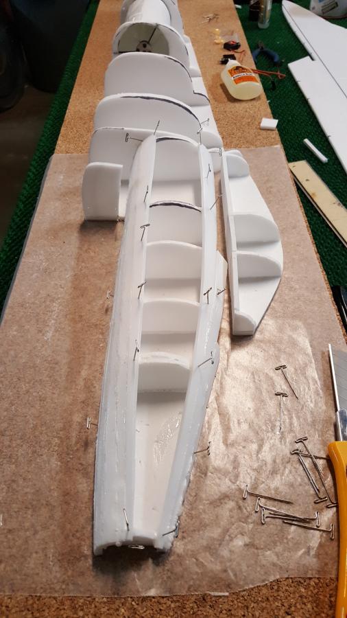

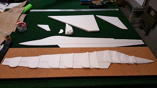

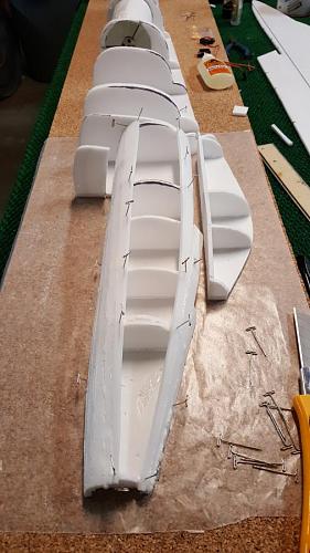

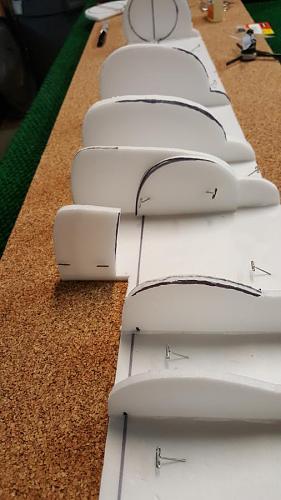

    Once I got my templates made I picked up some Dollar Tree Foam board and Gorilla Glue. I decided to make it a twin with 1507 4100kV motors spinning Racekraft 3076 3-blade props. It will have elevons and thrust vectoring like the one in the video. So far I am working on the starboard half of the fuse and started sheeting it this evening. Until a new Freewing offering comes out that I must have, this is what I am working on.
    Click image for larger version  Name:	20180126_220807.jpg Views:	1 Size:	166.7 KB ID:	116000
    Click image for larger version  Name:	20180131_185103.jpg Views:	1 Size:	71.2 KB ID:	116001
    Click image for larger version  Name:	20180202_205812.jpg Views:	1 Size:	56.0 KB ID:	116002
    Click image for larger version  Name:	20180203_094510.jpg Views:	1 Size:	57.5 KB ID:	116003
    Click image for larger version  Name:	20180203_164128.jpg Views:	1 Size:	76.1 KB ID:	116004
    Click image for larger version  Name:	20180204_201114.jpg Views:	1 Size:	68.6 KB ID:	116005
    I figure the first side will be the hardest but form a pattern to duplicate the other. Never worked much with Depron before so this is all new to me. Once covered I will sand it smooth and fill any major defects with lightweight spackle. More to come.

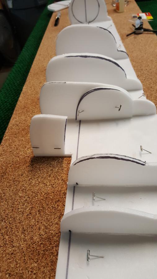

                    Couldn't spend much time on it tonight but the nose is sheeted.

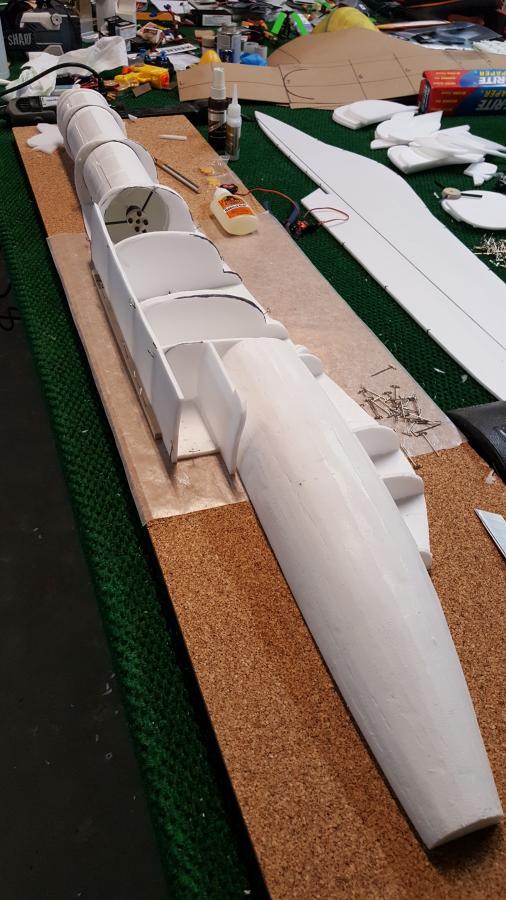

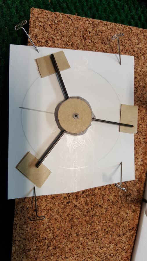

                                        Just keep building... just keep building.... what do we do? We build. A little more progress. Gave the nose a quick sanding and added a bit of the bottom. A little progress is better than none.
