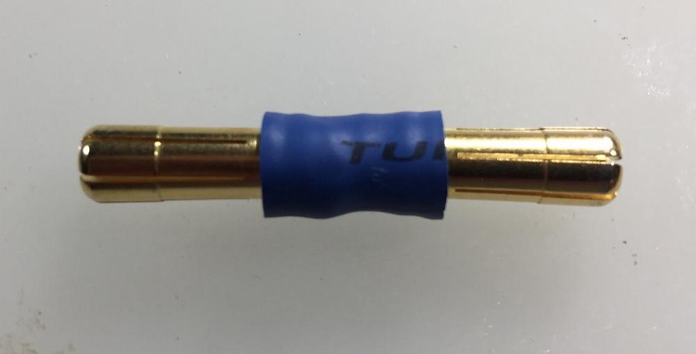

                    One thing to avoid on any model you’ll run batteries in either parallel or series is making battery connections to the esc too long. My solution is to now make simple plug connectors to join wires together. The attached picture is a plug that will join two 6s batteries together for my 12s PC-6. When you read the manual for aftermarket esc’s they normally list a maximum wire length from battery to esc! Making plugs instead of wire harness’s ensures you’ll keep the lengths down to a minimum.

                      Short plug parallel Y
                      They are available in parallel or series.
                      Part of the choice of how you do it is making the wires not turn into a pile of spaghetti that wont let you close the hatch.
                      The long wire lead issue is serious. I'm surprised at the length of wire between battery and ESC in the FW Tomcat without big capacitors added. VERY LONG wires. It is FAR better to have the extensions between ESC and motor than between ESC and battery. So in modifying the Tomcat to Castle ESCs, I put extensions between ESC and motor and cut the length between ESC and battery in half.
                      And this is why I want high C small packs in the big Me262 right at the EDFs. Long wire run to put the main packs in the fuselage and the ESCs are built into the EDFs I have for it. 2000 mah 50C+ at each EDF and 15,000mah (20C would be enough) in the fuselage. The high C packs will take about the same room as the capacitors I'd need.
                        Yeah that is one thing I wish to avoid. I don't want the inside to look on the inside like it's hooked to an EKG. I will probably be going eith those adaptor style plugs to keep things tighty.
