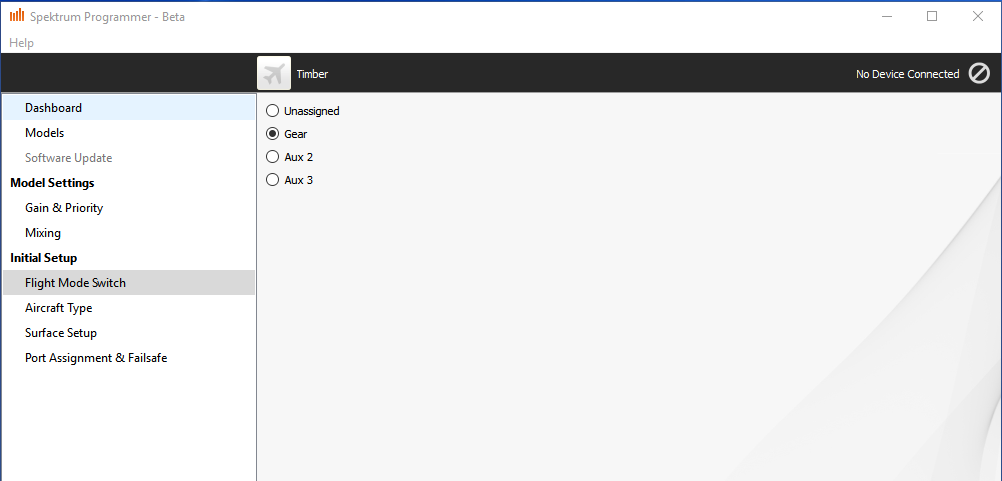

          • davecee
            • 179
            • Nashville, NC
            Here is the flight Mode switch screen from my Spektrum programmer. You can assign it to different switches. Click image for larger version
