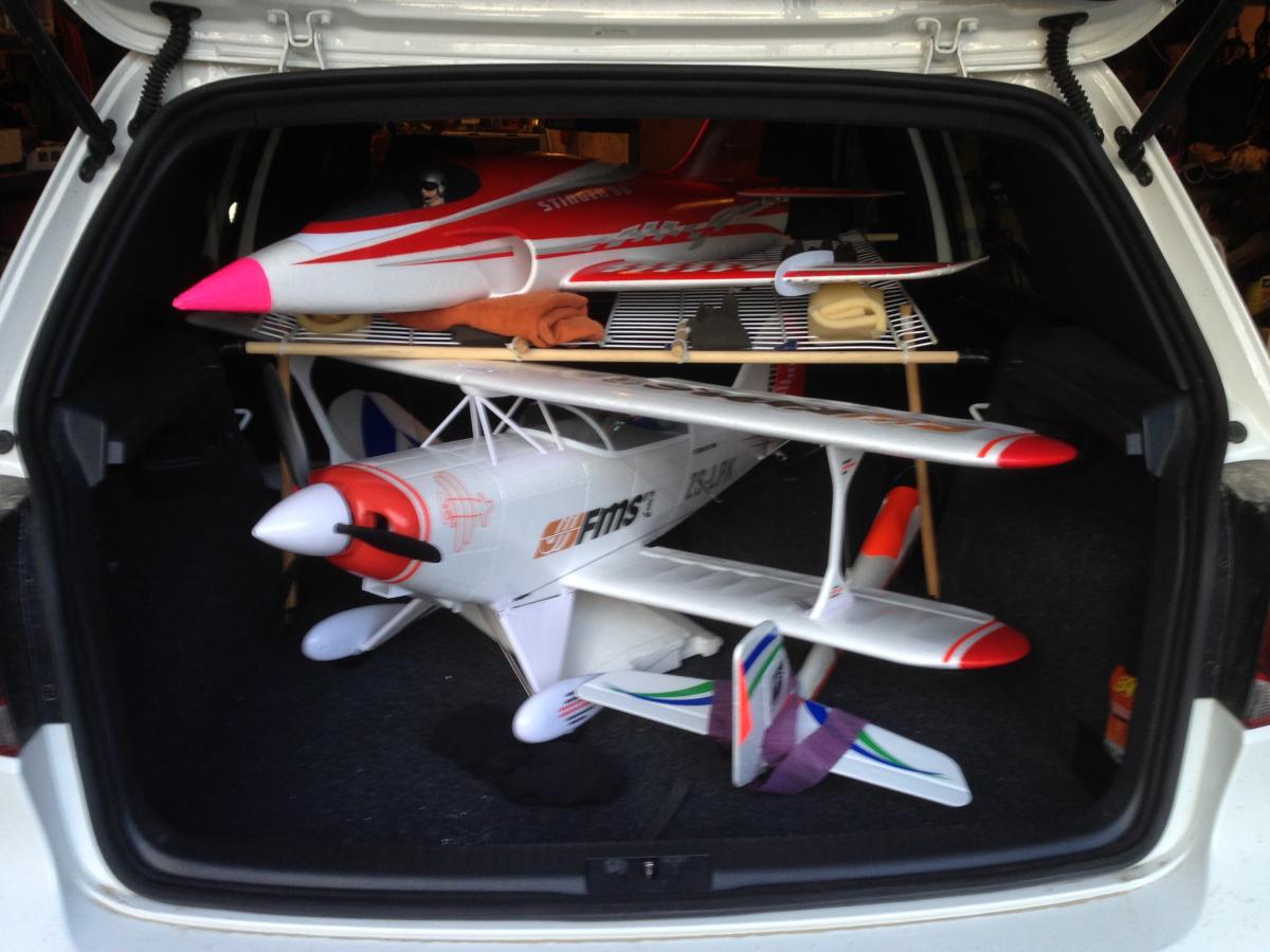

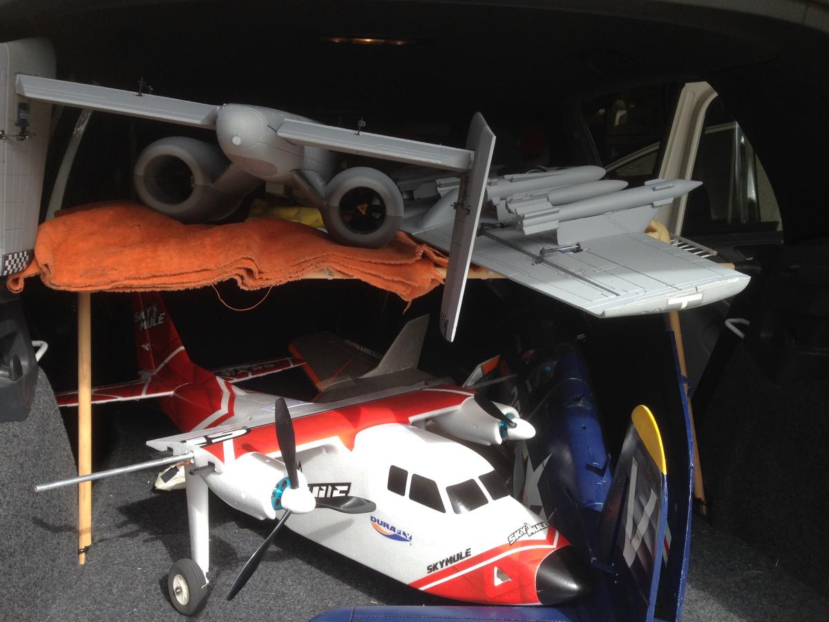

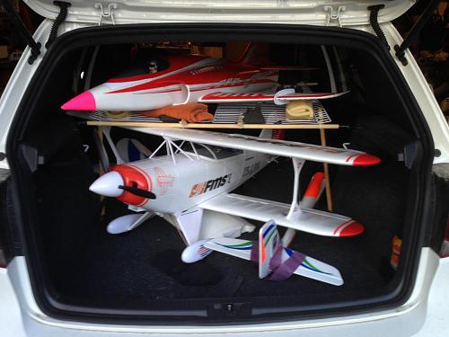

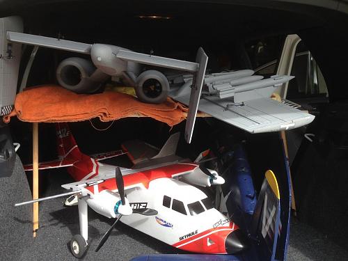

    Why just jets? All large planes will have the same problem. I de-wing my large planes and store them by hanging them from the ceiling of the garage and the basement and one back room in the house. In the car, I have a second rack built in to carry 2 layers of planes.
    Click image for larger version  Name:	IMG_2037.JPG Views:	1 Size:	112.1 KB ID:	149424
    Large planes? No problem.
    Click image for larger version  Name:	IMG_2044.JPG Views:	1 Size:	105.8 KB ID:	149425
    This is in a little Golf. If I had a truck, I'd double my load to the field. As is, the top photo has 4 planes in it and a big 10 foot sailplane is about to put in after the photo was taken and I can put another small plane in the front passenger seat.

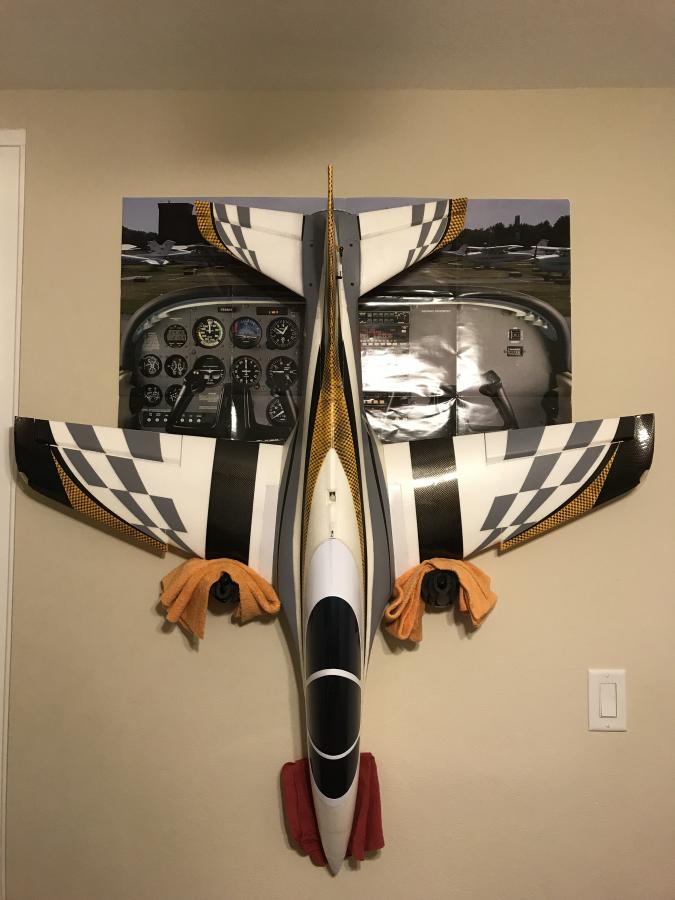

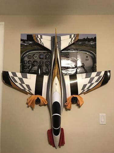

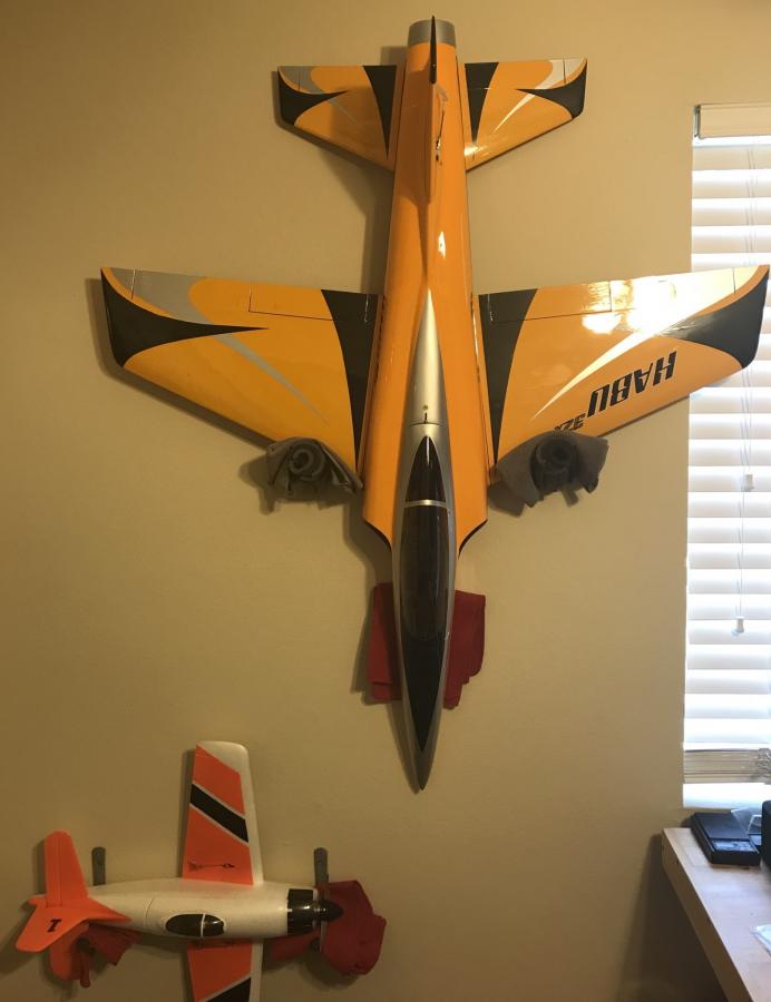

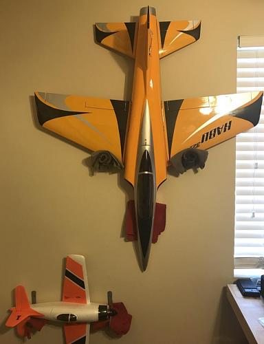

      I tend to store most planes with the wings attached and on hangers that cradles each wing. If I store a plane without the wings, I use a hanger with longer arms where one arm supports near the nose and the other supports near the tail.
      I purchased the hangers front Home Depot, but they are likely found at other hardware stores possibly under a different brand than the brand that Home Depot sells. At least I believe I’ve seen them elsewhere and they looked identical, with the exception of the branding. Regardless of the hanger I used below, I used PVC pipe insulation foam covers for padding AND folded up microfiber towels. The foam just simply was not enough for most of the foam jets I own, as they eventually got dented from the weight of itself on the hanger and it imprinted the hangers metal outline into the foam wings. The microfibers have thankfully solved that easily since I had a lot of microfiber towels around.

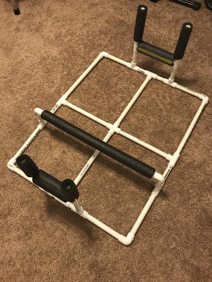

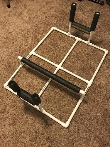

      To transport to and from the flying field, mine just lay flat in the car (the rear seats fold completely flat so there are no bumps/ridges). I use moving blankets folded quite a few times to help absorb the vibration during the drive. The only plane I don’t lay flat in the car is the Freewing 80mm EDF A-10. I built a PVC stand for it to fit perfect and secure (and it makes for a nice assembly stand when at the field). The look of the A-10 stand was Bill’’s idea that he shared on RCgroups, and I modified the specs. of the cradle to suit my needs (thanks again Bill).

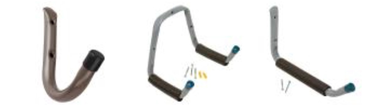

      Below are the three different design hangers by Everbuilt:
      1. The first one I use for most of my planes, as it doesn’’t take up much room and is still sturdy. Two are needed, one for each wing to sit on and can be spaced how you would like.
      https://www.homedepot.com/p/Everbilt...1209/202305424
      2. The second one is nice since it’s just one whole piece. However, it cannot be expanded, so you would need to make sure the wings and fuselage dimensions would fit. It also takes up a bit more room, but is a great hanger.
      https://www.homedepot.com/p/Everbilt...8044/202305549

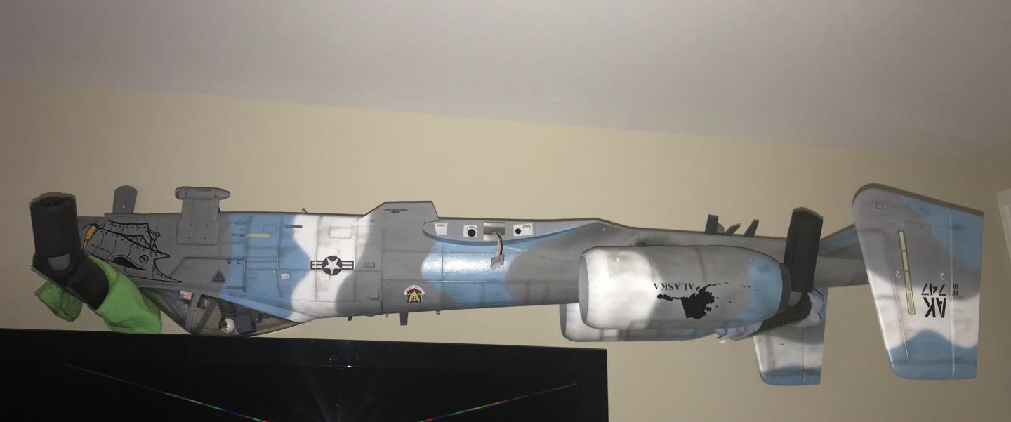

      3. The third kind is a large hanger but works great for the A-10 without the wings on to hold the fuselage horizontally. It is just a single arm, so two can be purchased and may be spaced as needed to fit the plane you’’’re wanting to store it on like the A-10
      https://www.homedepot.com/p/Everbilt...8042/202305548
      The pictures below show two of those three types of hangers (I don’t tend to use the second type anymore since it’’s a one piece design and I prefer separate hanger arms). The first type in the first link above, the small hanger, is what’’s used to hold the Avanti, Habu 32X, and the little Funfighter Rarebear in the picture. The hanger arms used to hold the A-10 was the third type in the third link.

        Below is the link to Bill’s blog post regarding his PVC A-10 stand:
        https://www.rcgroups.com/forums/show...67&postcount=5
